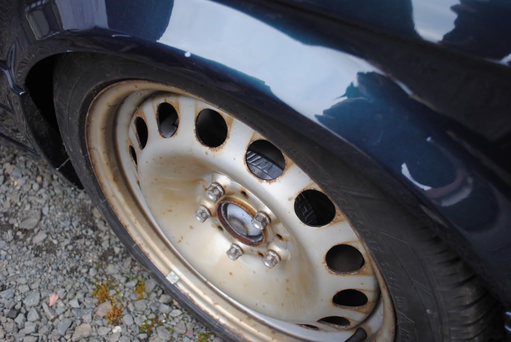

    so, I thought the first thing that needs to be done is the crappy 5 lug wheel sitting incorrectly needs to be fixed- I want to have alot of brake and ZERO tire rubbing. Well here are a few things I collected up over the winter for the car.

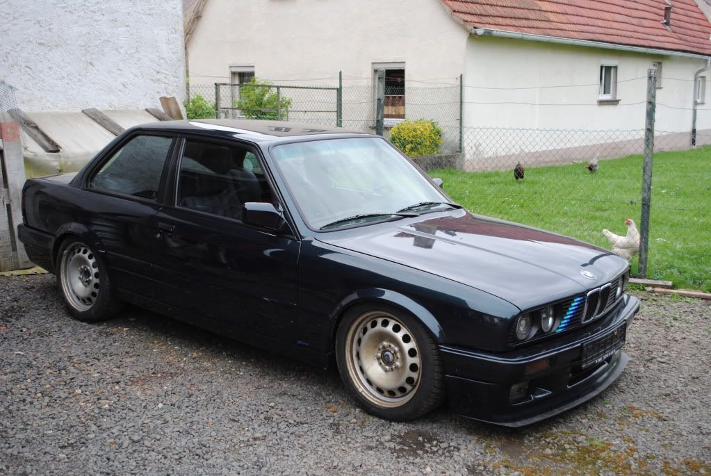

    pulled it out of the barn looking like this--
    It's a 2.7 with an Alpina/schrick 268, hartge headers, IE oversized valves, and a bit of port/polish done on the head, and Alpina ECU, 3,91 visco....everything is poly, or new BMW rubber.

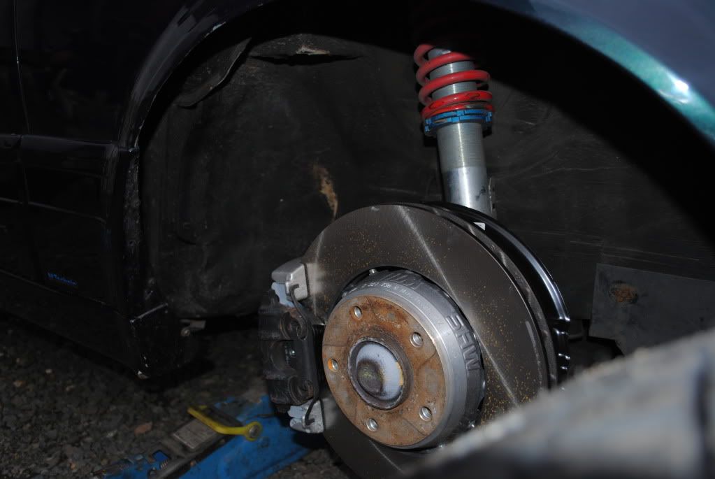

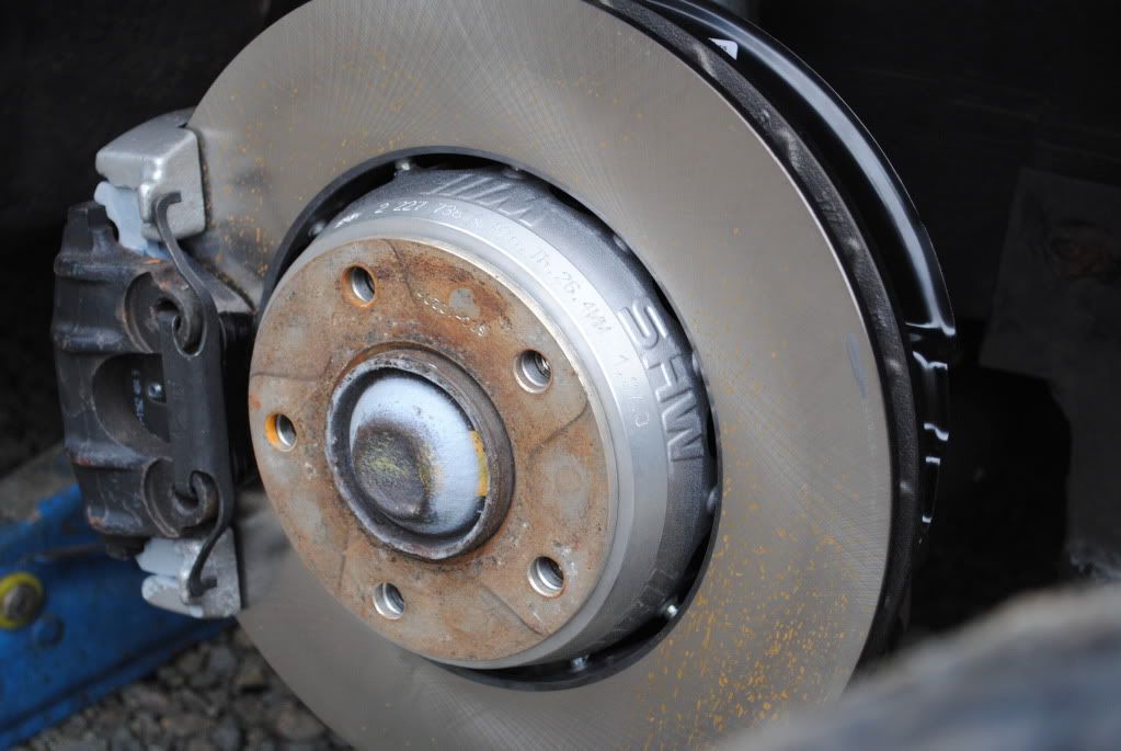

    put the M coupe rotors and knuckles on it
    what's peaking out there?
    the cheapy coilovers

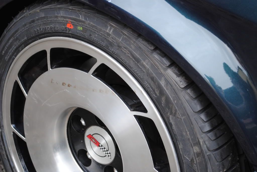

    have had these wheels for a bit now (all 4 are the 8.5", thought they would be the perfect offset-- nope, need spacers for the coilovers. still need to refinish the wheels though.
    and on the car, yes, the rear is for the other side front- want to see what kind of tire I can squeeze under the rear-- but it seems 16" doesn't offer much............. so it seems it will be 225/40/16 for all four corners.

        personally, i like the vette wheels, the steelies are 7" wide and et47, and the 2 piece style 5s were also too narrow at 7,5" with 205 tires

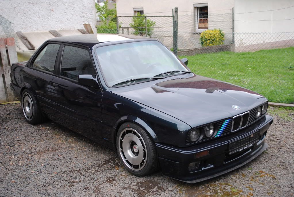

        I don't understand how a set of 80s turbine wheels on a euro car would have anything to do with "rice" or buying a VW for that matter.
        just wait until the wheels are painted and done up in the 80s DTM retro style.

          The vette wheels don't look too bad. They also offer a brake cooling affect if they are put on properly.

                Wow, that looks great, Mike! Wheels work so much better with the mtech II kit, than stock body.
