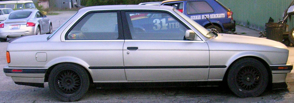

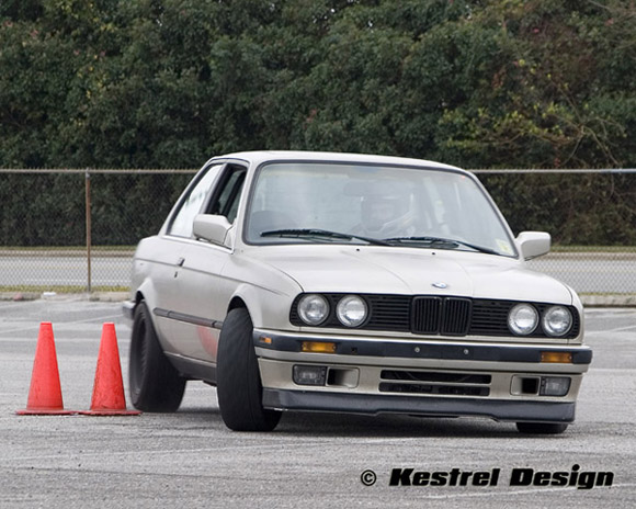

    autocross pic
    od1 332i fully built engine, h&r cupkit,15x7 basketwaves

    damn...looks cool so far. what are those wheels? are they the weaves in black? post more pics. welcome to r3v

      That's pretty sweet looking. Definitely have the business thing going on.

              doesn't look like weaves to me in that picture.

                  i guess they were weaves:P

                    Damn, that's an awesome pic!
                    • Brew
                      • 3060
                      Holy fucking sleeper. That thing must really move.
                      Have you had it dynoed?
                      What's "fully built" about it?
                      Your car is basically what I'm shooting for a year from now, except red.

                        engine spec
                        built means Knife edged crank 4lb removed. ARP main studs, weisco overbore pistons 10.8 to 1 compression. all fully balanced. Bavarian CNC ported head, stainless valves, race valve springs, titanium retainers, and hardened keepers.
                        obd1 intake, 3.5" maf sensor and 24# injectors, TMS chip, fan delete. will be dynoing in the next few weeks
