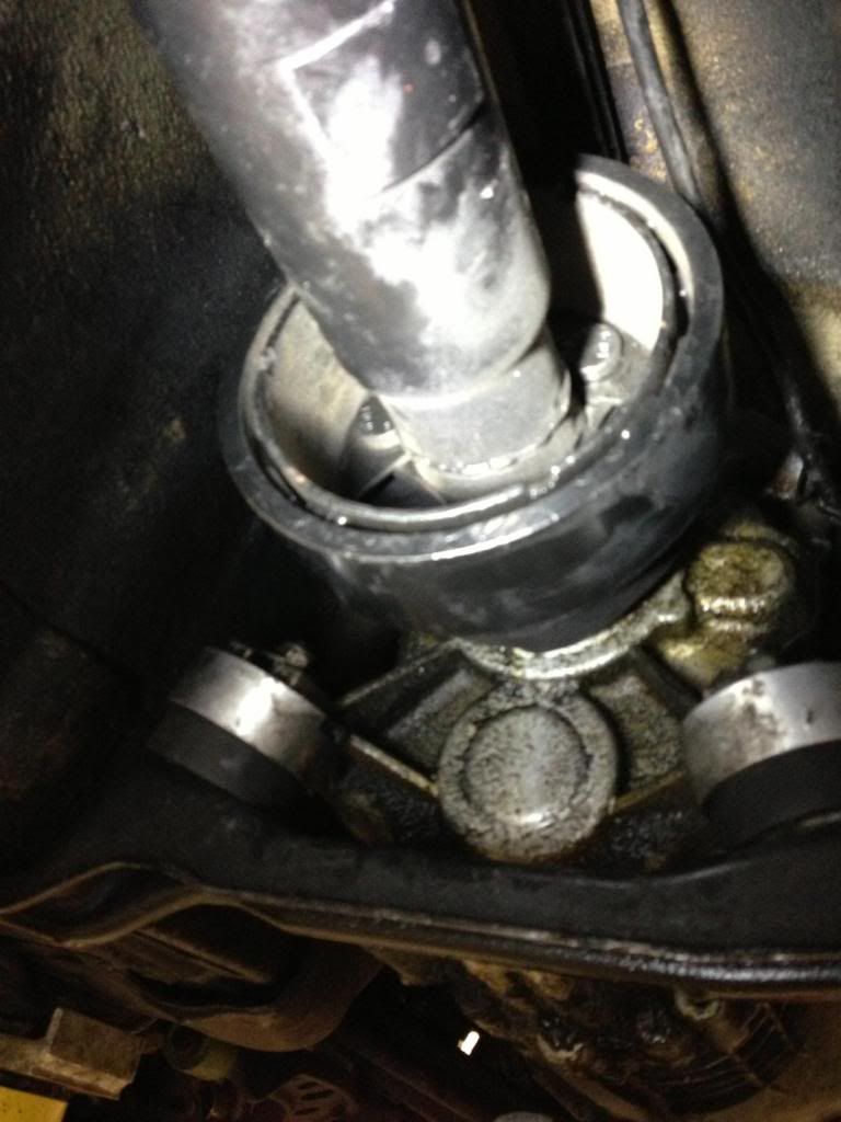

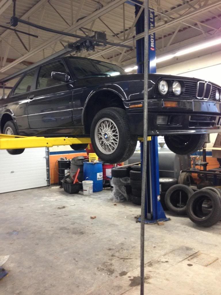

                          Transmission removal begins...
                          After one stubborn exhaust nut, and an extractor socket, all I've done so far is get the exhaust removed.
                          Also, doesn't look like my driveshaft is original, in everything I've looked up, never seen one of these over the guibo?
                          --Anyone around the CT/NY area selling a transmission?

                            That's the vibration damper and is an OEM piece. It's no actually necessary, many people remove them and can't tell the difference... :shrugs:
