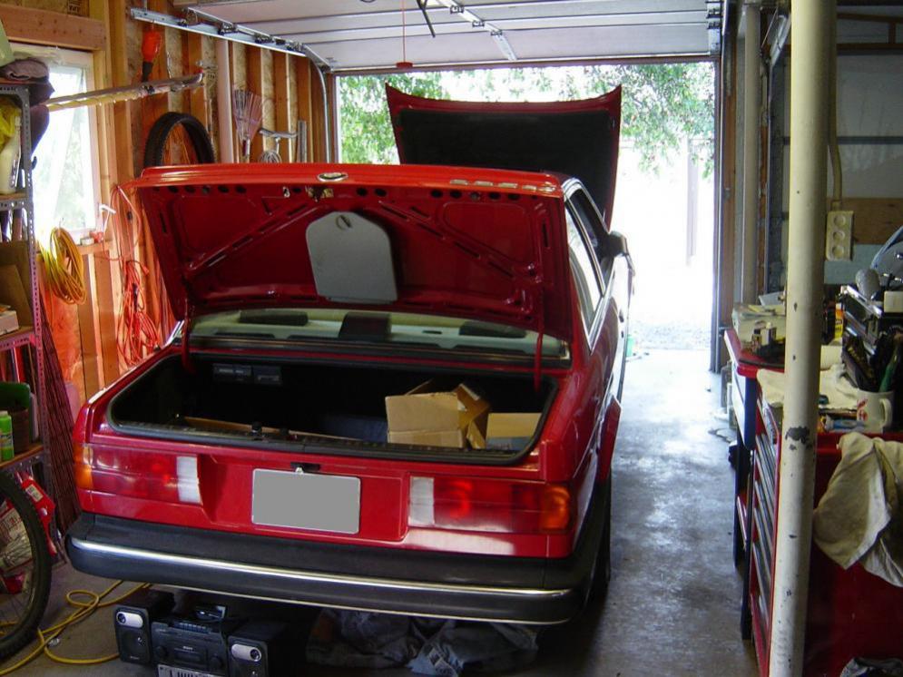

    Weekend Update
    Got the motor buttoned back up again - all new rubber everything & anything, except for power steering and AC hoses.
    Starts right up, which is nice, runs smooth, new injectors by MEPEH are great.....still a couple of idle cycling issues. There was a huge leak at the valve cover plugs - we'll do the smoke test again and find the problem. ICV tests out correctly per the book and advice here, but...sure sounds like a bad ICV cycling, or like every 3 seconds a switch is shutting off the engine for a microsecond.
