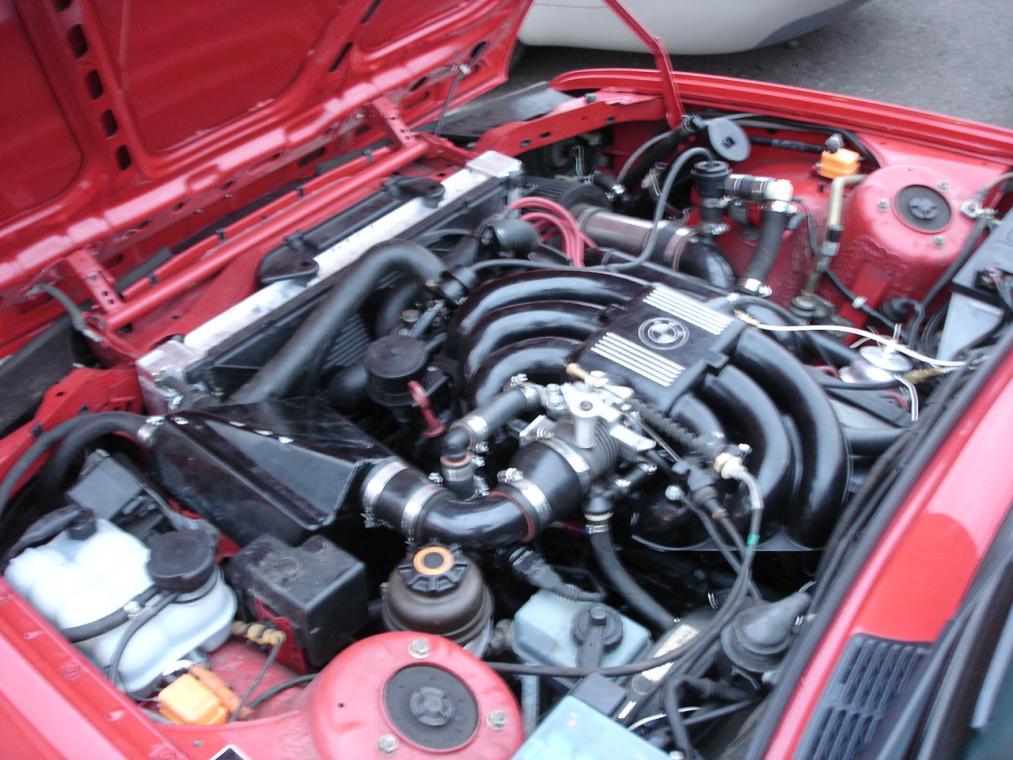

    Originally posted by TC|Photography View Post
    my old turbo E30 Vert
    Untitled by Tyler Cauley, on Flickr
    Would love to see more pictures on this setup. I would like to see how you routed the pipes as well as hide everything. I want to go turbo and am looking for a way to hide most of this as I have to do yearly inspections and I would like to make it as OEM looking as possible.

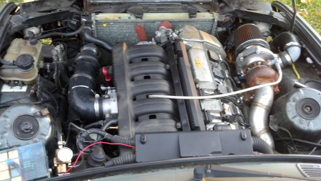

            #35
            Ugliest engine bay?
            I wish it ran, that megasquirt gremlins :/

                #37
                Originally posted by Pl3wA View Post
                Ugliest engine bay?
                If im not mistaken, the drain line is supposed to be at a 90 degree angle, meaning that it should point straight down not sideways.
                  #38
                  hmm. its going down at like a 70o angle. i thought that would be enough, also i dont really have the space to do it soo.... hopefully it doesnt explode.
                  i dont even care tho its never gonna run :,(

                        #41
                        Ugliest engine bay?
                        I would be worried about the drain tbh. It should be as close to vertical as you can make it. I talked to a tech at Borg-Warner for awhile and that was one thing they put big emphasis on.
                          #42
                          If im not mistaken it will cause issues with oil not draining and burning up in the turbo eventually killing the turbo itself.
                            #43
                            Drain should be at the lowest point of the turbo, and the pipe as vertical, and without bends, as you can get it.
