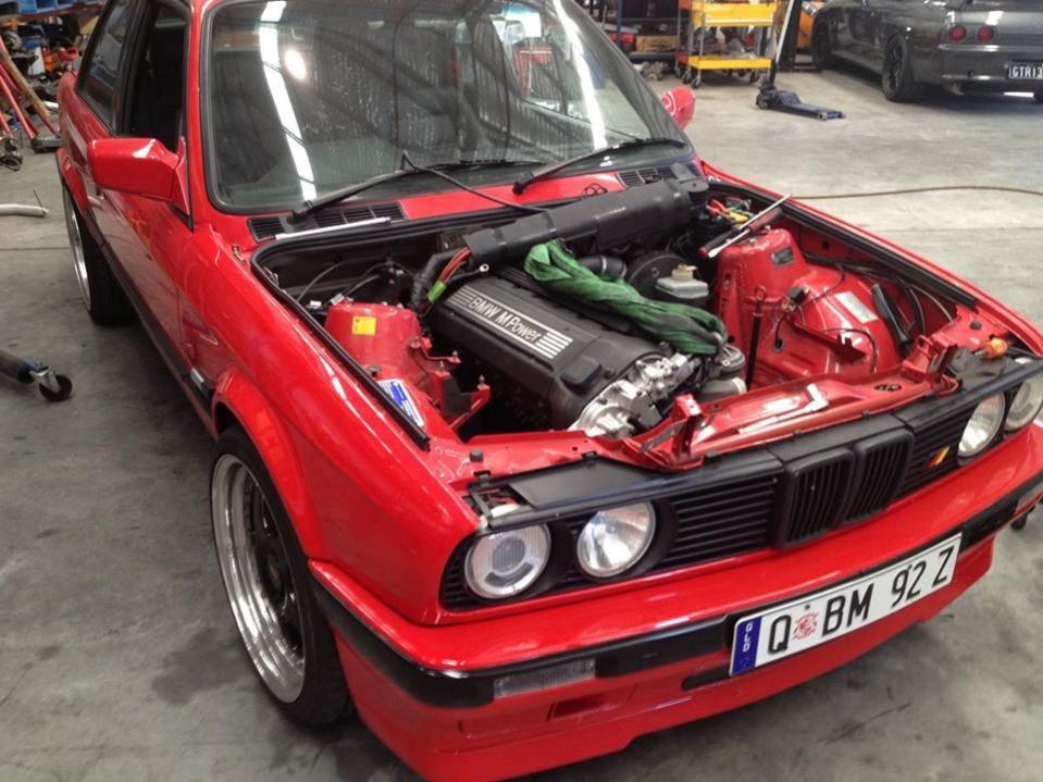

    I've posted a little here and there about my car but thought that it was about time that I start a build thread to chronicle the current build of my car.
    The car is a 1990 brilliant red E30 318is. When I bought the car the M42 was standard save for a K&N filter and new exhaust system. The car looked and sounded nice, but having previously owned both an E46 M3 and an E60 M5, was very under powered. I considered all manner of builds- including an NA M42 build with ITBs, turbocharging the M42, a 20B PP rotary conversion. I eventually settled on swapping in an S50B32 when a mate of mine decided to part out his E30 in which the engine/box etc was installed.
    My good friends at GT Auto Garage were charged with undertaking the swap for me. However it has turned out to be far more than a simple pull the old engine out and put the new engine in job. I have decided to completely rebuild the S50, delete the VANOS and install a stand alone ECU. The list of what I have ordered and is currently in transit to GT Auto Garage is:-

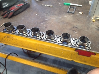

    Here are some pictures. The engine is currently test fitted in the engine bay so that the headers can be fabricated. It is a real PITA that the car is RHD that's for sure.

    But seriously, that thing is gonna fly! I'll be keeping tabs on your RHD headers for sure.

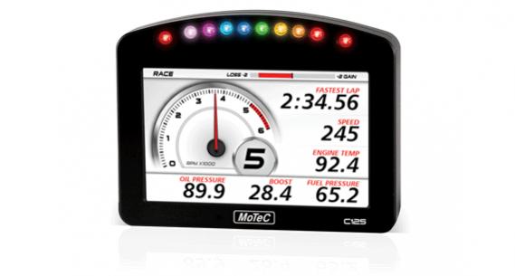

              Thanks mate. Yep lots of $. I haven't worked out a final cost yet but the Motec ECU and dash alone were $6,200.00.
