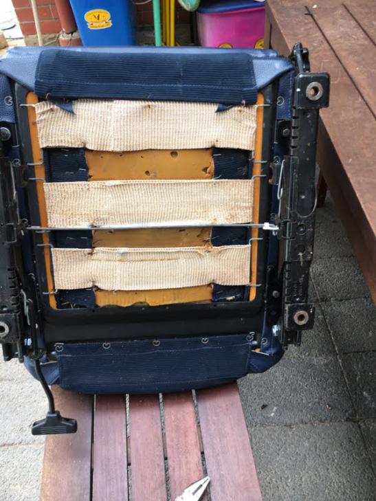

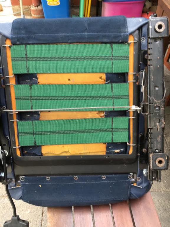

                    Continued with some more small jobs on the car this weekend. My drivers seat had become pretty saggy (ie. it has started to feel like I was sitting on the carpet), so I ordered a set of replacement Recaro base straps from Aardvark Racing. Good improvement over the 30 year old straps, which had gone brittle and lost their stretch!
