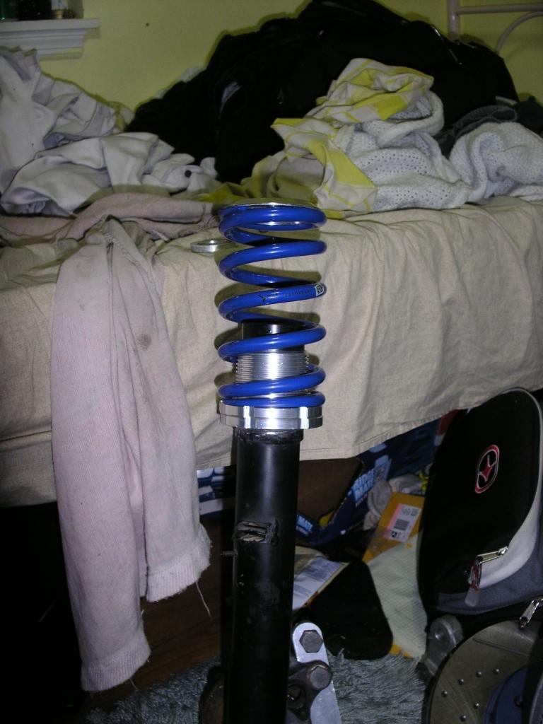

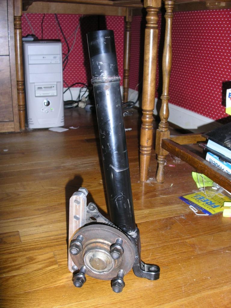

                  Not GC, but Coil overs non the less. And some 4-piston calipers :twisted: The bracket shown is just a prototype to get the fitment worked out, final version is out of steel and should be here soon.
                  The Coil overs will be going on pretty soon, that's actualy a spair housing that I'm test fitting everything on. I'm going a completly custom route, so to minimize down time I'm testing everything out on that housing. The brakes will go on, once I get the funds to pick up a larger MC(spent to much on the coil overs)

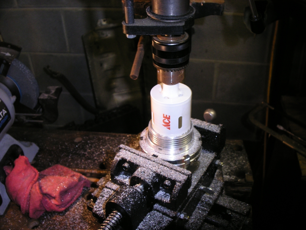

                    Little more Progress
                    Not sure if the adjusters will be to short or not, if so I can easily order some longer ones.
                    Just a little modification needed

                      Spring rates are 350/450 But for the price of them I couldn't complain. Right now I'm at $400 which includes buying the adjusters and springs(front and rear), Ireland Race camber plates, and the Vise so I could do the modifications. The rears will be a lot easier, just need a spacer and thy should be good to go.
