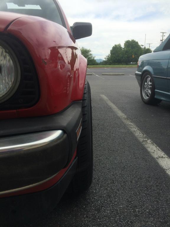

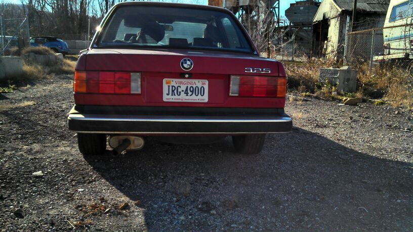

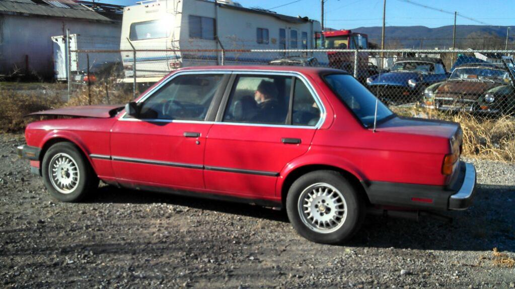

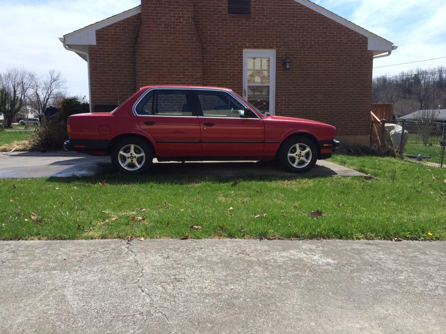

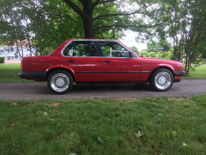

So I have owned bmw's for the past 6 years or so and was itching for a DD so I could keep the miles off my e36. I searched for well over a year and finally spotted a red e30 sitting on a roll back in the back of a guys yard. I stopped in and spoke to the owner. He said they bought the car 6 years ago from an old lady and have yet to be able to get the car running. The interior of the car was immaculate, including a crack free dash, 149,xxx miles on it and a 5 speed. The guy told me I could have the car for $800. I showed him $650 and he took it.
After getting the car home I bought a battery and attempted to start the car, just cranked and cranked. I had spark but no fuel. I figured since the car sit for 6+ years I would start replacing things that would need to be replaced anyway. I replaced the internal and external fuel pump, along with a new fuel filter. So now I could hear the fuel pump kicking on! Great! Still wouldn't start. I bought an extra dme and still no start. Then it hit me, how clogged those injectors must be. Found a used set on craiglist for $20. Threw them in and bam! Started right up!
Ok now the car is running. Went to pull out of the driveway and take it around my block, went to hit the brakes and the pedal went all the way to the floor! Installed new brake lines, now we have brakes. Ok now the car is running solid and in good driving condition, off to fix the little things.

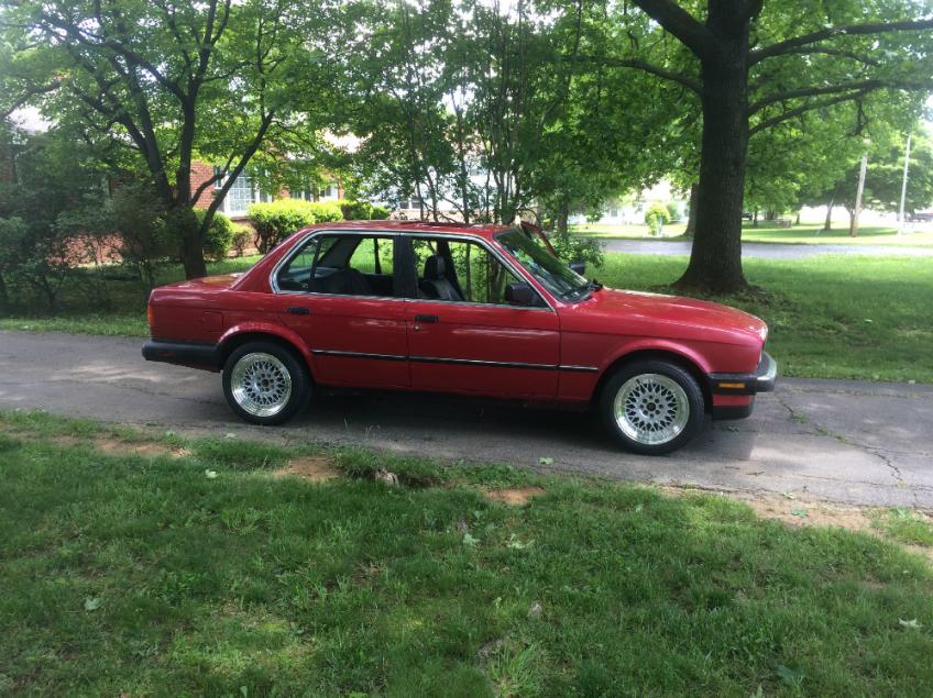

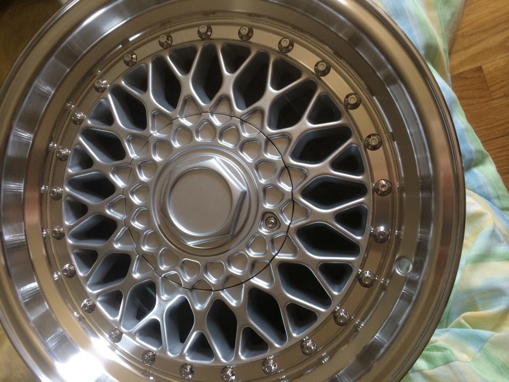

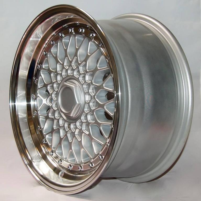

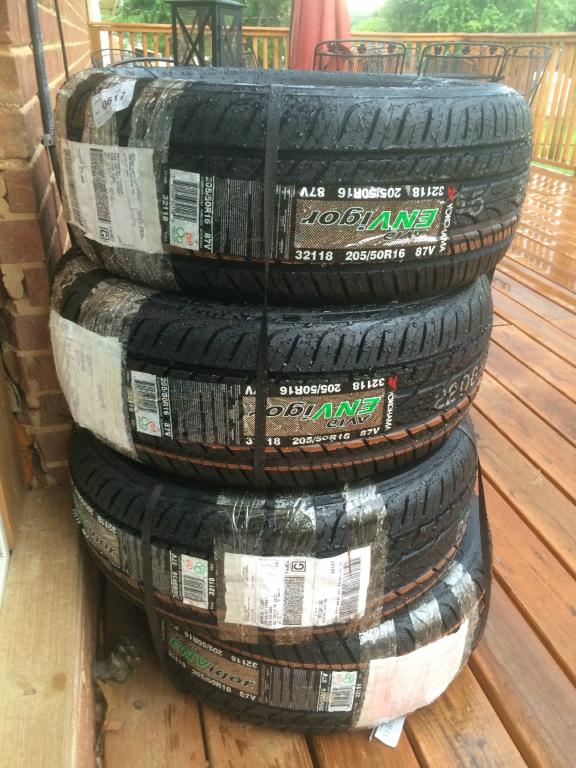

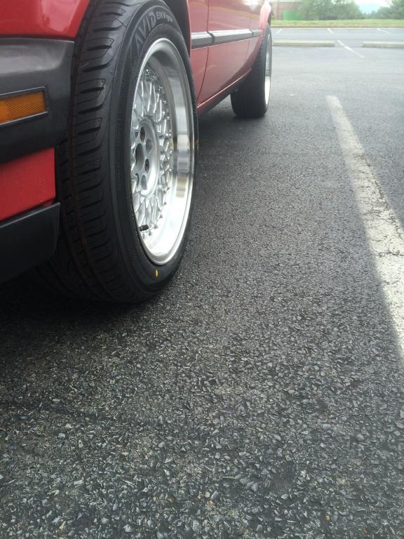

The tires were also dry rotted bc of sitting for 6 years, picked up a set of borbet wheels with new tires for $200!

$1150 total on a now reliable DD with 150,000 miles

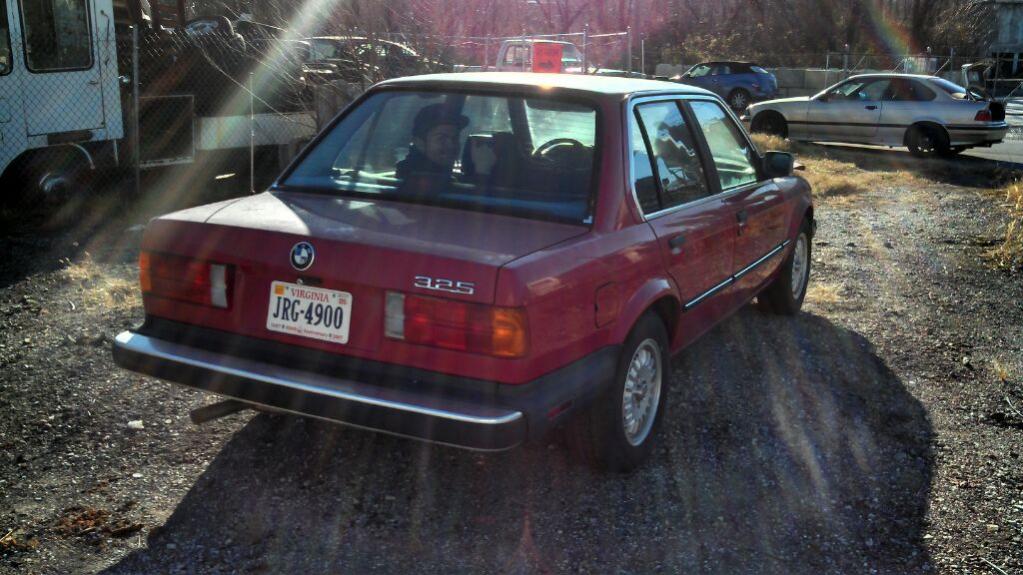

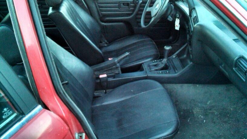

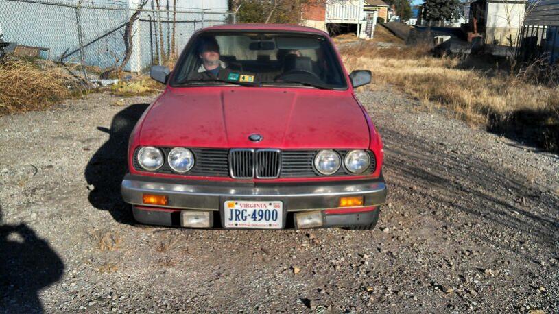

This is my first write-up, don't bash me too bad! Pics attatched are from the day I picked her up.
