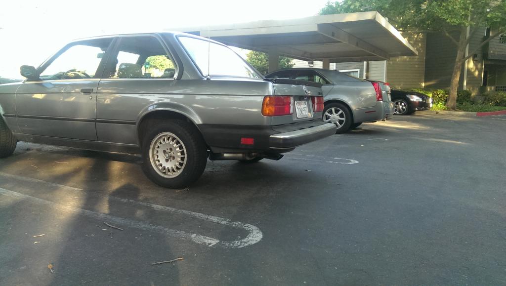

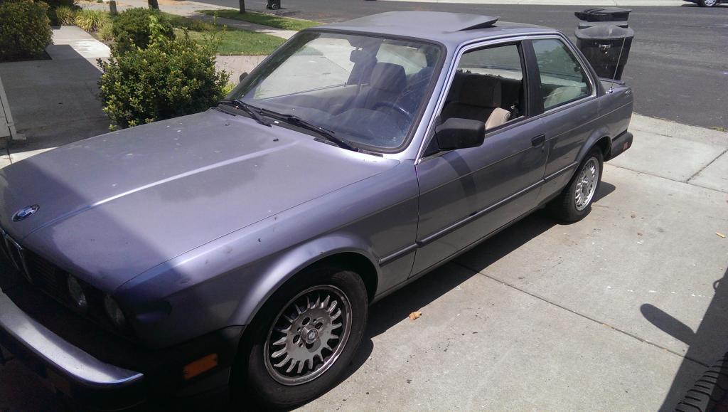

    This car continues to amaze me and impress me with how fun it is while still being super slow. Especially coming from my xr4ti this thing is slow but at the same time its fun having to keep the momentum up and going around town. Here are some pics of my girl, some from when i first bought her and some from today after I had the new muffler put on (the old one had broken internals and annoyed the crap outta me).
    I feel like the chrome tip looks nice without being too over the top, my xr can be over the top for me.

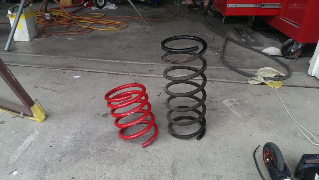

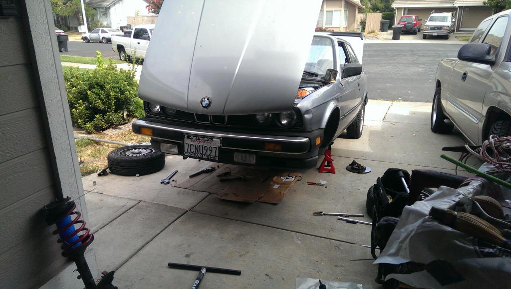

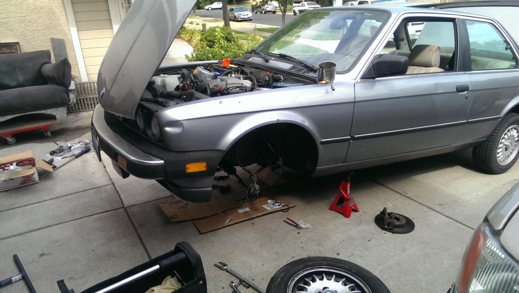

                    Today I finally got everything I needed to lower it and replace the control arms, control arm bushings, and tie rods. My friend and I were able to do it all while working at a leisurely pace in 3 hours, I feel if we were booking it we coulda cut it down to 2 tops but oh well we had time to spare.
                    I used some used h&r race springs I had purchased from a member on here, fronts had 1 coil cut off. I was worried it was going to be way to low however it sits nicely while looking much more aggressive. I also was concerned because my car is an early 318 and as such is lighter then the other cars this spring was designed for.
                    For the dampers I went with bilstein sports. I was torn between them and the koni yellows however I have the koni yellows on my XR4ti and they ride pretty rough so I thought i'd give the bilsteins a chance and I am not dissapointed. The car feels so much stiffer from the springs, handles so much flatter, and looks like it wants to be driven hard now.
                    The control arms are just stock replacements from Pelican parts. I replaced the control arms because I didn't know if they had ever been replaced and i was already going to be doing the lower control arm bushings as they were shot. For the control arm bushings I went with condor speed shops m3 offset solid control arm bushings. Tie rods also had to be replaced due to wear on the inners.
                    The new to me lightly cut front spring vs stock front spring in height
                    The car as it sat while we had the front apart. I hate working on the incline but my friend has a working air tool set up so we do the work at his house.

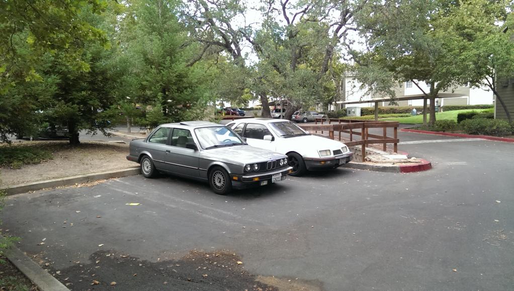

                    Obligatory shot of my 318 next to my XR4Ti. Now that its lower I just need to get some recaro trophys for it, I already have a pair in the XR and they are amazing.

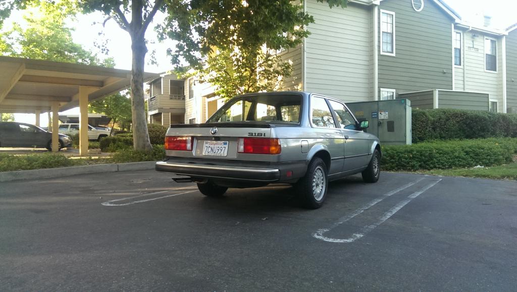

                        I figured i would make a new post since its been a long time since i've posted anything related to my car. Nothing big but this is her sitting out at a local brewery I was at.
                        Changes done to it in the meantime since my last post would be I changed the rears to be eibach springs with adjustable perches, added a rear swaybar, front drop hats, and changed the exhaust when my magnaflow fell off on my way to work. Now shes running a bullet racing muffler (almost straight thru) and 2.25 inch catback with a big tip (you can see it poking out in the back of the pic).
                        I've also replaced the alternator bushings as well as the adjuster for the alternator. This and a new belt finally fixed my nagging belt squeek and somehow made the heater start working properly when before it worked maybe 20% of the time.
                        Last week i replaced the wheel bearings on the front as well as the rotors and pads, its a lot quieter while driving only problem is now i can hear all the creaks and groans from the stiff suspension :p.
