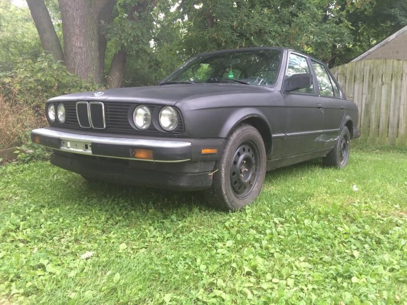

            Heres a lame iPhone picture. She's not pretty but its a starting point. I went for a clean body over nice paint/wheels. Second picture is the stack of repair papers/reciepts I got. Pretty happy to see it was taken care of!

                  what's the original color?
                  • E30 Wagen
                    • Jul 2005
                    • 3431
                    Cool, another Michigan e30. Welcome.

                      Original color, I believe based on service records, is grey (Excuse my lack of OEM BMW colors)

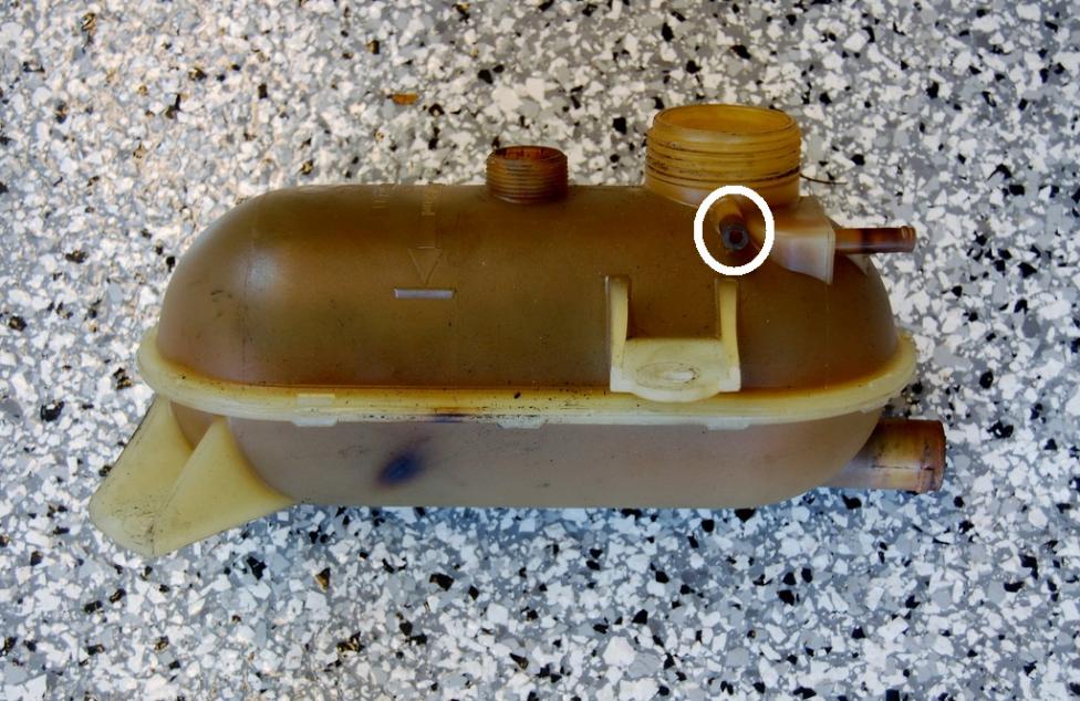

                          For those of you who know the m20b27, the hose that comes out of the coolant tank right by the cap, should that be connected to anything, or is that just an overflow hose?
                          • Ether-D
                            • Sep 2011
                            • 2838
                            On the b25 that I believe goes to a small tit on the radiator.

                              Okay, thinking about how the cooling system is a sealed system, pictured below is the overflow tank, and the one I circled is the one that has about a 12 inch hose connected to nothing
