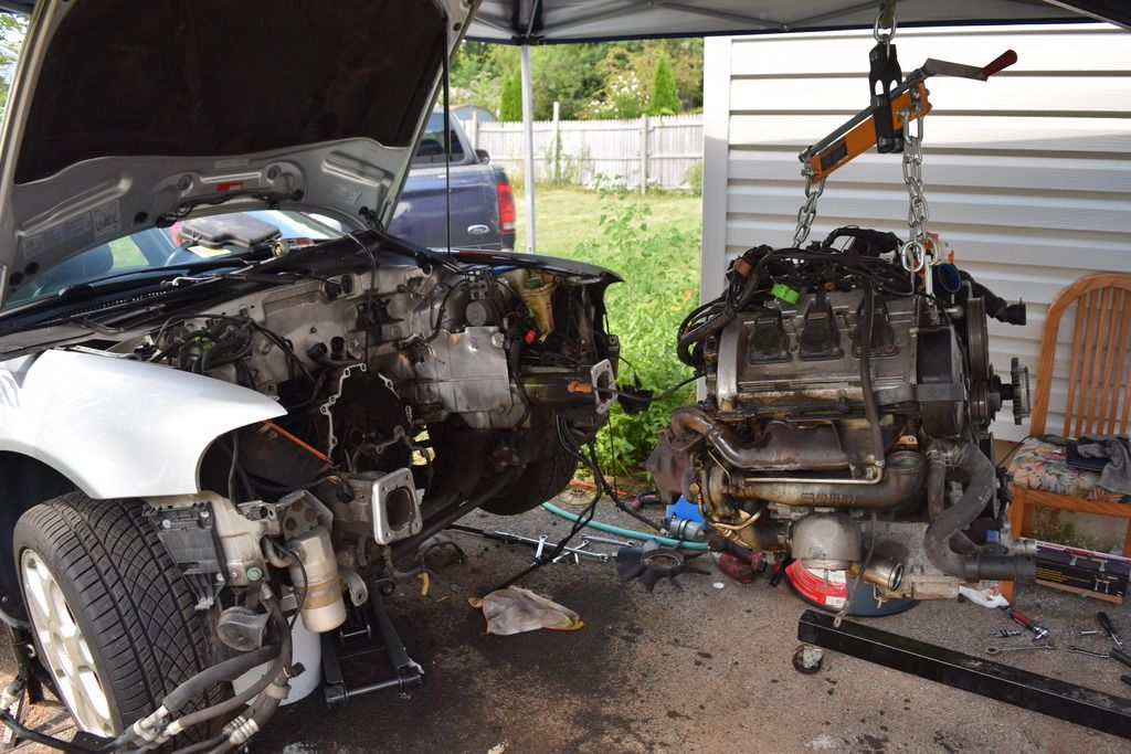

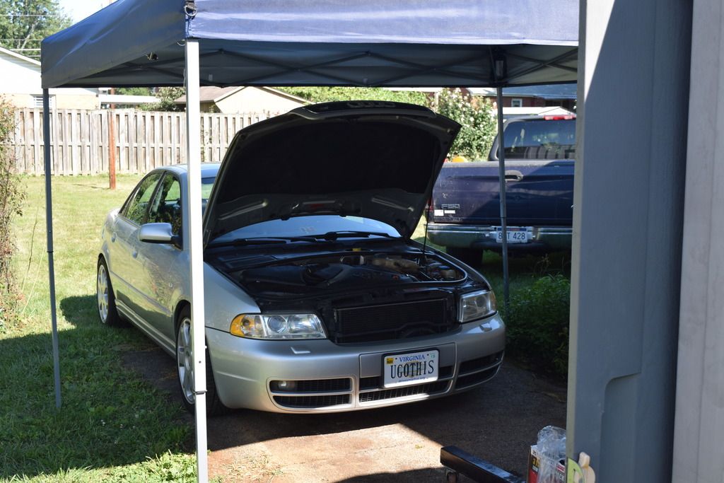

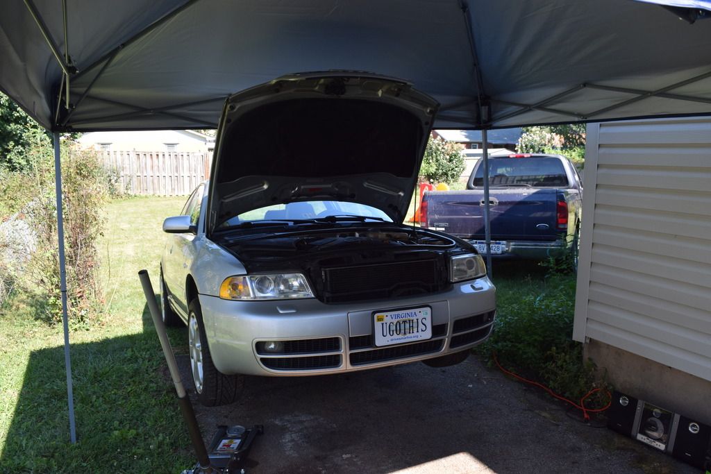

    Lunch break.
    Setting everything up
    All set, I wouldn't be getting anything done if not for that canopy. Its actually quite nice.
    Service position, which is why I do not agree with those who say these are hard to work on cars.
    Took me a little longer than expected, but I haven't pulled one of these before. Took about 5 hours.
    Taking a break now, going to eat and relax in the A/C for a bit. I'm planning on installing all the parts onto the engine this afternoon, and reinstall tomorrow morning. May start putting it back together tonight, will have to see how I feel.

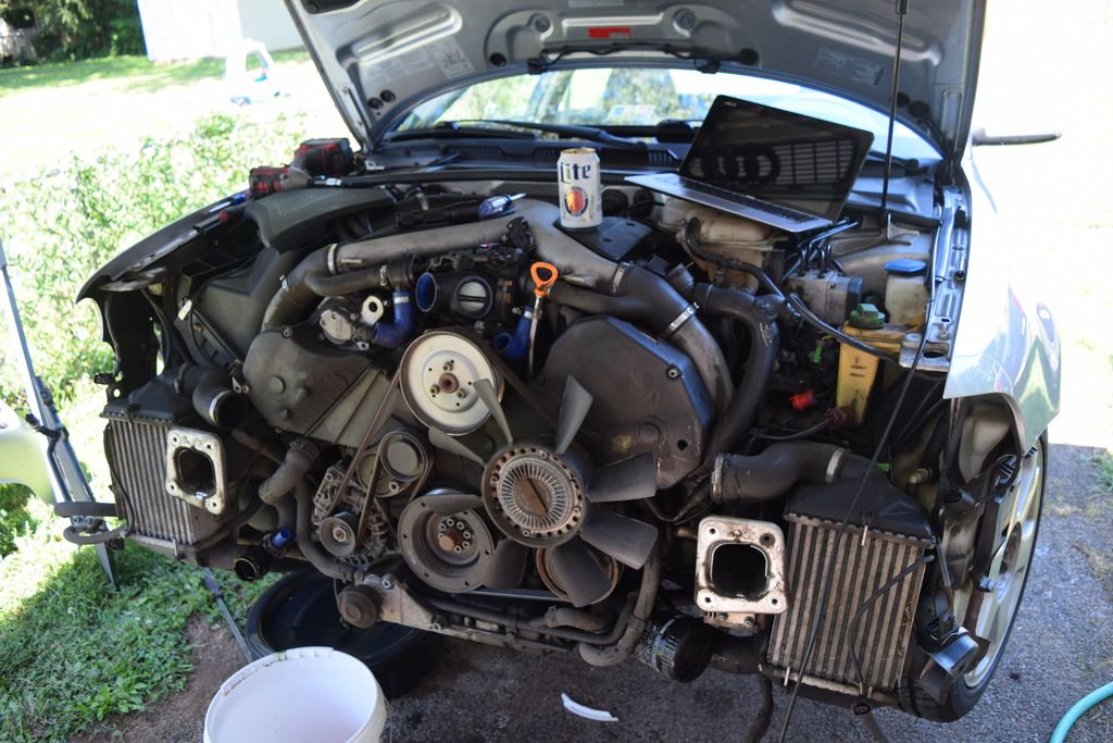

    Ready. Set... Will update lots of photos tonight.
    Intercooler and exhaust are being delivered today. Having breakfast with the family before they head to the in-laws for the weekend. Then it's on.

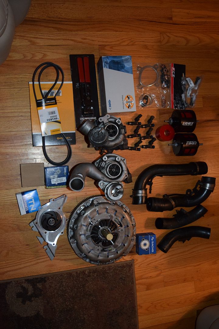

    Almost there! Going to go ahead and drop some cash on a genuine OEM timing belt tensioner. I don't want to risk it with a cheap version.
    Also sent and E-mail to SSAC about their twin 2 cat back. Hopefully the guy with the APR comes through though.

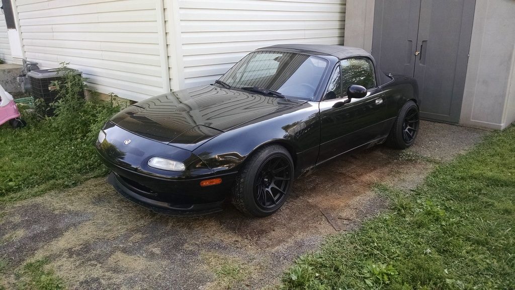

  • Exodus_2pt0
    replied
    Shed is moved, much much better. I have about 18 feet of asphalt to work with. Won't be able to back it in like the Miata is and still service (The Audi JUST fits on the lot). It will be a nice place to park the Audi out of sight from the road though when we are on vacation.
    So, I'll park the Audi so that the front wheels and drivetrain areas are on the asphalt. Should leave me enough room between the car and shed to yank everything out.
    Trading the Miata for a truck and hoist for the weekend. Picking it up on Thursday night (next week), then its busting ass Friday and Saturday. Would like to have it done in 2 days.

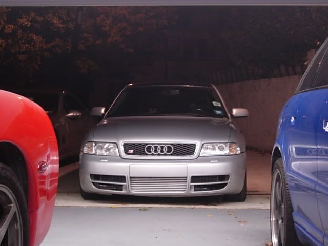

  • Exodus_2pt0
    replied
    That's the problem... I could go either way.
    If it gets a front mount it will have powder coated black pipes hidden behind the stock grilles. Semi-sleeper if you will.
    Like this, except black pipes.
    Only downside is no fogs, but mine leak and burn bulbs so I don't use them anyway.
    That kit runs around $550, and they did pull off a 12.2 second pass on k03s, and almost hit 10s on k04's with it. So it definitely performs.
    Other option would be SRM side mounts which are a bit priceyer, but will retain that 100% sleeper appearance.
    I'm leaning more towards the FMIC, just looking to get other opinions.
