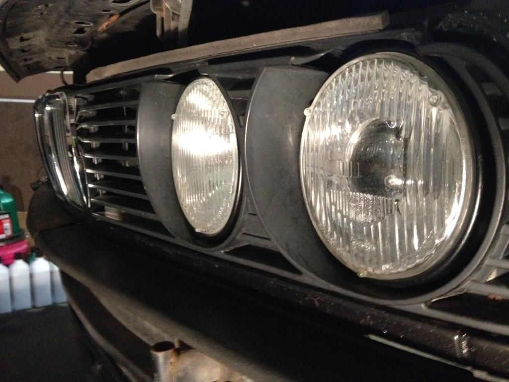

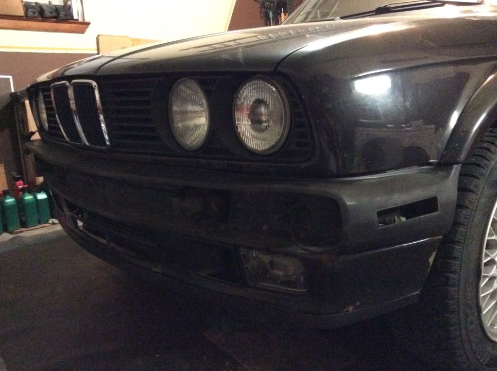

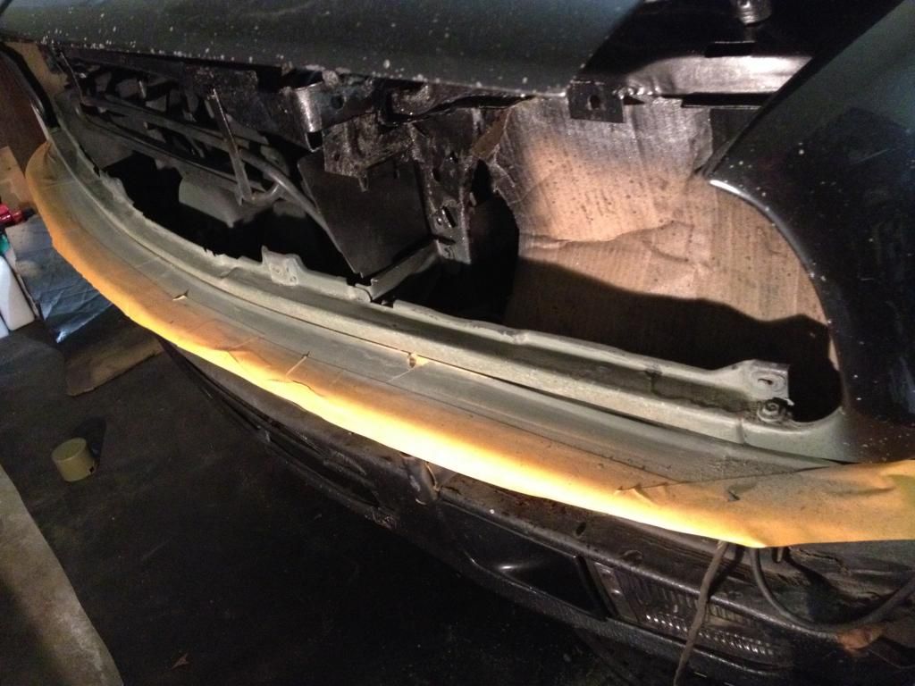

          Removed the front bumper to replace the diving board black trim and license plate holder. They were warped and faded so I ordered new ones. Plus I had to bend back the lower valence since it was bent, and added new lip clips and a stock lip I had laying around.
          Btw does anyone know how the rear diving board bumpers come off? My plastic ones have two large bolts underneath, but this one doesn't.

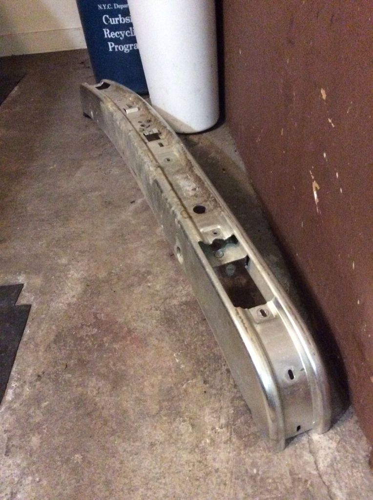

            Bumper all cleaned up waiting for new trim pieces

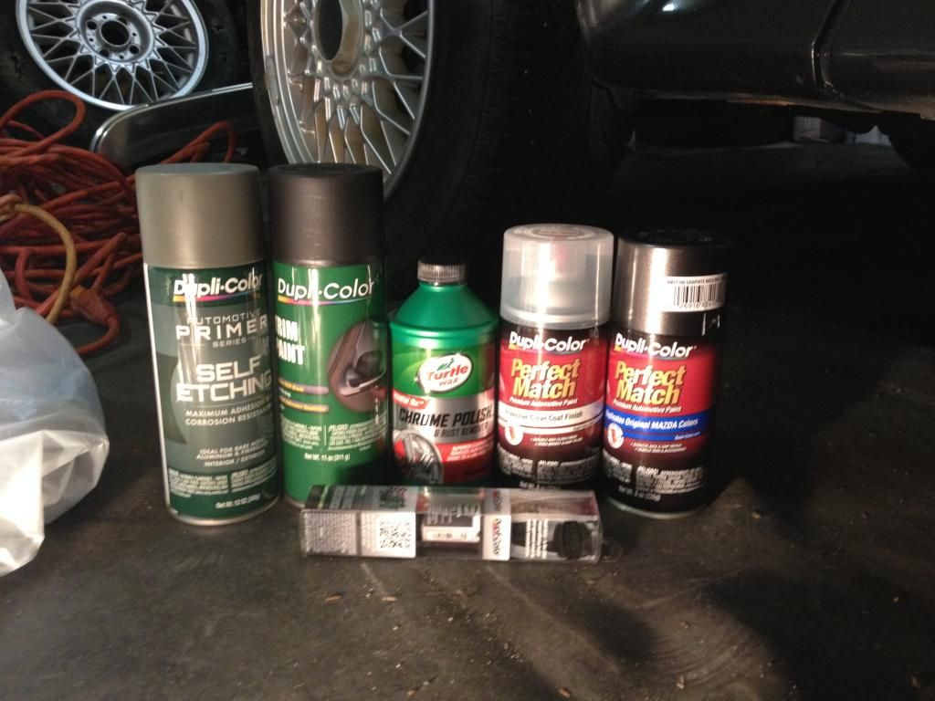

                    Did a little paint touch to the painted area below the kidneys and grills since it was chipped up to all hell and surface rust started forming. Found some Mazda black pearl grapihite which was a very close match to DS, sanded primed and painted it. Also painted the ellipsoid rings and iS lip spoiler using trim paint. Came out better than expected....also have a new hvac bezel and 13-button since the old one is cracked and dim

                              The rear bumper is a little different on the DB rear bumpers. To take then off you actually have to remove the piston first, then take off the black trim pieces.
                              It is dumb because on the DB rear bumpers there is no hole in the bumper to gain access to the bolt attached to the pistons that hold it to the frame so you just take the piston out instead.
