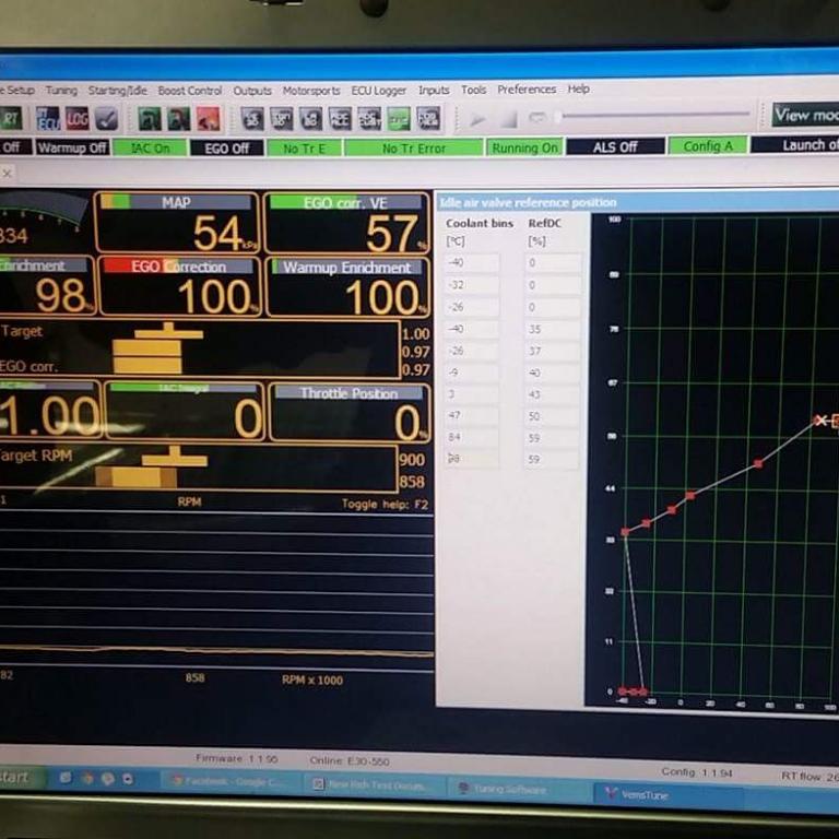

              Hooked up idle air control yesterday through the vems leftover 2 injector outputs. Got it idling hot and starting right away with no pedal input. Going to work on getting it to idle around 800 rpm today, and hopefully cold start. Car runs a lot better with IAC. Vems can do PID closed loop control which will stabilize it even more. Gotta read up on it a bit more though.Click image for larger version
