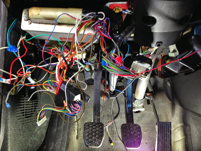

    After that was all said and done it was running great for a week, my key stopped working in the ignition which ended up being the ignition switch. So I ordered a new one and replaced it.
    While I was under the dash I found this mess with the wires and ended up fixing it up a bit along with the switch to hopefully eliminate any future problems. Further on I located more issues that I am working on resolving, which includes removing the entire keyless system and alarm and fitting it with the original door actuators.
    Slightly better.

                          Newplugs. It prolly has its purpose and I don't plan on driving it in the winter so it shouldent ever be that wet again,
