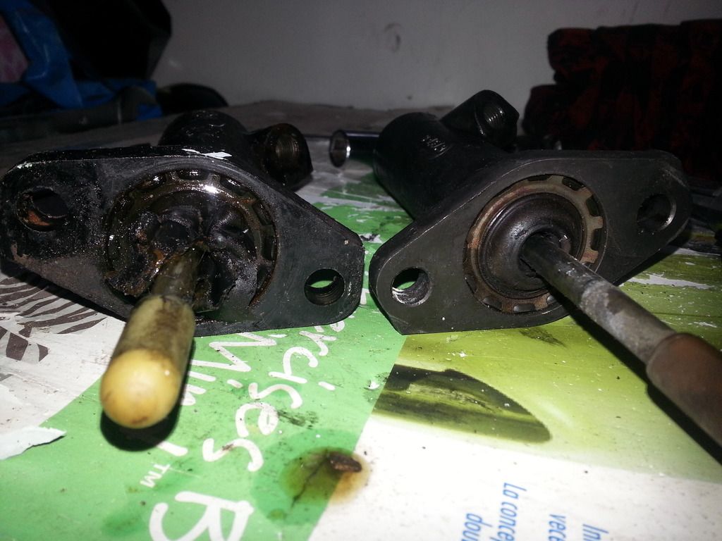

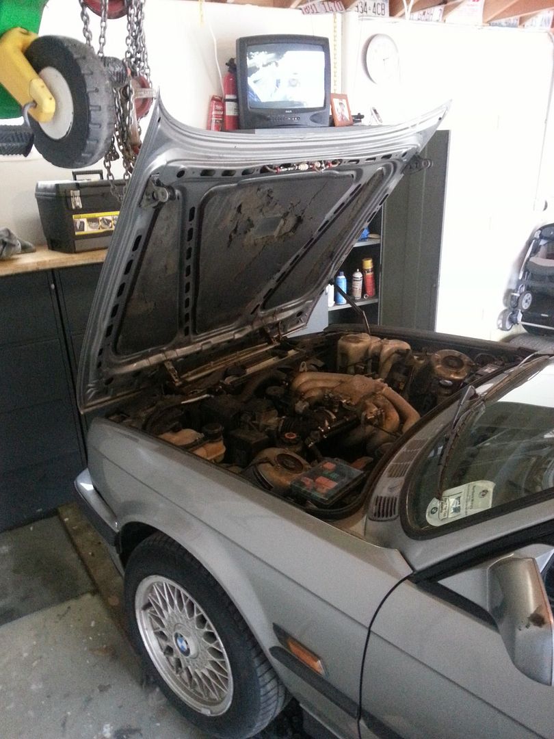

I took it out for some more errands and after 3-4 stops over the span of an hour, I noticed it was getting tougher and tougher to get into 2nd gear. I started skipping it and going into third and took it home to take a look.
I figured I would start by bleeding the clutch system. It was about time. The reservoir had a layer of scum/sediment on the bottom so I turkey-baster-ed the fluid out, took off the reservoir and cleaned it out with brake cleaner.

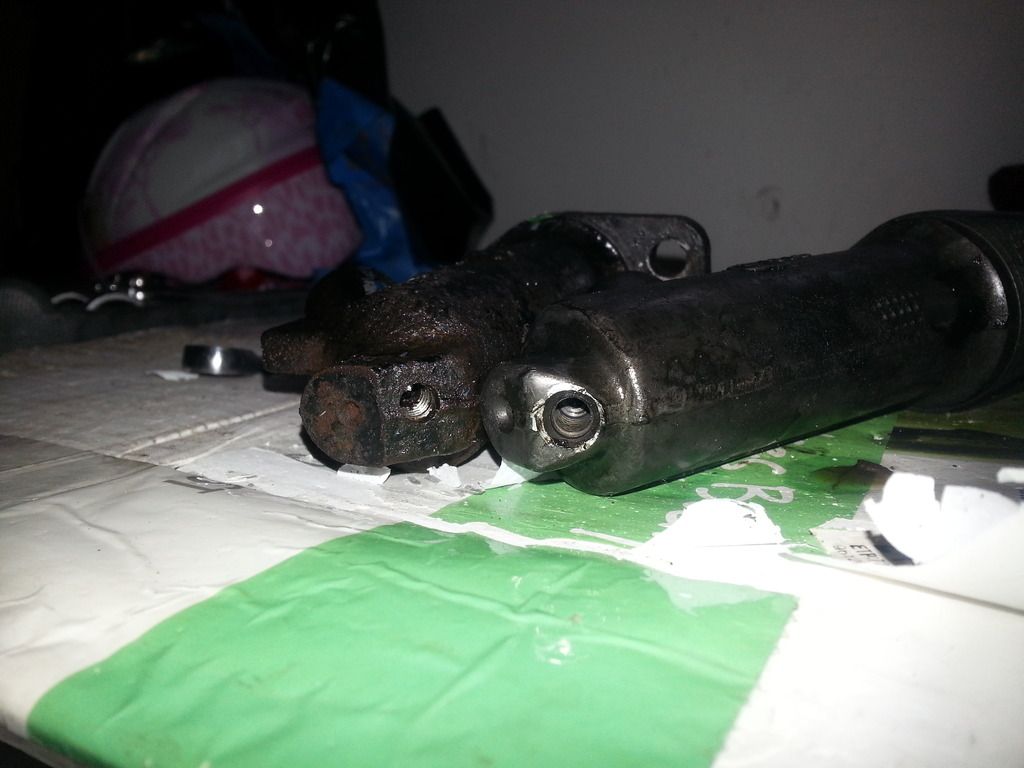

Then, on ramps, I tried bleeding the slave cylinder and nothing would come out. I took the bleeder screw all the way out and I can see the bleeder hole was completely blocked with more gunk and shards of something. No amount of sewing needle or coat hanger work would clear it out and the seal on the front of the slave cylinder was ruined anyway. Luckily, TrentW had one for me so I did not have to wait to order a new one. After a thorough flush, an additional brake system fluid flush the car is driving as normal again. I even cleaned out the garage while I was out there!

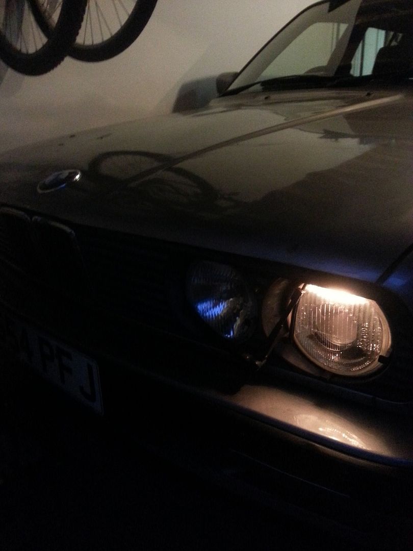

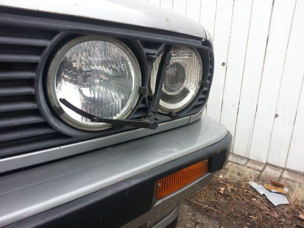

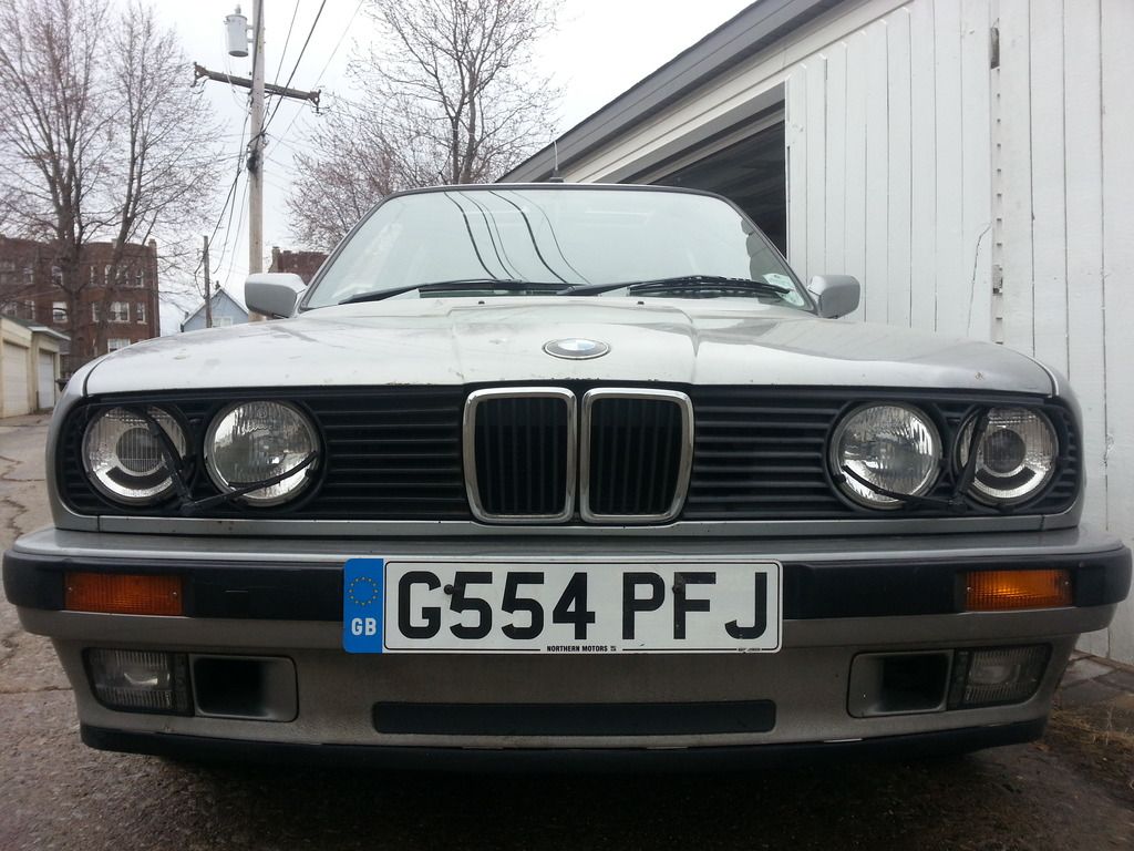

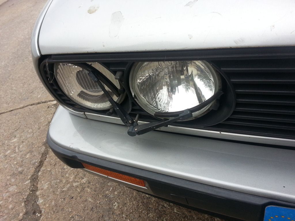

I snuck in a few gratuitous shots of the wiper blades I rigged up too. I love that headlamp wash/wipe system.

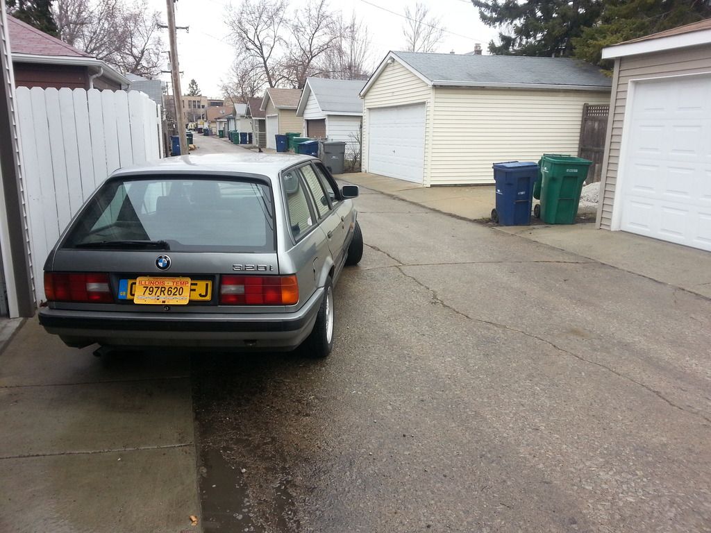

My license plates and mostly complete registration card came in the mail today. I hope this means my title is coming soon and that the car is legally registered in the eyes of the IL DMV.

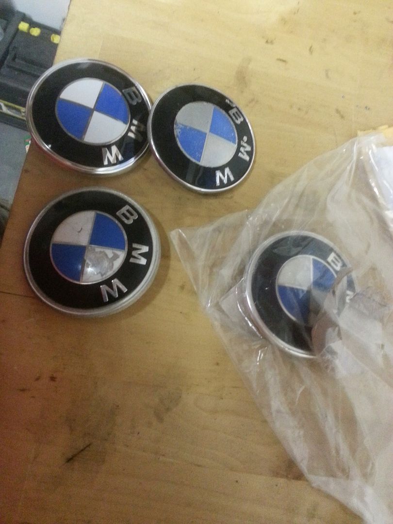

I got new roundels for the hood and hatch since the old ones were worn out.

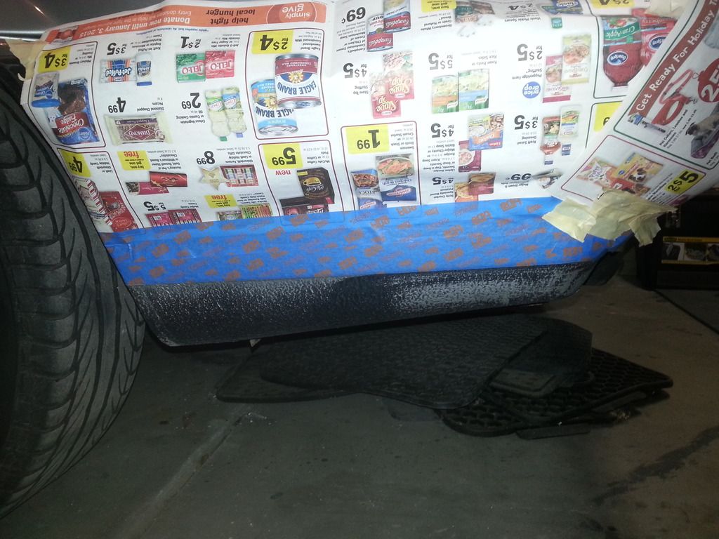

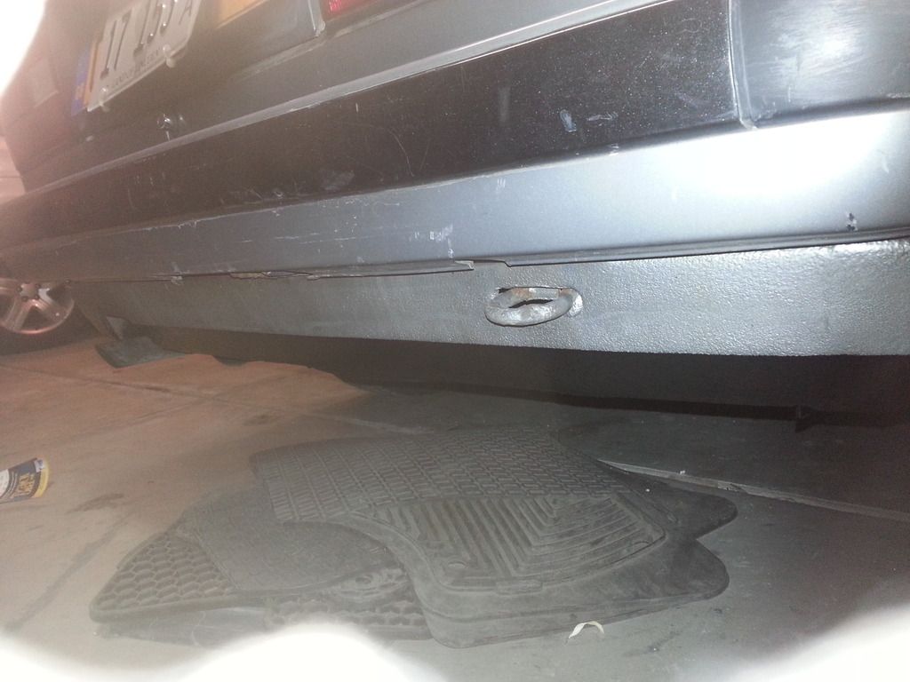

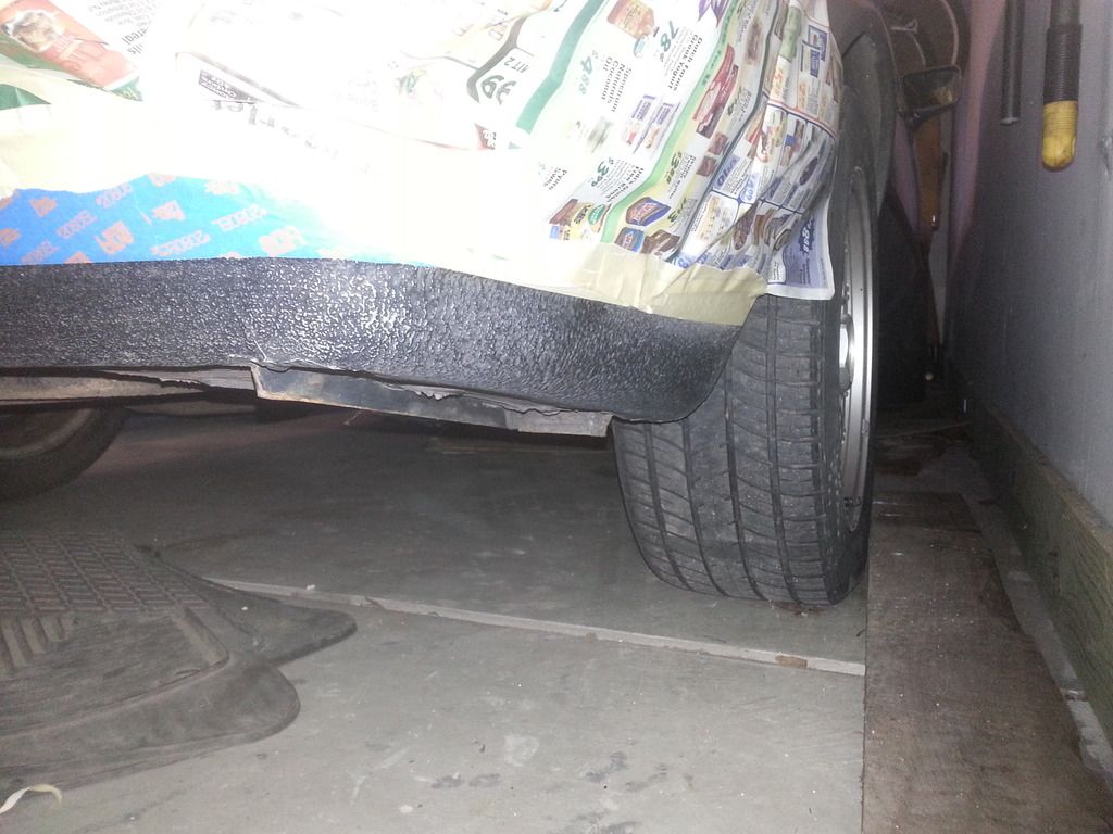

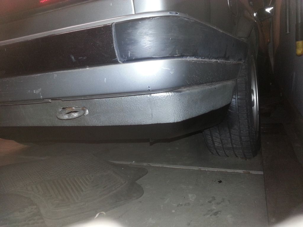

I painted the rear lower valence black like it should be. Now the rest of the paint around it looks even crappier but that's progress.

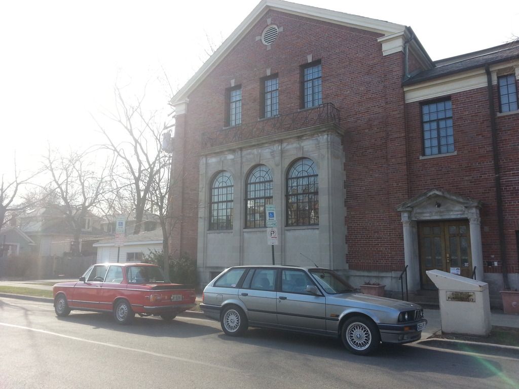

Lastly, I met up with my friend in his 2002 on Easter for some impromptu photos. I hope y'all enjoy.

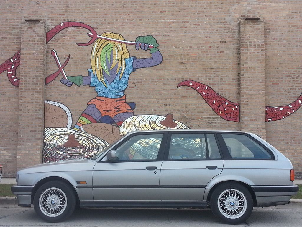

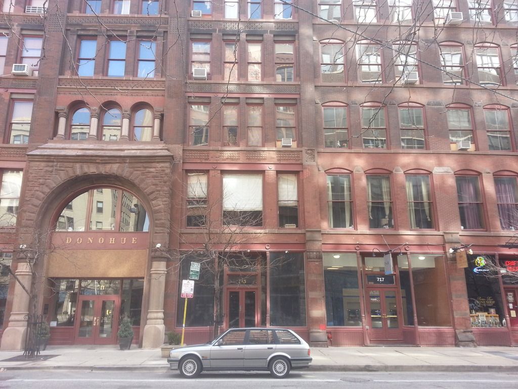

I organized a small meet for e30 people on the Chicago lakefront last weekend. Here are some pics from on the way to the event, the event and on the way back. Locations were Dearborn Park, Montrose Harbor and Lower Wacker Drive.
