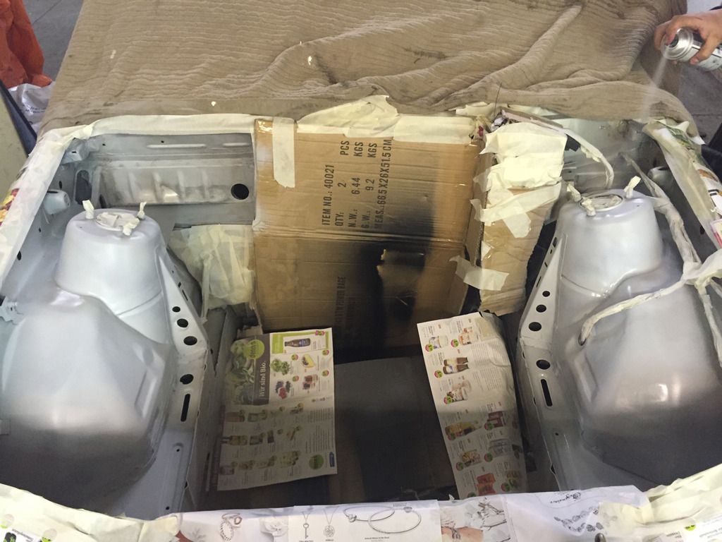

                            still preparing the engine bay for the M60. Welding, sanding, shaving, filler, primer... it all takes time. But we are finally close to finishing the new home for the V8...
                            Brake booster bracket welded in (the welds need to stay exposed for the TÜV inspection):
                            some final details addressed:
                            fresh bronzit!!!!
