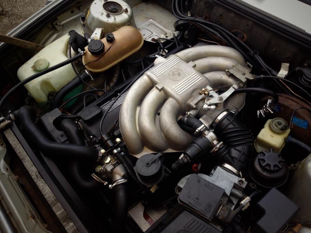

  • modernist
    replied
    Another pretty engine picture, and a before picture. Some difference, huh?
    Leave a comment:
  • modernist
    replied
    Haven't driven it much; so far I've noticed that it has eta torque but doesn't stop pulling after 4500. Sounds fierce, loves to rev. Now I know what people mean about M20s being rev happy :)
    I'm having idle troubles, though. Specifically, cylinder 6 misfire. Upon cold start, it idles ok for ~20 seconds, then starts misfiring. It revs smooth, pulls hard, and starts almost instantly, but at idle cylinder 6 is missing. Hoping it's the plug wire I spliced to get the cylinder ID sensor on it; ordered a new OEM one. The resistance matched the other plug wires but it could be arcing at the splice. C191 pins check out for continuity.
    Exhaust symphony
    Start, idle, and rev
    Input appreciated, I'm kind of a noob!
