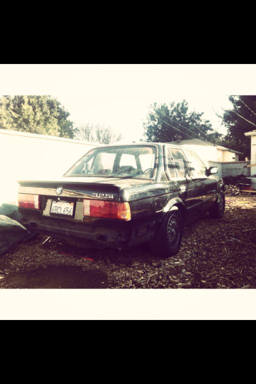

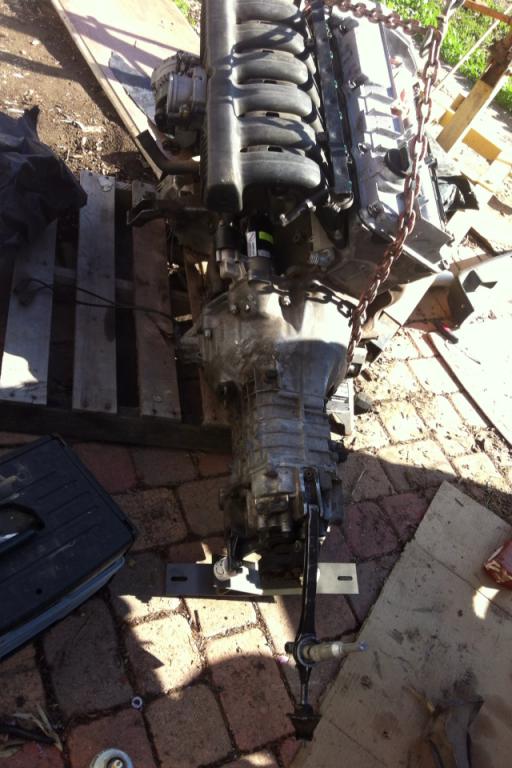

    i bought the car about 3 years ago. the cars a 325eta 4 door, i only got to drive it for about 7 months and then the engine fucked up(timing belt) i ended up finding an m50 from a 92 e36 for cheap from a member on here
    I'm getting help from a few friends
    m50 engine with beauty covers makes it look a bit cleaner
    new spark plugs
    new valve cover gasket
    new oil pan gasket
    new water pump with metal impeller
    new thermostat
    G260 transmission
    new clutch with pressure plate and TO bearing
    new e28 motor mounts
    new condor m50 swap transmission mounts
    24v transmission brace
    rebuilt calipers with fresh pads and braided lines
    eta driveshaft
    porsche brake booster
    S54 radiator with e36 hoses
    LSD S373
    Full Mtech 1 kit
    new m20 starter
    z3 shifter with new bushings
    new control arms with m3 offset condor bushings
