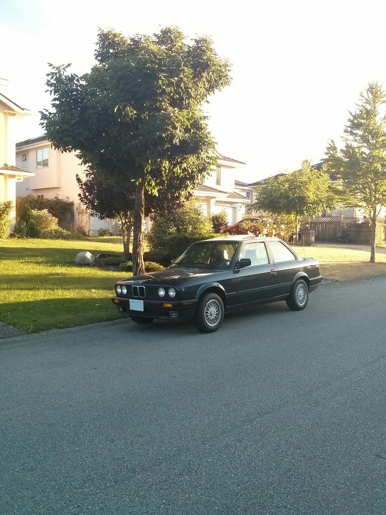

    1991 318is, 285k km Diamond Schwartz Black, PPO took really good care of it and PO was pretty good as well he says he only put 7k on it over 1-2years of ownership -I am the 4th owner.

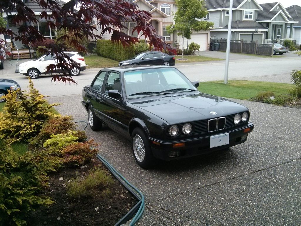

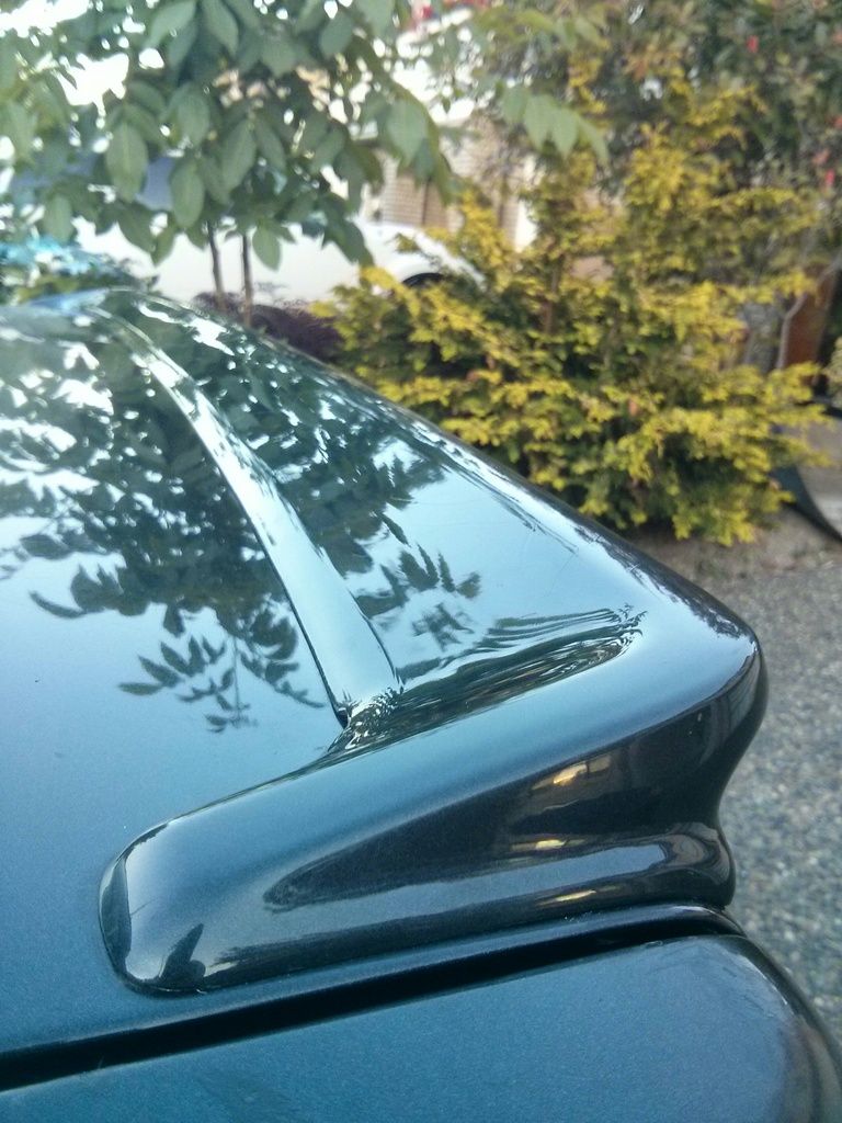

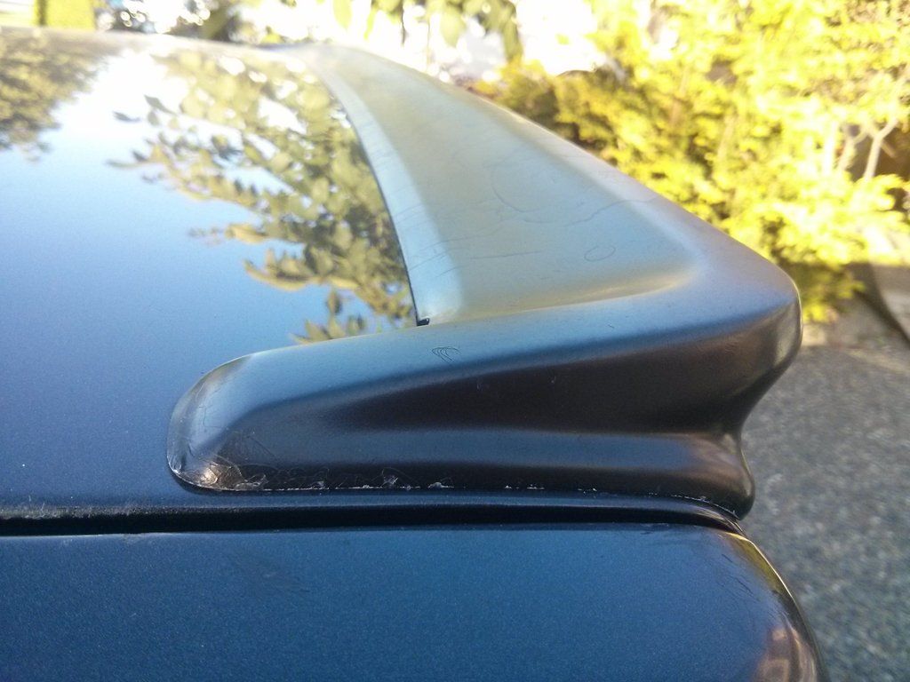

    Found a spoiler for cheap on Craigslist: same color, $40 and just 15 minutes away can't go wrong.
    I don't think the old one had any paint left on it:
    New lip spoiler it doesn't even look like the same one, much better!

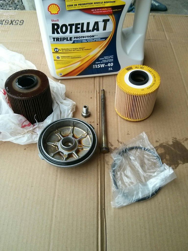

    Oil change last week, the dealer recommended 15w40, and online sources said the same. It seems heavy to me, but I don't pretend to know much about these things as I'm still learning. What do you guys think?

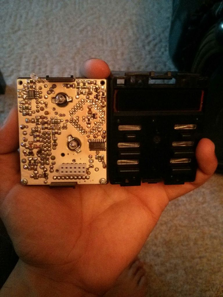

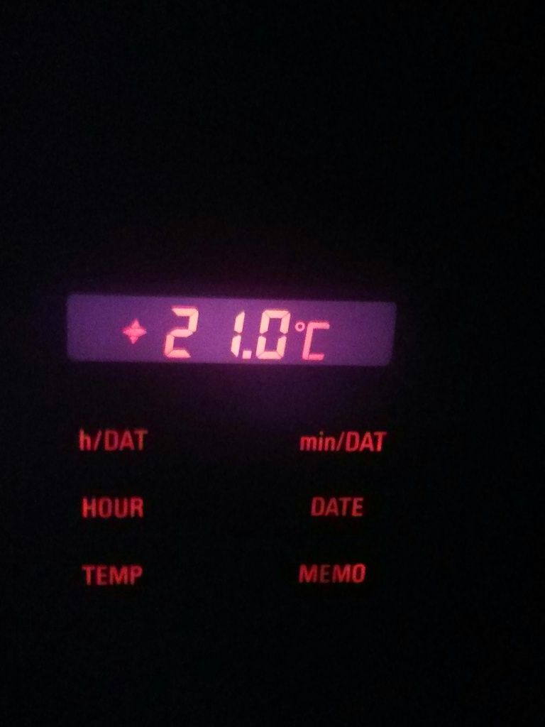

    The MFC wasn't working when I got the car and I wasn't sure why, turned out to just be loose bulbs. It wasn't too bad to get out of the car but opening the unit was tricky, I wedged in two small flatheads to hold down the clips while I wiggled the halves apart, luckily I managed not to crack the plastic. The bulbs were quite stubborn to remove so I'm not sure how they become loose, bent the tabs a bit and reinserted them, although I suspect one of them may have come out of place again as the display seems dim in the days since taking these pics.
    Fixed:

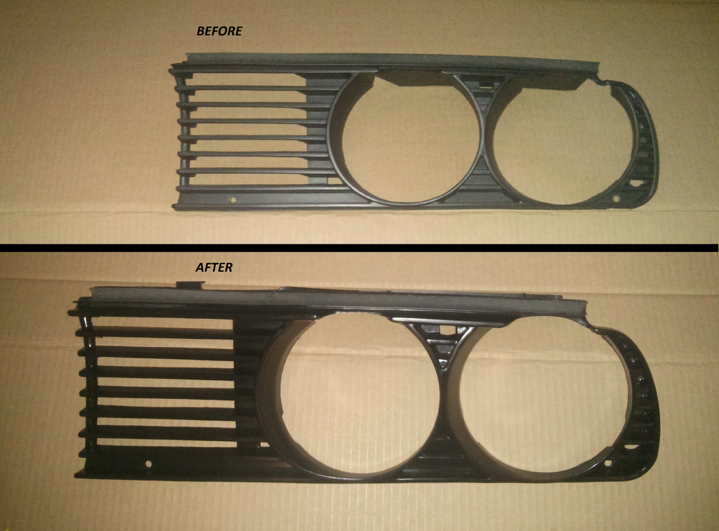

    Most of this car is still original, including all the glass, radio and refrigerant in the AC. As such plastic trim pieces have faded so I'm polishing those up one at a time. I removed 2/3rds of the grill, washed and scrubbed them with a toothbrush and dish soap, then applied 2 coats of wipe-new, the first being more generous than the second, allowed an hour to cure and then applied the second much lighter coat to even things out. The second coat made the difference.

                        The oil you're using is great and use it myself, but it will ruin your cat if you have any sort of emissions testing where you live.

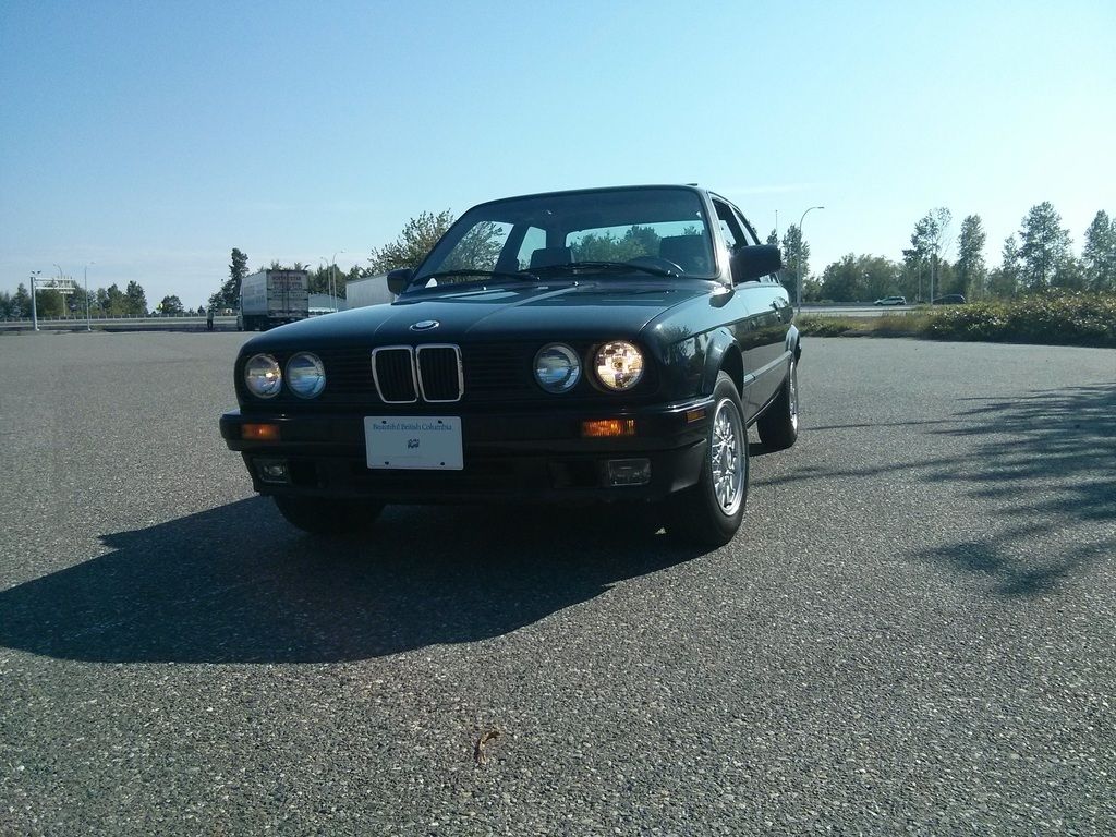

                              Polished up the middle section of the grill as well as the vents under the wipers which had faded to almost white! Replaced the front badge and the power mirror switch as well. Took some great pictures last month too, my favorites below:

                              No more emissions testing here, but I'm curious to know how it ruins the cat? Can anyone recommend a better oil?
