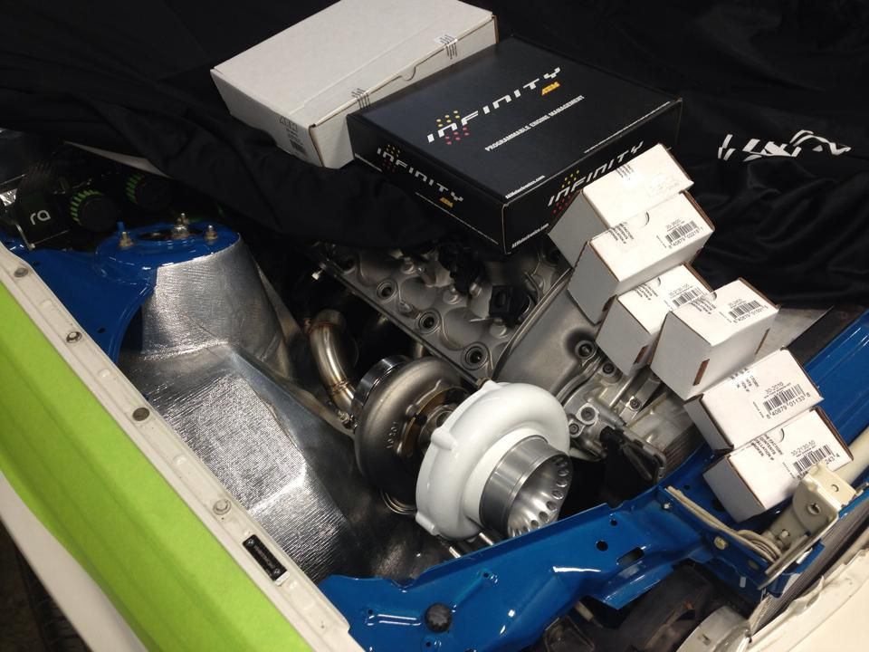

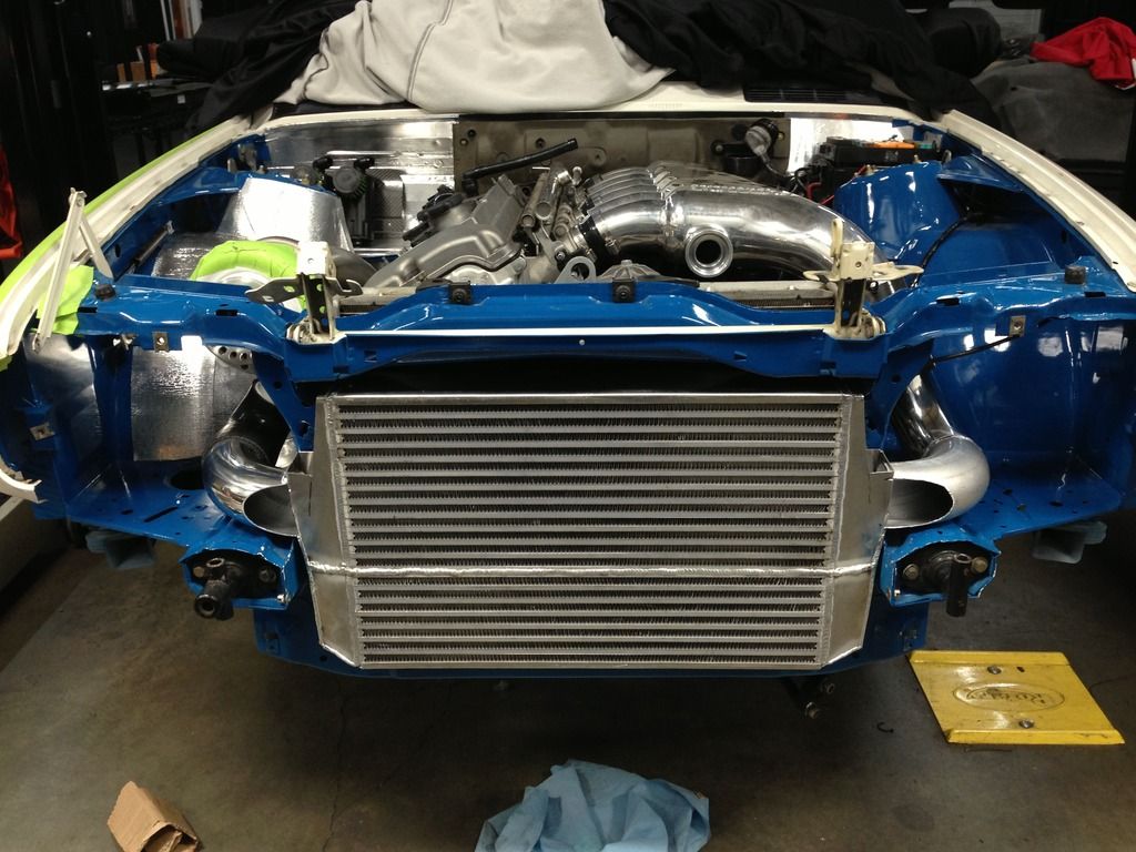

    Build - Still not done :(
    1991 325 Convertible MTech Appearance Package
    Vin Confirmed

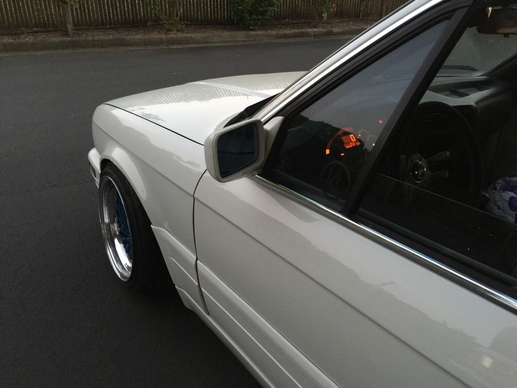

    Appearance-
    Euro Headlights
    Ryan G Splitter
    Southern Ways Epsilon Wheels 16X9.5 5X120.65
    Refinished
    Powerder coated faces
    Black Zinc Coated Bolts and Washers with Stainless Nuts
    Polished Lips
    Painted Barrels
    Falken S-Drive 215/40/16
    Adaptec Wheel Adapters 4x100-5X120.65
    Apex Racing Wheel Stud
    Rays Lug Nuts
    iS coupe trunk (No third Light)
    Engine bay stripped and Painted LSB (oem Laguna Seca Blau)

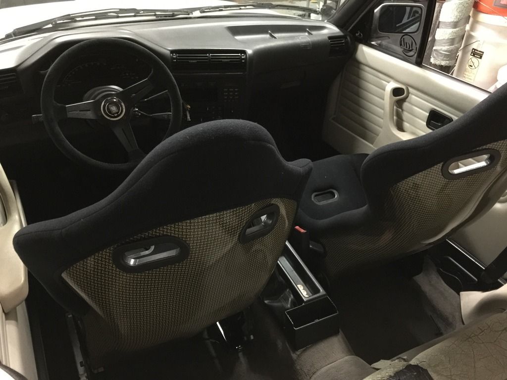

    Interior-

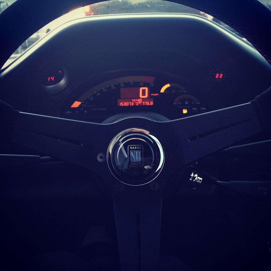

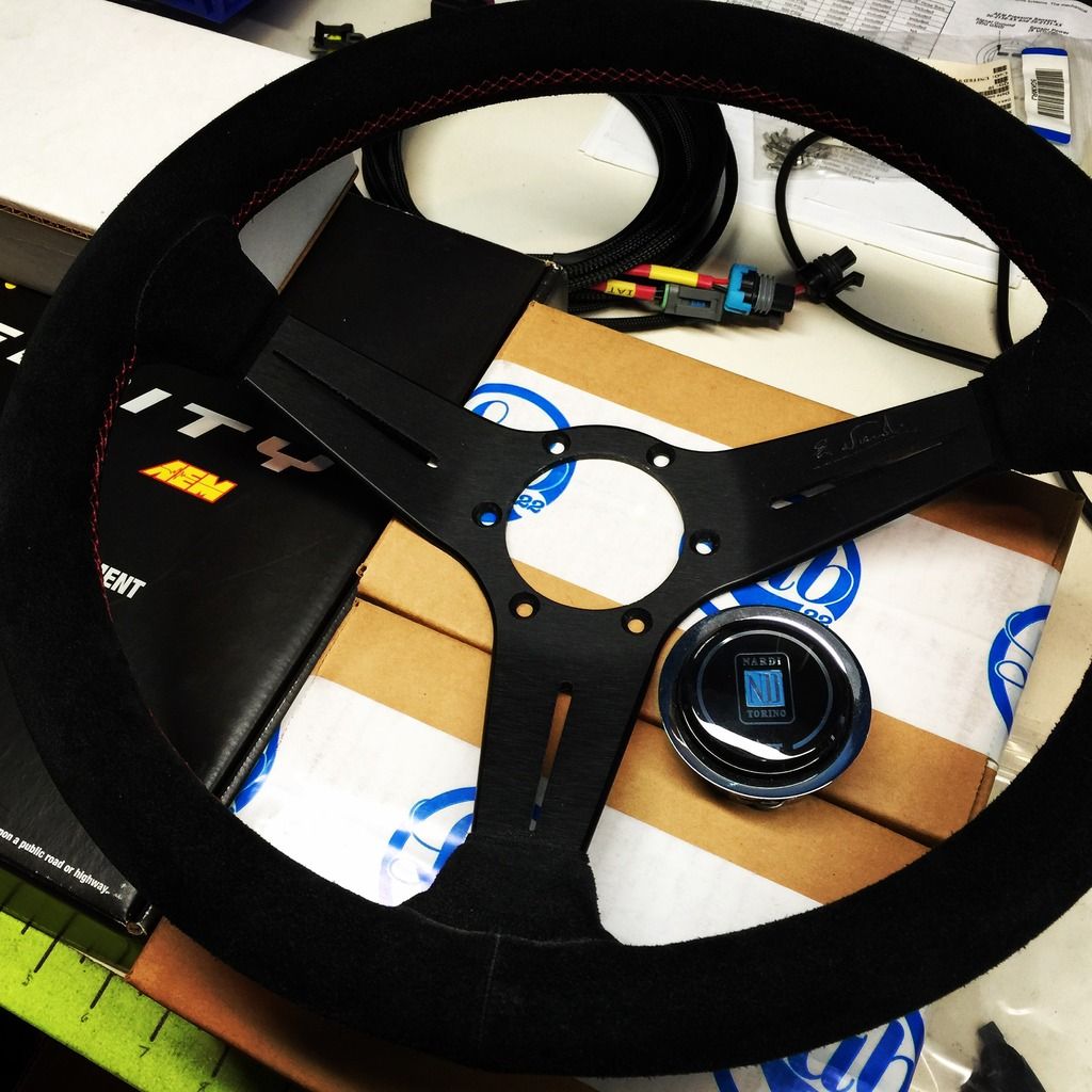

    Nardi Steering wheel

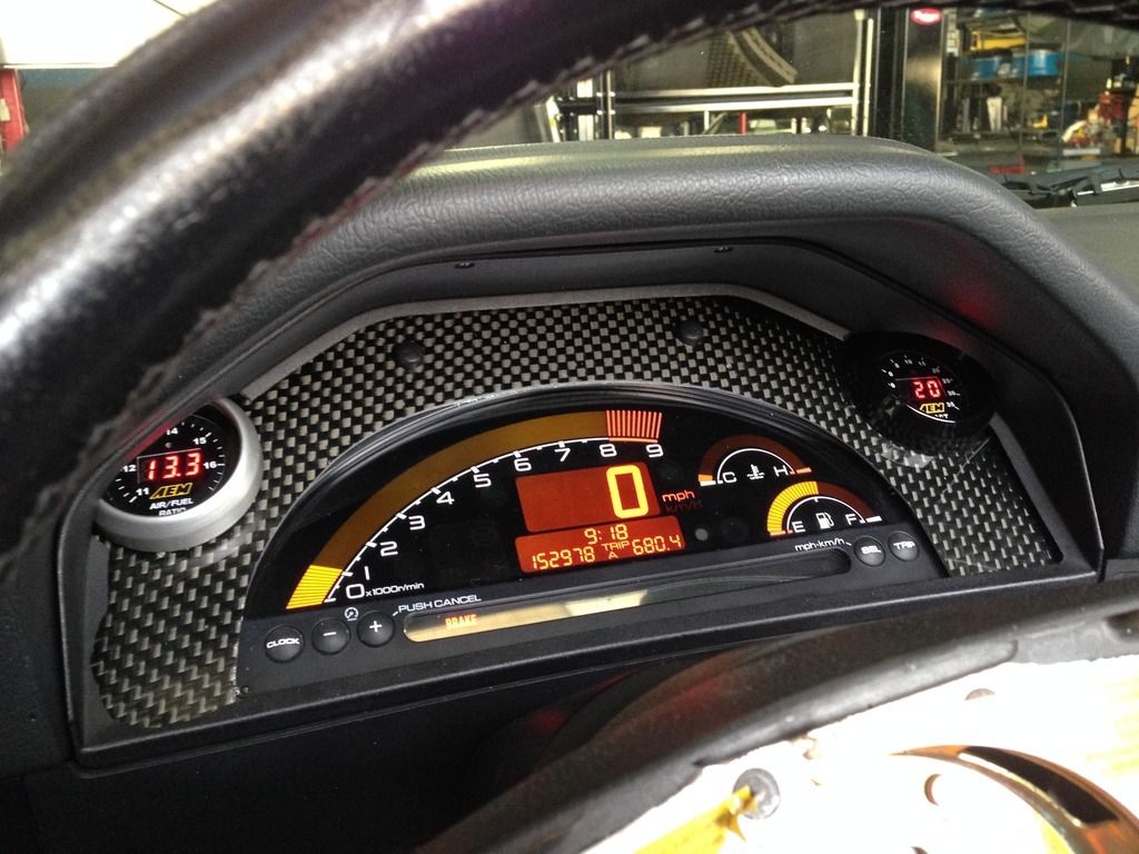

    S2000 Gauge Cluster

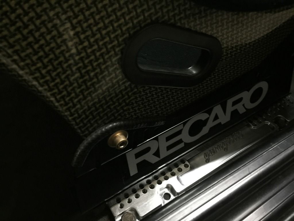

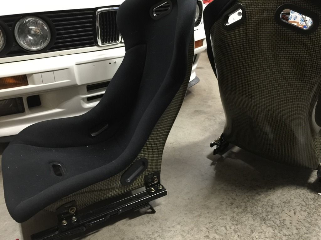

    Memory Fab Carbon Kevlar Seats
    Garagistic Billet Adapters
    Recaro Sliders
    Recaro Brackets
    No Stereo

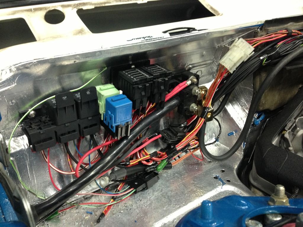

    Electronics/Engine Management-
    AEM Wideband Gauge
    AEM Boost Gauge
    Custom Multiple Boost level Rotating switch
    AEM Infinity-8 VE based stand alone ECU with Dual vanos Control

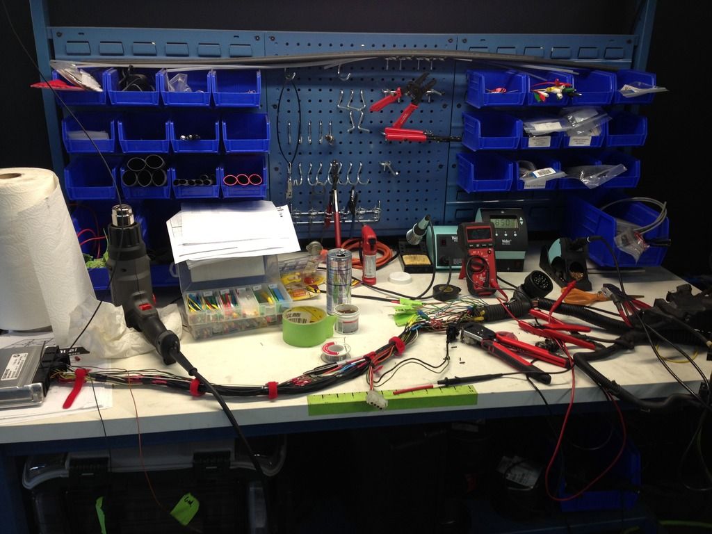

    Custom wiring harness
    AEM Wideband Senor
    AEM 3.5 Bar Map Sensor
    Custom Chassis Harness
    Fal Slim fan
    Exide Flat Plate AGM Battery
    Engine/Drivetrain-
    S54B32 Engine
    Getrag 6 Speed
    Feramic Clutch
    E36 M3 Driveshaft
    Rebuilt 2.93 LSD
    Custom ARC Asylum Subframe
    Custom ARC Asylum Oil Pan
    Custom ARC Asylum Transmission Brace
    AKG engine mounts
    VAC Throttle cable conversion
    HPF Intake Manifold
    Tial 50mm BOV
    Tial MV-R WG

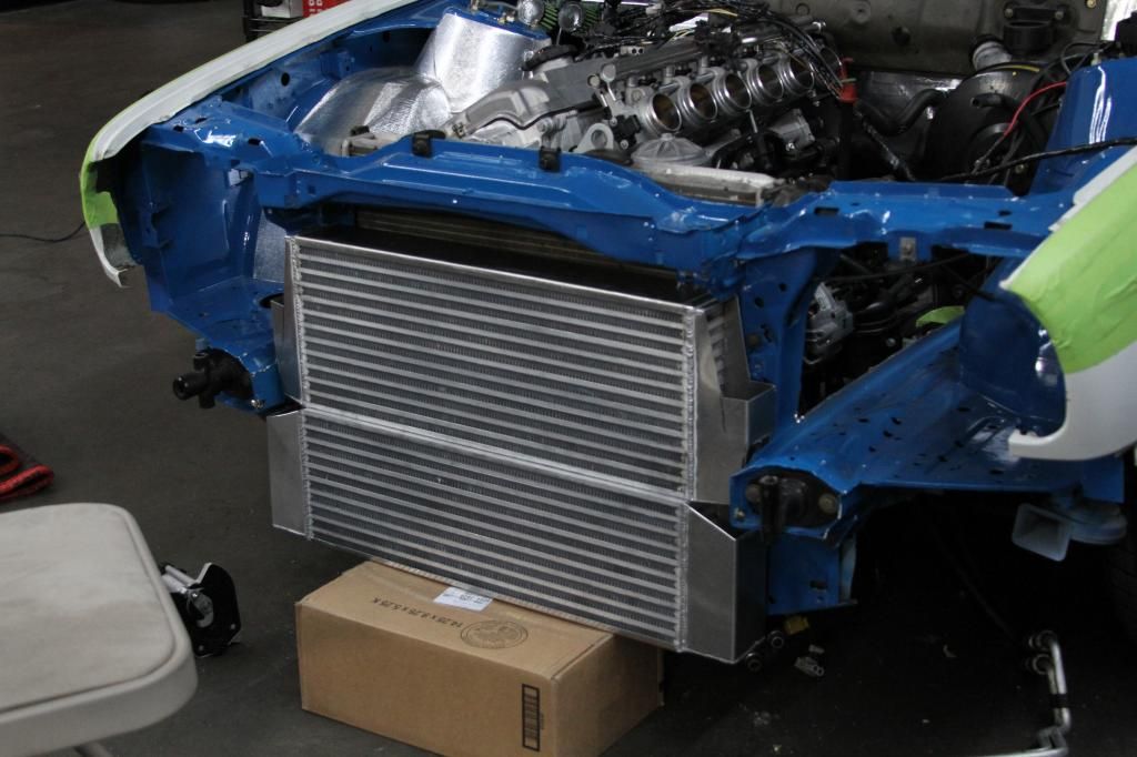

    Custom Intercooler and Piping – All brake ducts retained

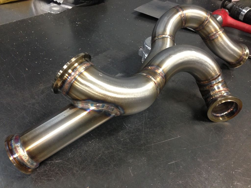

    Custom 3-Piece V-Band Exhaust Manifold and dump tube
    Precision 6266CEA Billet V-Band turbocharger
    Custom Downpipe – No Exhaust, downpipe only
    E46 M3 Radiator
    E46 M3 Oil Cooler
    E46 M3 Competition Steering Rack
    Oem Motorsport 55deg thermostat
    Oem Bosch Ignition Coils

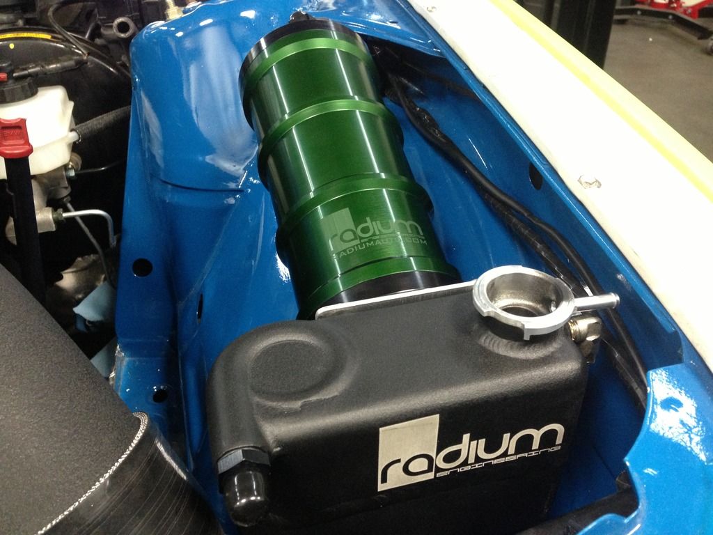

    Radium Catch Cans (2)
    Radium Coolant Tank

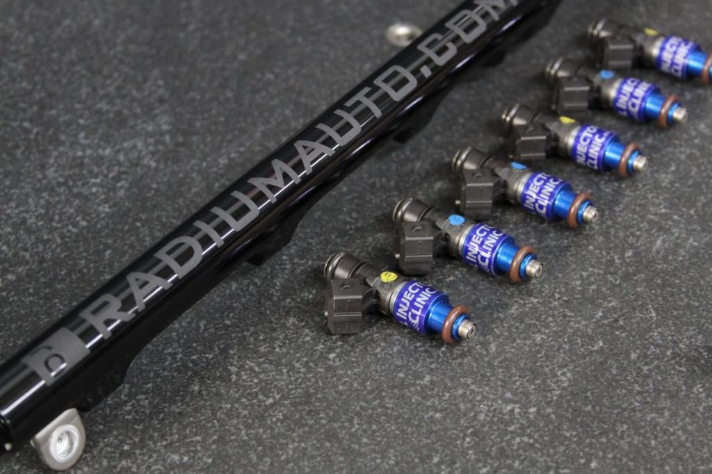

    Fuel System-
    Fuel Injector Clinic 1000cc
    Radium Fuel Rail
    AEM Fuel pressure Sensor
    OEM GM Ethanol Content sensor
    Custom PTFE Fuel lines
    Radium Surge-tank
    Walbro 400e – in suregtank
    Aeromotive 340R – in main fuel tank
    SARD pressure Regulator
    Suspension-
    GAZ Coilovers
    TechnoToyTuning Upper Bearing Hats
    TreeHouse Racing Front Lower Control arm bushings
    New Lower Control arms
