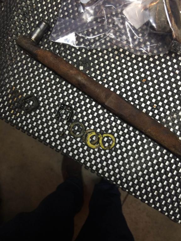

    I started by removing the shift rod, fairly simple actually. Biggest pain was those clips.

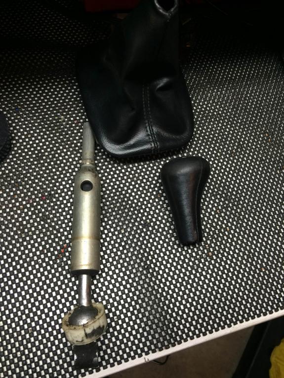

    Then I fully removed my entire shift assembly from within the car. (Forgot to take pictures of the process.)

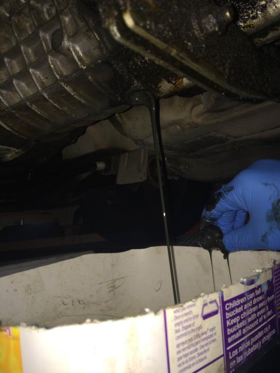

    next was to drain the transmission.

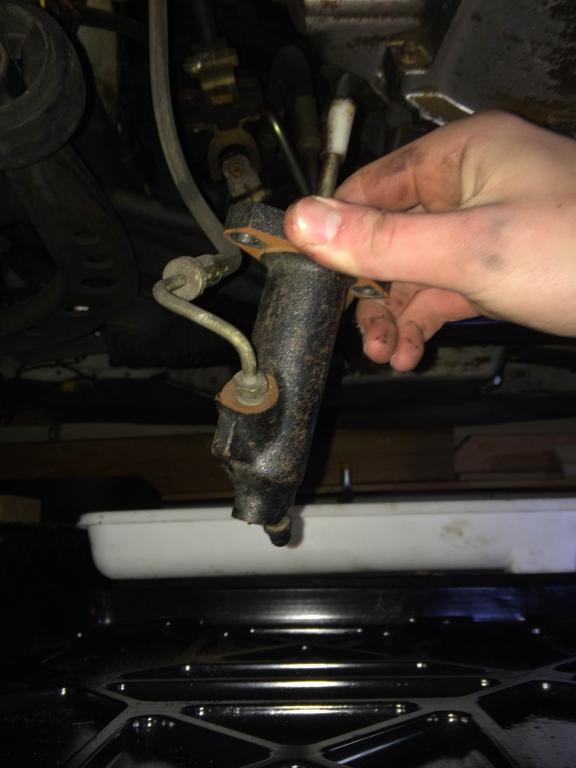

    Now to the clutch slave cylinder. I decided not to disconnect the fluid line in order to avoid disrupting it.

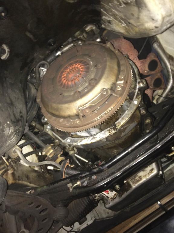

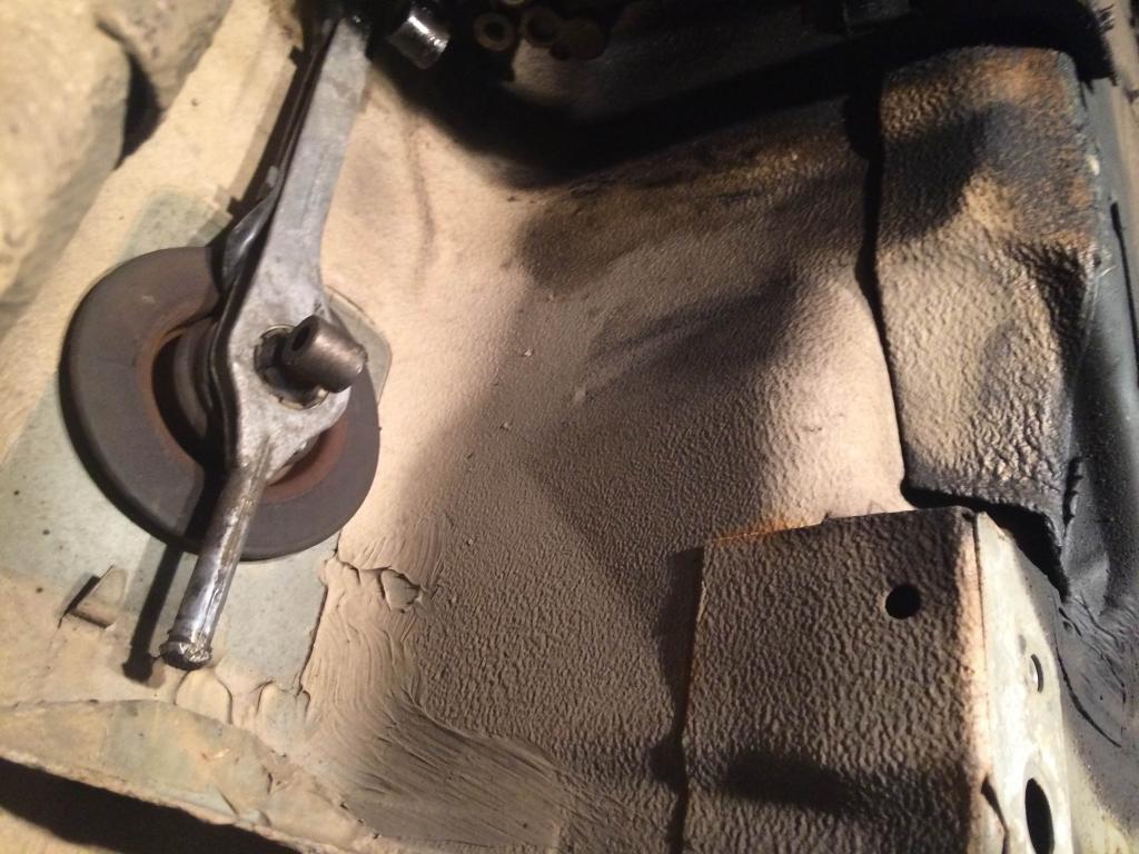

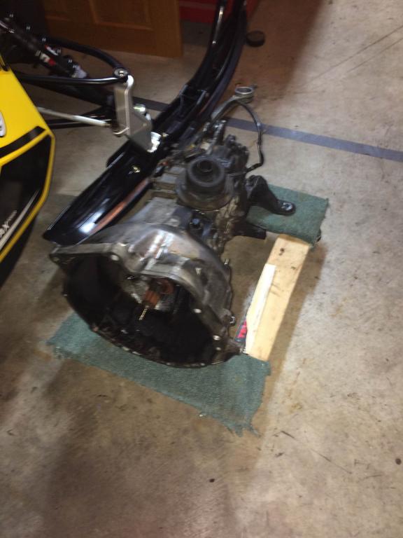

    Update!
    Transmission is out, we were stuck on that top bolt for a few days actually.
    Anyone know a good, reasonably priced clutch kit? Stage 2 ish..

      How difficult was it to remove your shift assembly? Im planning on taking my out soon to redo the bushings and install a short shift.I keep getting mixed answers as to what i need to remove before in order to access the shift linkage/assembly
          It was fairly easy for me. I used an article off of pelican. I believe it's titled something like "replacing shift bushings" The car they used is an e36, fear not its nearly 100% the same as an e30. The whole job took me about an hour including pre research and taking pictures and sorting out parts afterwards. PM if you have questions!

            Alright awesome man thanks for the advice! I'll give it a go in a couple days after some research. If I have any questions I'll shoot you a pm!
