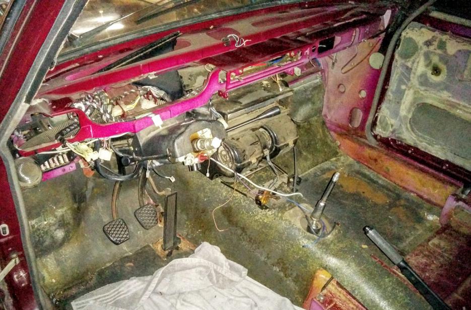

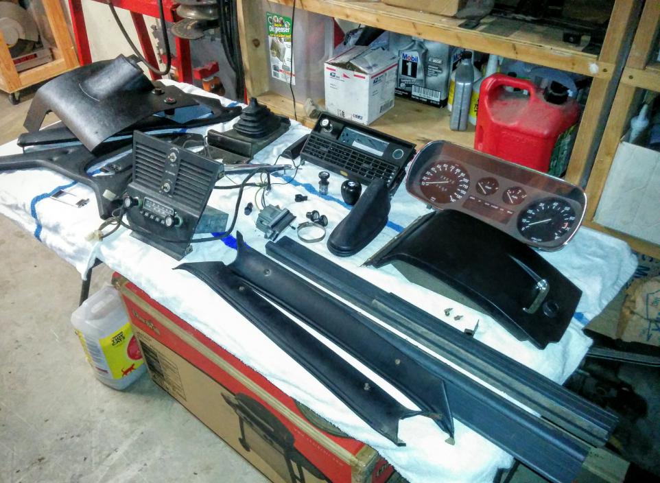

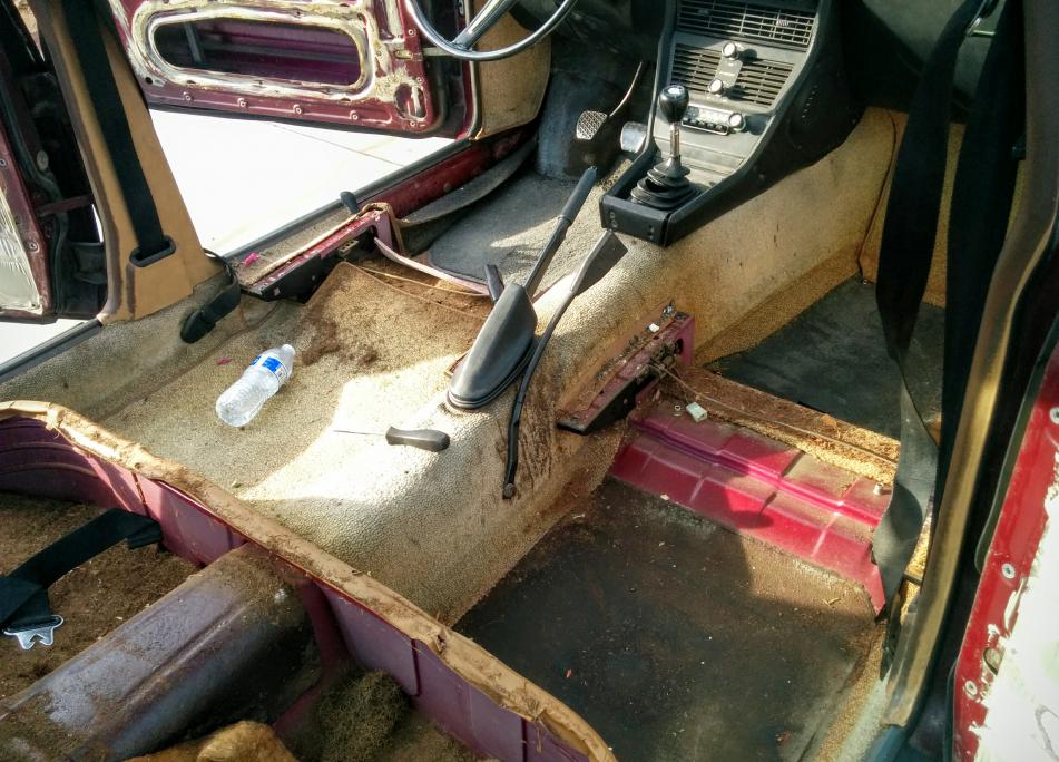

Took a while, but I was able to pull the dash without removing the windshield. For those who don't know, there are three screws that are at the windshield lip that anchor the dash down. Supposedly, you need to pull the windshield, then lift the reveal to access them. I was able to remove them after gutting the entire dash then taking a pair of needle nose to reverse screw them out.Track Car Build:http://www.r3vlimited.com/board/showthread.php?t=365614Comment

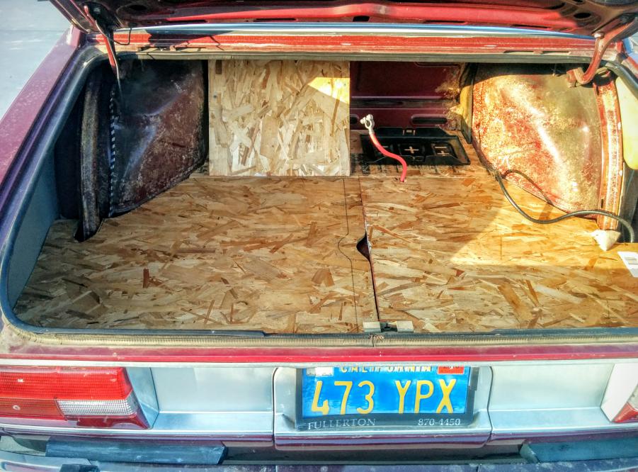

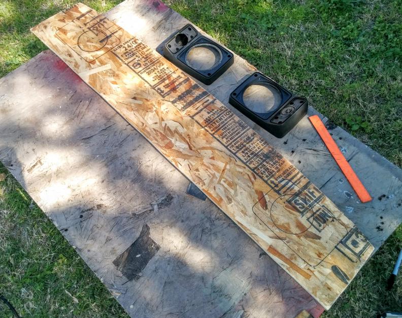

Just a suggestion but instead of cheap partical board how about about the heavier stuff that has more plastic in it to resist water. Cheap stuff loves to wick moisture.Comment
I was planning on coating the osb after I get everything mocked up. I considered going with a higher density wood, but if it's coated and wrapped it might be a waste. Regardless, at least I have a pattern, hahahTrack Car Build:http://www.r3vlimited.com/board/showthread.php?t=365614Comment
