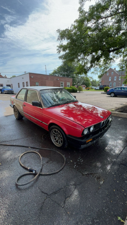

    Worked on the car a bit this weekend, got sidelined and impulse bought a truck.... New front clip is on. It is weird to see this to start to be one color again. I am stoked to finally have a oem hood latch setup too. Didn't dive into anything with the motor. Still dreading that.

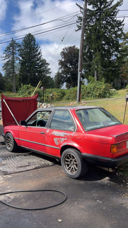

                Tried to paint the quarter over the weekend. I had some paint marked 314 bmw so i tried it out. It doesn't match to well. But it's more one color than it is two now lol. Picked up a e90 to flip,
                Wired up the E-Fan to a relay + temp probe. Kinda gearing up to pull the motor over the winter. I pretty much have beat the car the death from when i built it till now. It's been the daily, fun car a handful of times and it deff took its toll.
