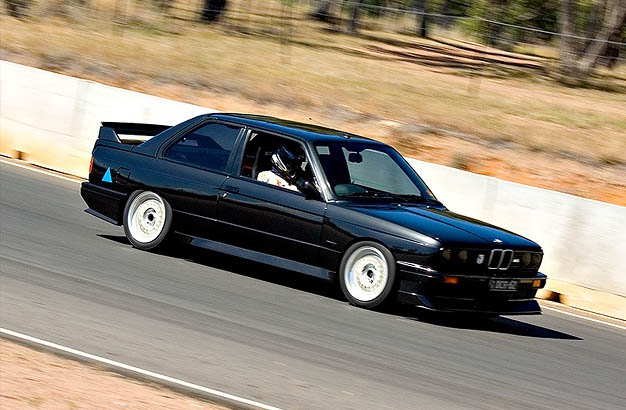

My M3 Turbo.

              Originally posted by nando
              what is the red stuff on the inside of your engine block? I'm assuming it's not just paint.
              Its called Zinc phosphate primer. Aids in getting the oil back to the sump quicker.
              Originally posted by euroshark
              Damn, how much for the pistons? Whats the bore?
              Pistons were about $900USD from Topend Performance in LA. That included shipping to me in Australia. Bore is 95mm.
              Originally posted by KevRC4130
              Awesome work, and you've got to love the "Old" license plate! :D
              Its actually QLD which is short for the state I live in, Queensland.

                thats one fucked up crank. spin it on the track?
                  Yes. During a warm up lap about 30seconds after this shot was taken.

                            Other specs of the car are:-
                            CHASSIS
                            Front H&R/Bilstein Coilovers
                            Rear Kingsprings/Bilstein
                            K-Mac adjustable camber plates
                            AC Schnitzer Front Strut Brace
                            Solo-T Rear Strut Brace
                            Solo-T Rear Shock Mounts
                            AC Schnitzer E30 M3 S3 3 piece rims - 17x7 1/2" and 17x8 1/2"
                            235/40ZR17 Yokohama AVS V102 Rear
                            215/40ZR17 Yokohama AVS V102 Front
                            INTERIOR
                            AC Schnitzer Steering Wheel
                            AC Schnitzer Pedal Set
                            AC Schnitzer Hand Brake
                            AC Schnitzer Gear Shift
                            Solo-T SSK
                            Sparco Pro 2000 Seat
                            EXTERIOR
                            Carbon Fibre EVO III Rear Spoiler
                            EVO II Front Spoiler
                            Carbon Fibre Front Splitter
                            Carbon Fibre EVO III Brake Ducts
                            Carbon Fibre DTM Cup Mirrors
