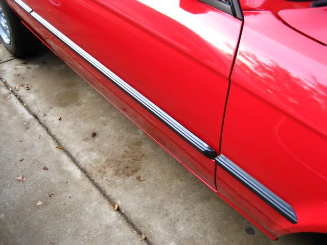

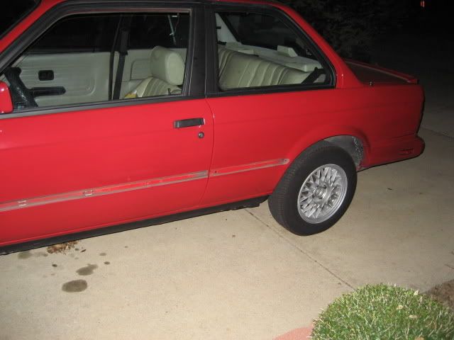

    My side mouldings were chipped to hell (well not really, but they annoyed the crap out of me), and my door handles were faded. So, I decided to finally get around to 'freshening' them up:
    Before:
    During:

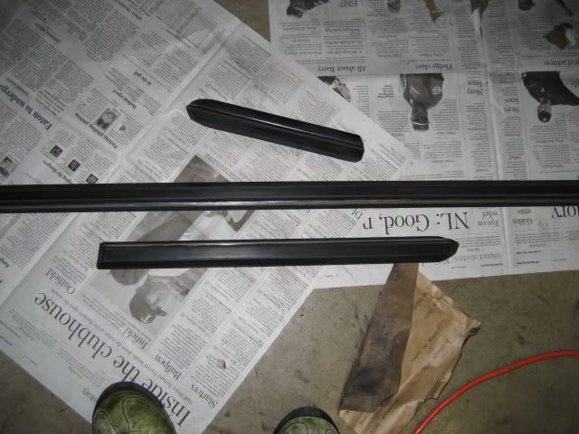

    My cheerleaders
    After:

            Thanks, I basically followed the writeup that was on this forum. I sanded them first, really focusing on the metal part. After washing them with soap, I then used a few coats of duplicolor self etching primer. After an hour or so, I then used a few coats of Duplicolor flat black spray enamel.
            I actually went back and sanded them better than what the pic shows. I'll have better pics in the light in a bit.
              Oh no...really? Shit man, if that is the stuff I am thinking of, it has basically no UV protection and will turn milky in a few weeks. I hope you used "Bumper Coating" from DupliColor, it is excellent.

                      Ah crap, Well I didn't see "bumper trim paint" but this should work. On the back it says "formulated for durable, glossy long-lasting finish. It will resist fading, chipping, stains, weather and corrosion. Ideal for cars, trailers, RV's and other auto accessories."
                      So if it craps out on me, il be pretty mad. Hoping it wont though :)
                          You probably don't want glossy for trim parts, unless that's what you're going for.
