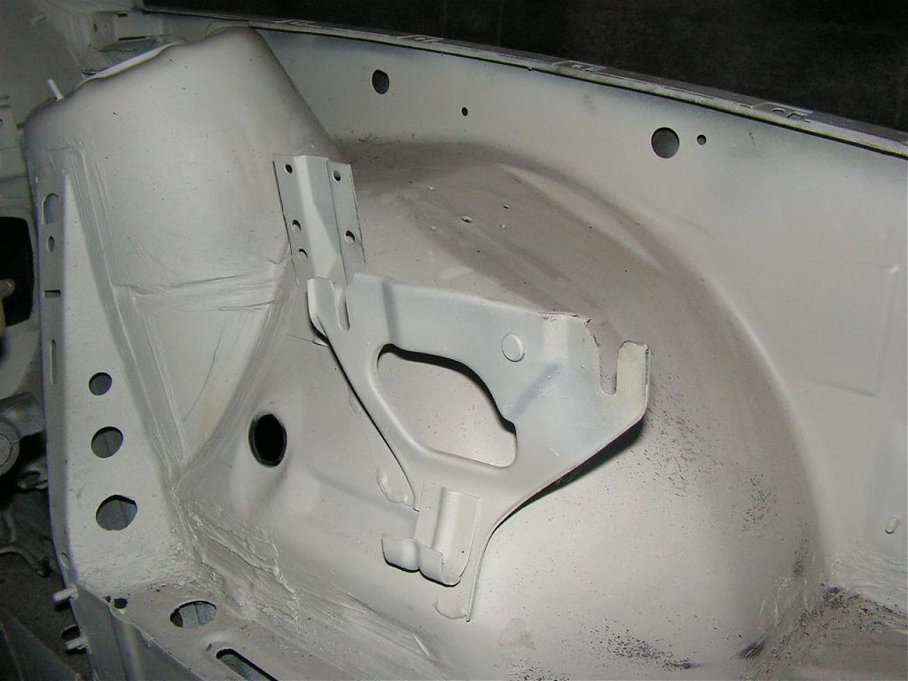

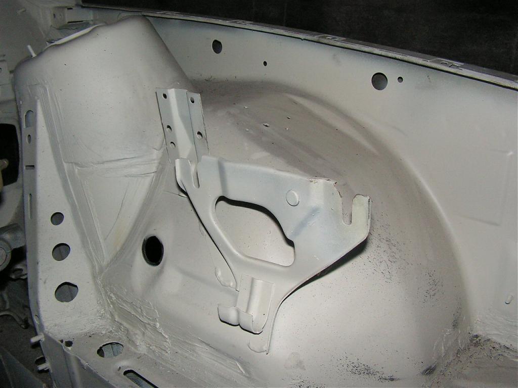

    I found that body was worse that it seemd, by now I have stripped all paint and other coatings from engine bay and front wheel compartments, engine bay is on epoxy primer and wheel wells have all new under coating.

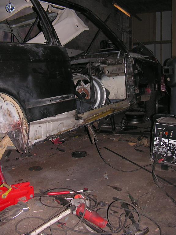

    Next step is replacing rockerpanels/sills, on the second picture you can see the passenger side rocker opened.

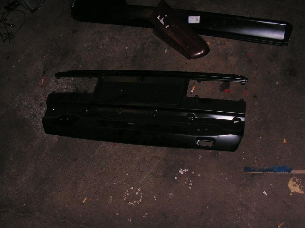

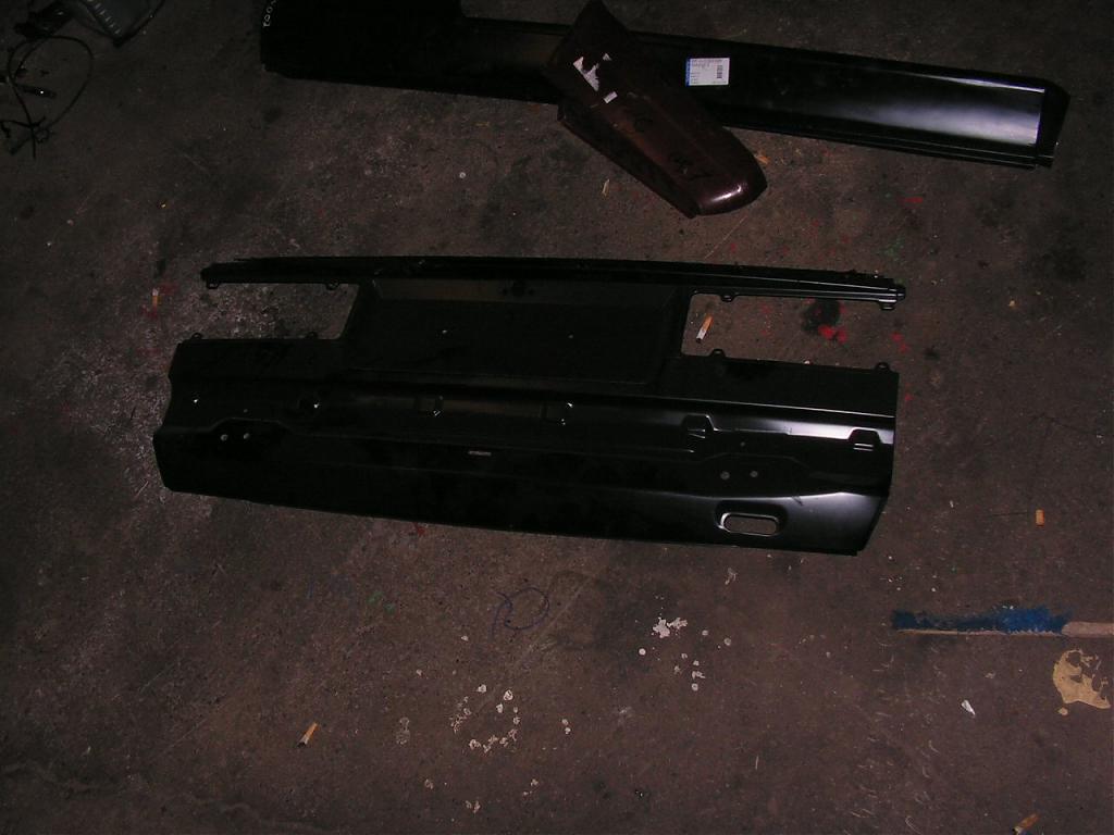

    I bought brand new oem front valace and the piece that runs between the tail light and rear apron:

            Originally posted by Ray Smoodiver
            Woah how much was the rear light piece from BMW?
            I might need a new FL one.
            I had luck and got mine from a dealer which stopped selling BMW parts, it had been laying around for years, it cost me like 30e.

              How did you remove the rocker panel from the car? Did you just cut it off, or did you drill any spot welds?

                  Originally posted by FredK
                  Hmm. I think I see 5 cigarette butts on the ground in this pic. Rocla: chainsmoking Scandinavian. :mrgreen:
                  Do you live sufficiently north so that it's dark most of the day?
                  True that, trying to reduce smokin, pack a day now.
                  On door jamb and on lower seam I drilled spot welds open, but the lower section had some rust, so cut it of later and made reinforced one. Other ares I simply cut the original sheet metal with grinder.

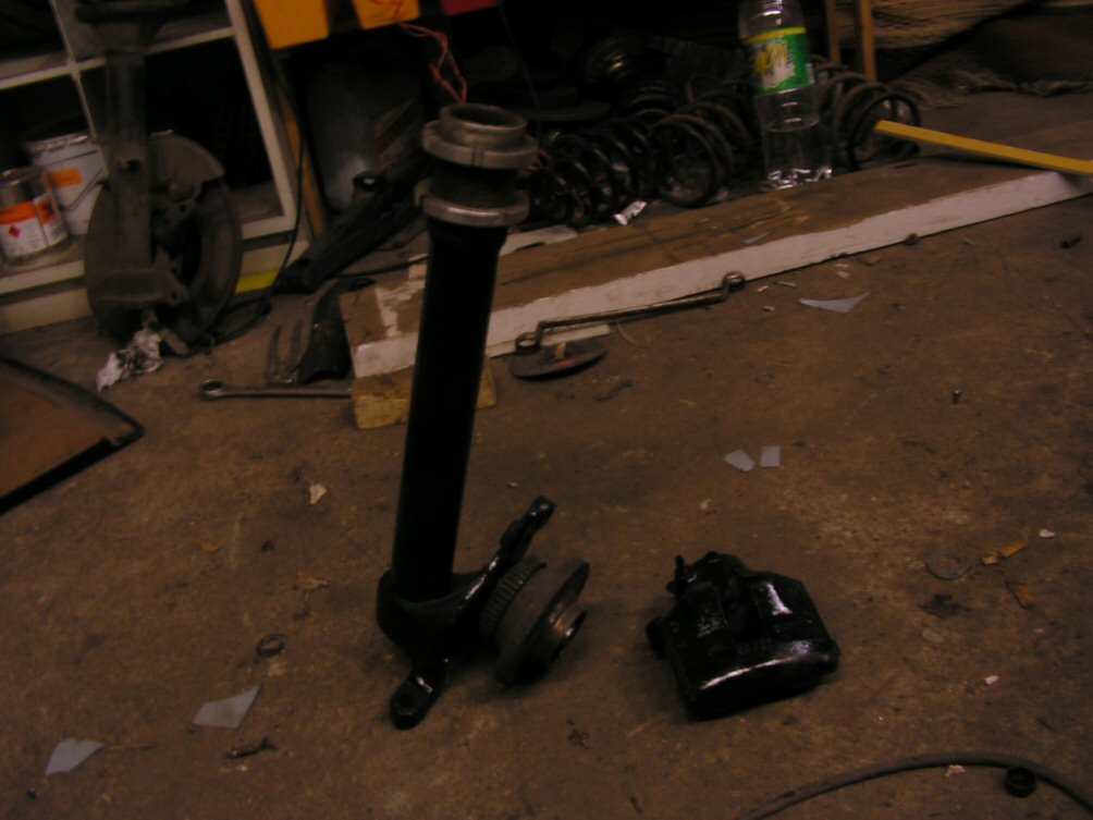

                      front:
                      DIY coilovers front, 325i struts with welded thread sleeves.
                      Camber&caster adjust upper mounts.
                      Bilstein sprint shocks, bump stops shortened real short.
                      M3 style swaybar links with 325i swaybar.
                      Rebuild control arms with polyasetatic eccentric CAB's.
                      E36 325i Steering rack.
                      Possibly hydraulic brake booster and PS fluid cooler.
                      No idea about front brakes, my friend makes very cost/efficent BBK's using VW discs and turbo Saab calipers.

                      EDIT: picture of my front strut:
