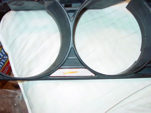

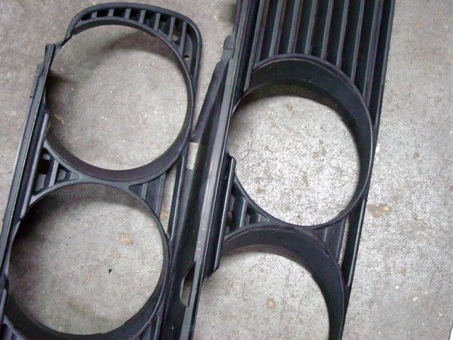

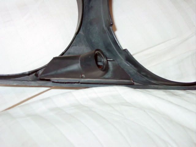

      I had to do some studying, so not much done today. Basically what I did was took my side markers and am using them for turn signals now, I can use the stock connectors as easily as splicing a wire for the 'blinking side marker' mod. ;)
      Cut out the back of the frame
      Then chop up your side markers. These aren't done, but you get the picture. Because of the shape/contour of them, theres some pretty big gaps to fill with plastic. So leave a little extra around the edges. The crack is from the bulb melting the housing!
      Then fit your lens. I used just a hacksaw and file. A dremmel might seem like a good idea, but it gets hot, melts and cracks the plastic. Not good!
      It looks like it will work pretty well!

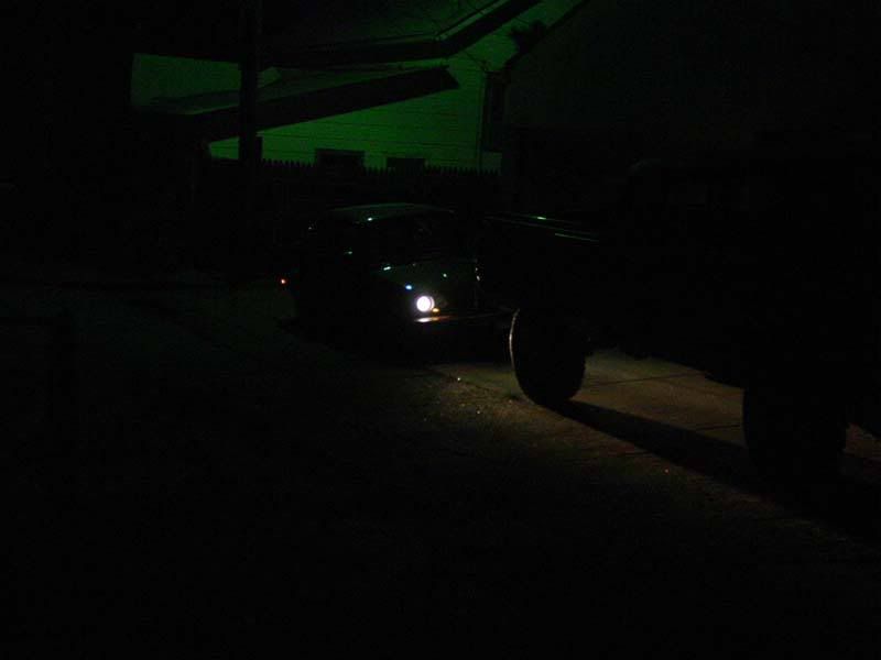

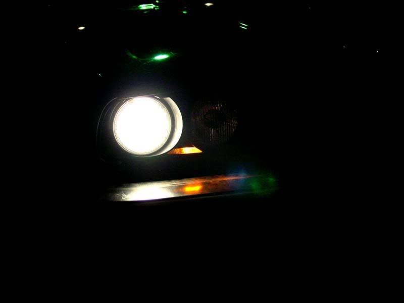

              Test fitted and even with regular bulbs, they are visible from 100' with lights on. Also very visible in the daytime. Unfortunately my camera does not like low light situations ;)

                Awesome. Well borrow a camera that is friendly with low light, and take some pictures. I'm fairly interested in that little mod, but I dont want to chop up my euro grills if it wont give a satisfactory signal.
                  Well, not very good pictures, but you can see that it is an OK signal. To gauge how it will look, you can just look at you sidemarkers. That is if you use the side marker bulbs, you could easily fit any kind of bulb you wanted into the space. ;) Also note that resistors will be required if you want 'normal' blinking patterns.
                  from about 30'
                    thats a pretty slick little mod. id smoke the lense and and cover one of the diodes or w/e on the bulb to make it turn on only when blinking. cool nonetheless

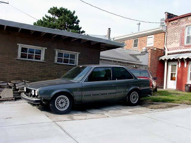

                      Bust your ass digging out dirt, pouring concrete and refilling with sod and what do you get? You get a crappy ass unlevel POS parking spot right next to the perfect concrete you just worked for. That's fine, I can see many tech sessions in this driveway's future! Car in 4x4 mode!

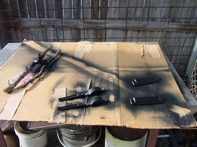

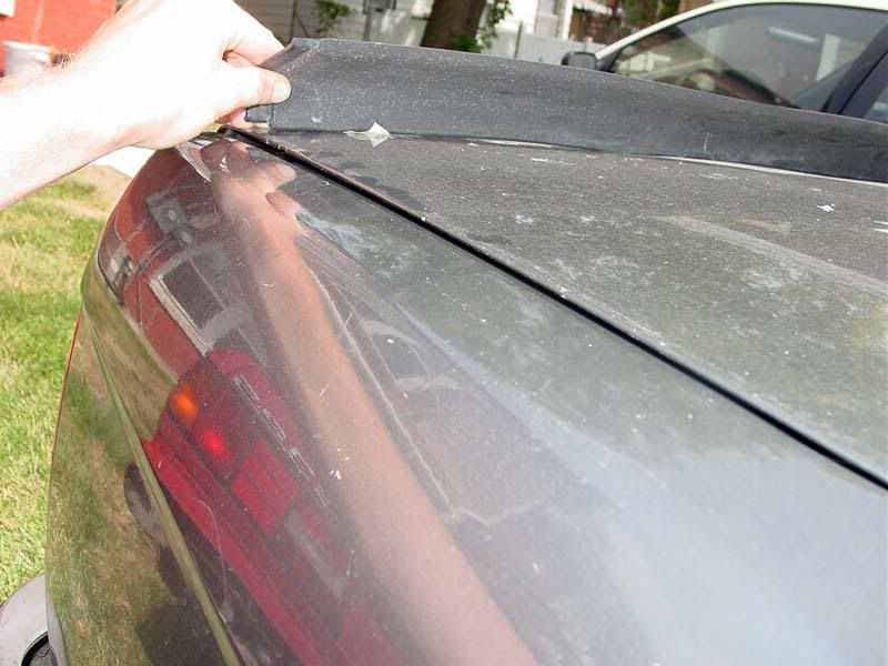

                            Side marker deletion is proving to be a little more involved than I first thought, but I'm getting there. Note, wear rubber gloves when working with urethane glue/putty. That and the stealership totally botched the order for all my clips and grommets for trim. They love it when I come in looking for obscure (not sure how they figure that, I always have part numbers) bits and pieces that amount to less than $10. My painter (teh gf) was away last weekend so not much got done on that front

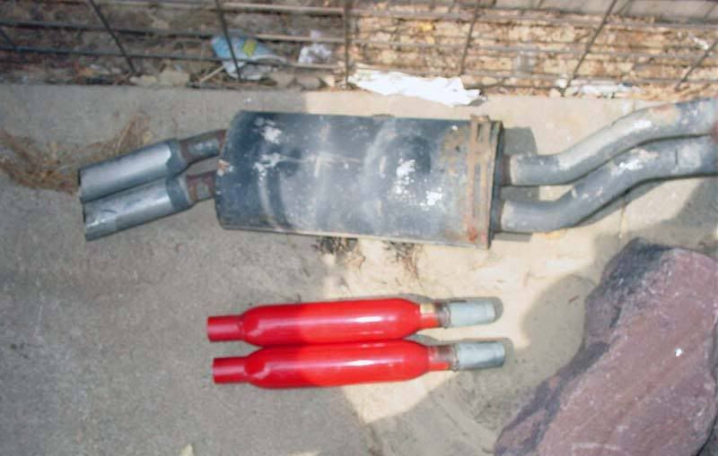

                            Today I acquired some glasspacks for free, so why not replace my rusty catback?

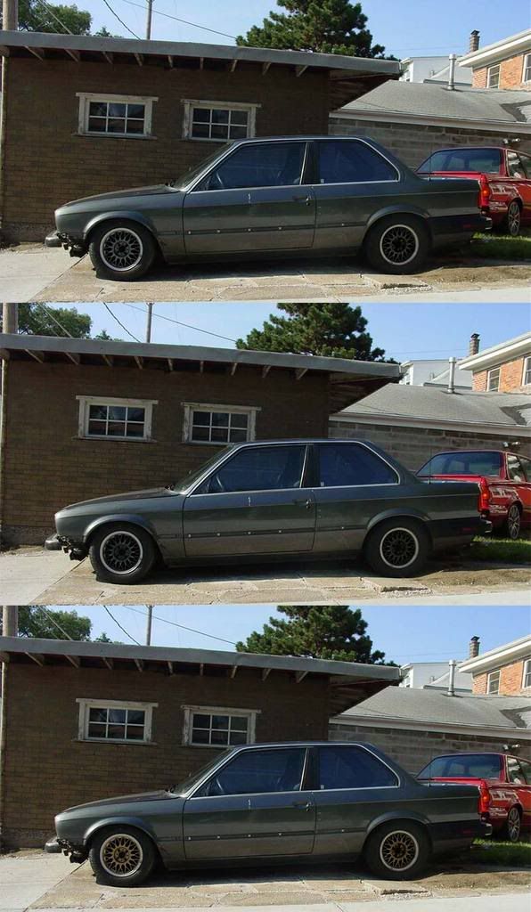

                            Next is wheel refinishing(weaves and RZ's, sorry for a mild cross post, but I can't decide on color.
                            Next obstacle is center caps for the RZ's, I think I'll just have to get a sticker shop to make some that will fit. I don't really want to rock the BBS ones, because that pretty much says "steal me please" around here.
                              What are you going to do regarding repainting? What are you going off of? I want to do my baskets during the fall.
