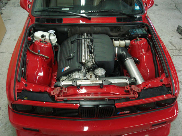

        As far as my plans, i am trying to decide on which engine to swap in. I will either go with the S52 AGAIN with some sort of FI or if i can work out the engine management i want to put a S54 in it with a six speed tranny. then of course 5 lug swap BBK ect...

          S54!!!!!!!!!!!!!!!!!!!!!!!!!!!!!!!!!!!!!!!!!!!!!!! !!!!!!!!!!!!!!!!!!!!!!!!1
          or maybe S62? huh? huh?

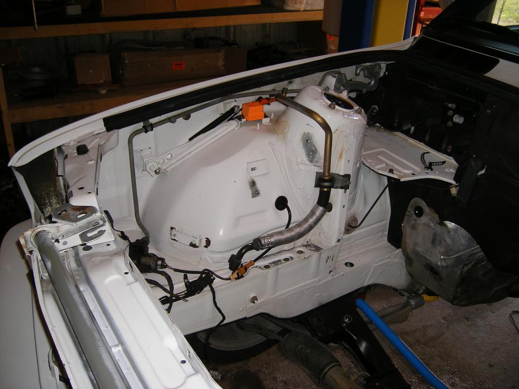

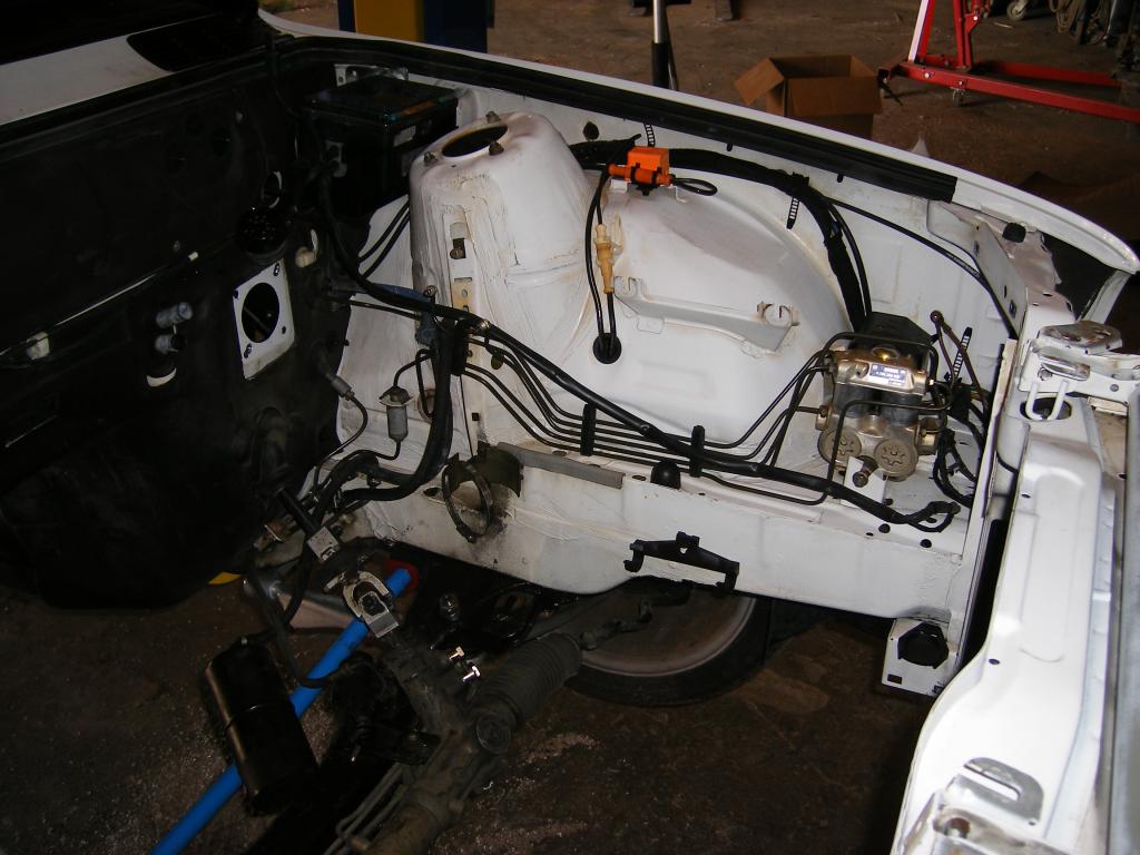

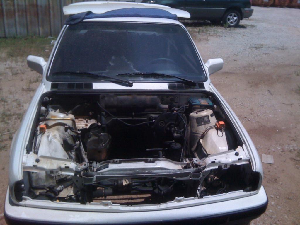

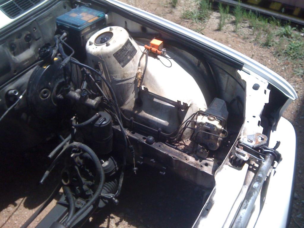

                            So much for the S54 I found a good Low mileage M52 to swap out on the car so as of this week M4TT and I started the tear down and swap out process. here are a few of the engine bay before cleaning

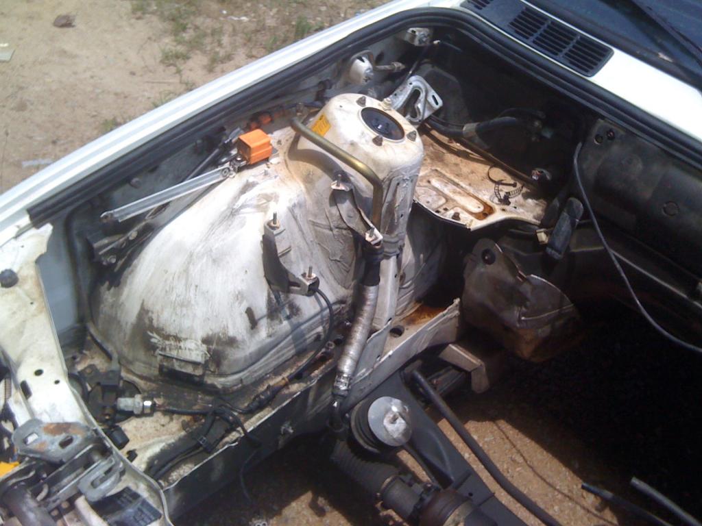

                              and after

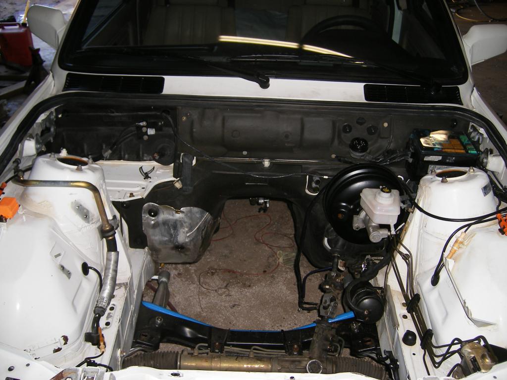

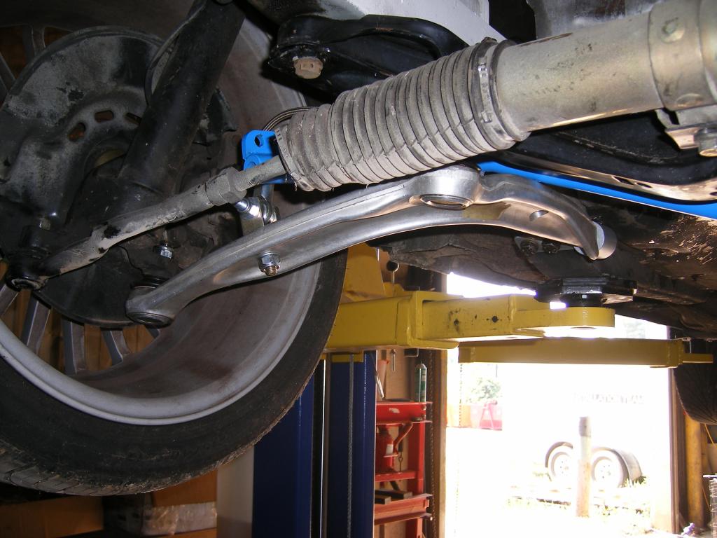

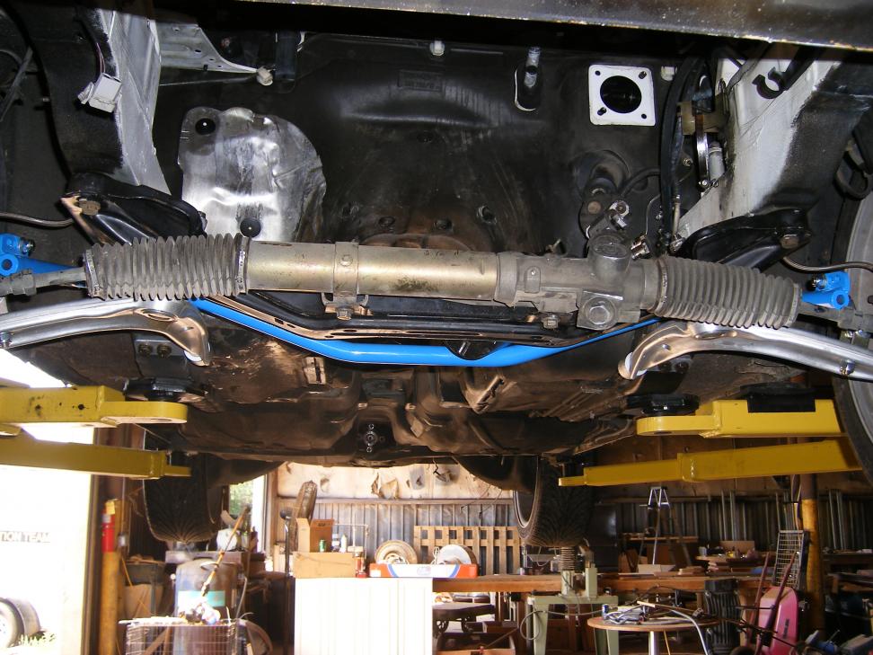

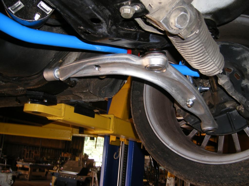

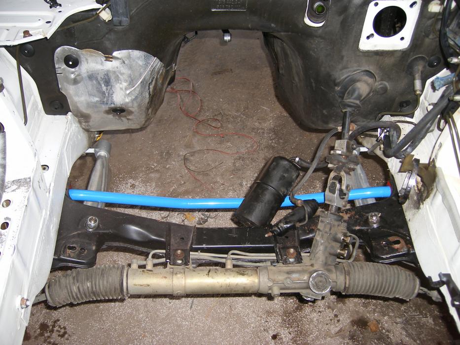

                                we got front completed with the Z3 1.9L rack, IE sway bar, E30 M3 aluminum control arms, treehouse style control arm bushings, and the modified (shortened rod and flushed) IX booster with 25mm master.
