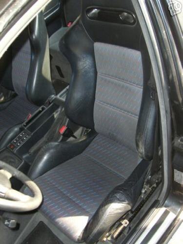

    I bought Recaro Winkelhock chairs (they are being shipping now)
