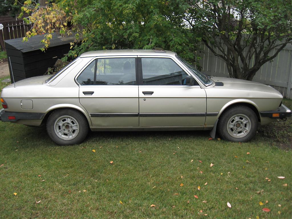

    just posting a few pics of my new ride the e28 i picked up for 500 canadian. put on the new wheels e34 15'' basketweaves 225/60/15's. few knowen problems hah. transmission is shot i only have one gear 4th. all the others will not ingage when i shift into gear just revs not even a grab. forth goes but you have to slip the clutch which i did to get it home. anyone know which transmission comes with the 1984 533i ? getrag 260/5?and a few pics of the e30. i got HandR sports matching with bilstein sports and IE adjustable camber plates.

    good score .. at least on on the body . what u might have is just a bad clutch/pressure plate

        can anyone else back this up it would be great if it was, if its in any gear but 4th it dosnt even try to grab at all its like its in neutral.any help would be great. thanks for the remarks/.

          No, a bad clutch would be bad in all gears. You have a dead transmission, and yes it is the Getrag 260/5. I'd recommend finding a 260/6 from an E28 535i to replace it. Make sure you get the driveshaft as well!
          I love E28s.
          Edit: Another 260/5 isn't a bad option as long as it has not been abused. My 533i shifted perfectly, so they can't all be bad!

            thanks euroshark, also does anyone know if these have dual mass flywheels?>

              84 you say? Probably the 22lb. one that came in the 535i also, but the build date will clarify it. The 17lb. one came in the 83 533i and M5.
              BTW, I just picked up an 83 533i with a good getrag 260/5. Let me know if your interested.

                    If you cars manufacture date is 4/1984 or later it has the heavy flywheel and should also have the 535i cam (US spec - 260 duration). If your car is earlier than 4/1984 it should have the 272 cam in addition to the lightweight flywheel. I wish I had the light flywheel to go with my 272 cam!

                      my bad the car was an 07/83 prodution date/. so i guess it does have the light weight fly and the 272 cam.:)
