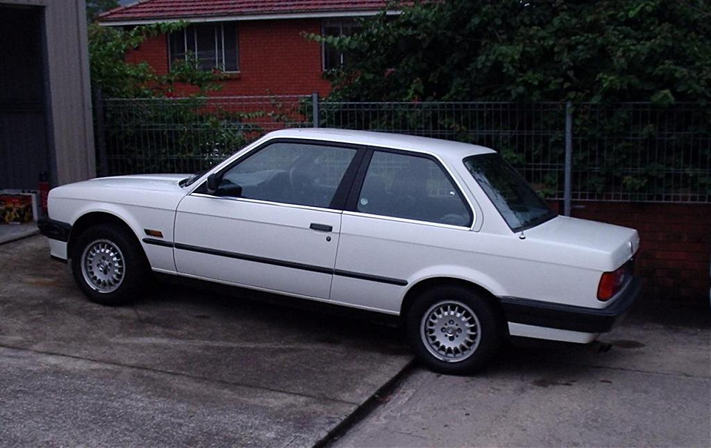

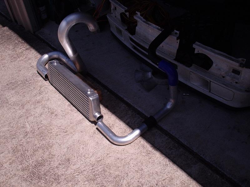

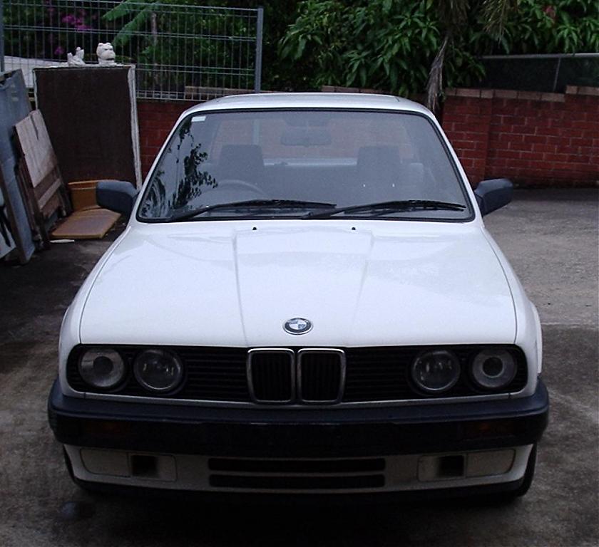

Here is my '88 320i that me and some mates did a sr20 conversion to last summer. The engine is more or less standard, i've put a front mount cooler on and turned the boost up to 13psi. I know a lot of people ask about this conversion, like is it hard to do? and what is the performance like? So here is what i think:

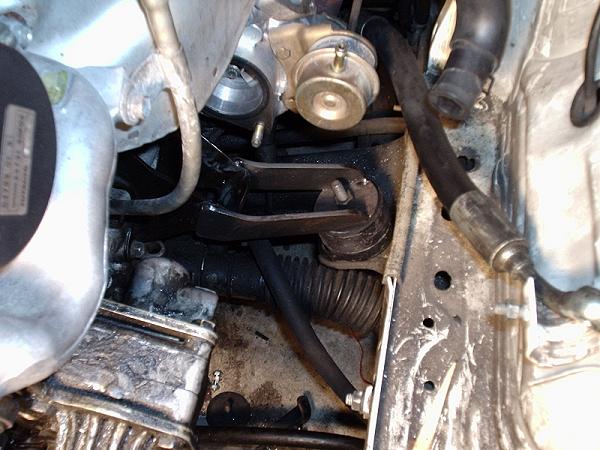

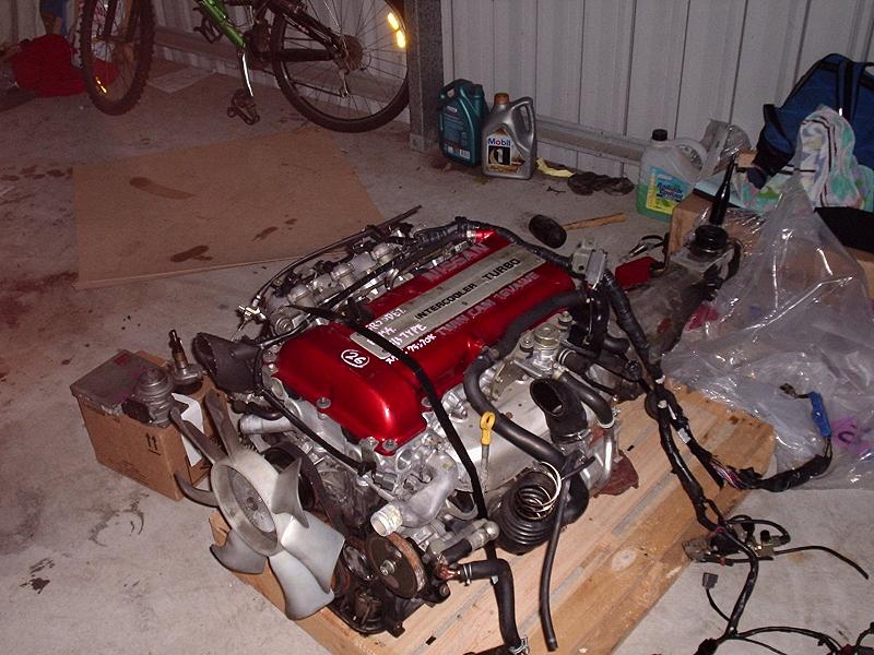

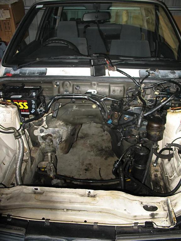

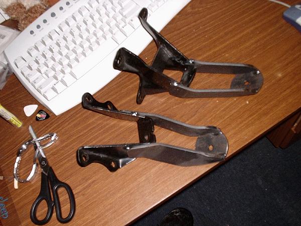

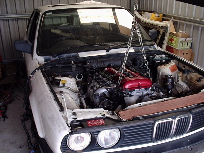

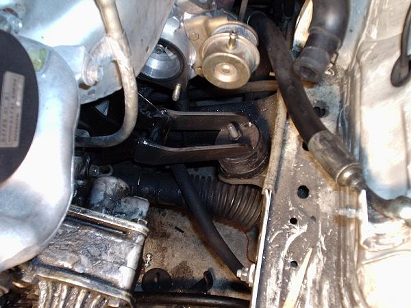

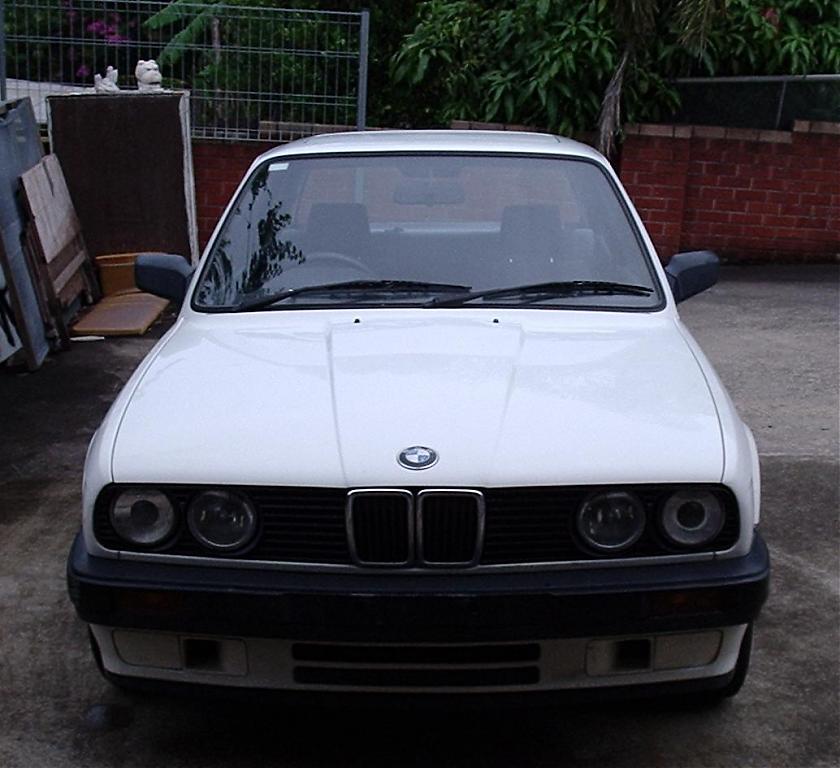

The conversion is not too difficult overall. The engine will physically clear the cross member, but fouls on the brake booster. We used the original nissan engine mounts and welded on extensions to meet up with the bmw mount points. We used an e21 brake booster and modified the pedal linkage to suit, this solved the booster issue. The drive shaft was professionally shortened with the correct spline for the nissan 'box. The exhaust is 2.5in with a single sport muffler, the exhaust is not loud at all, the turbo tends to muffle it pretty effectively. The only problem here is that the exhaust now runs down the wrong side of the car which means it hangs lower than it should. Its not a problem at the moment, but i'm planning to lower the car soon which could cause clearance problems on speed bumps. The wiring is not difficult at all... we took all the insulation off the nissan loom and laid it around the engine bay where it needs to sit. Then we cut away all the useless wires (there were a lot of them) and fed the remainder back through the firewall. The ecu is mounted in the factory position with a homemade bracket. Then connect power, start and earth to the appropriate wires and its done. I also wired in new relays for the fuel pump and coil packs. Okay, it was slightly more complex than that (getting the gauges working etc) but the wiring for this conversion was much much easier than the corolla 20valve conversion!

The car is fully engineered and road legal, i didn't have any trouble with the rego inpection, and never had trouble from police.
So there you have it, it reckon its a brilliant car and i'm perfectly happy with how it turned out. I was quoted $15K (aud) for a drive in drive out conversion with this motor, i have managed to get it done for $3.5K by doing most of it myself.
