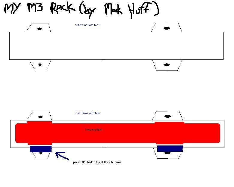

            Originally posted by vlad
            how hard id it to install e36 rack and do you notice the difference?
            Well, it was pretty easy in the end. For once, having an airbag car really helped!! With the firewall, all I had to do was grind about 1/8 of an inch out of the steering colum hole. I was able to still use the stock rubber boot. The airbag cars only have one universal joint on the steering kuckle and has a colapsable steering column.. So all I had to do was give the column a little room through the wall. The angle is more straight to the steering wheel than stock now!!
            The M3 rack (at least the 1995 one on my subframe) is shorter than the stock one. That is the tabs on the e36 will not fit into the e30. So, after qiute a bit of mock ups, we went with spacing the rack to fit into the top of the sub-frame. This makes the rack paralel to the control arm. I made a crappy drawing to poorly illustrate my point.
            I used the e36 tie rod ends due to them being straighter than the stock e30's. So in theory, now with the car lowered, my tie rod ends are parallel to the control arms. This should provide an even more aggressive angle for steering response (along with killing some of the angle from the steering wheel to the rack).
            The entire conversion took a single morning. Well, the motor and tranny were out of the car. I make people drive my car to really see the difference... It's pretty freaking amazing. It's an OBSOLUTE must for a track car. If you have any other questions, just let me know. I can shoot some photo's (or make some more MS paint drawings!!).
