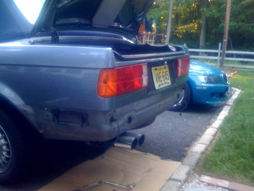

    Had a bunch of non car related errands today so didnt get much done. Removed the rear bumper(man what a pain, I guess it would have helped if I took out the exhaust to get to the 3rd 13mm holding the bumper on)
    After I removed the bumper I cleaned and waxed it since more of the rear is going to be showing and wanted to get to it while it was easy.

      Good progress on the bumpers. In case you don't know, the holes from the rear DB mounts are going to be visible under the rear euro bumper, and water will go into them. It's best to either cover them up with something or weld them shut.

        Yup, still trying to figure out what to do with those holes, will most likely just put some sort of rubber stopper to seal.

          I just had the body guy patch those holes, was pretty easy for him cause it then got covered up with the bumpy, chip guard finish to match the rest of what is going on under the bumper.

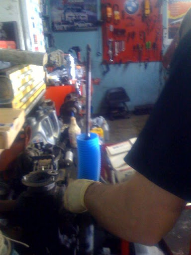

            Suspension(HR sports with Billy Sports and Rogue Engineering Shock Mounts)

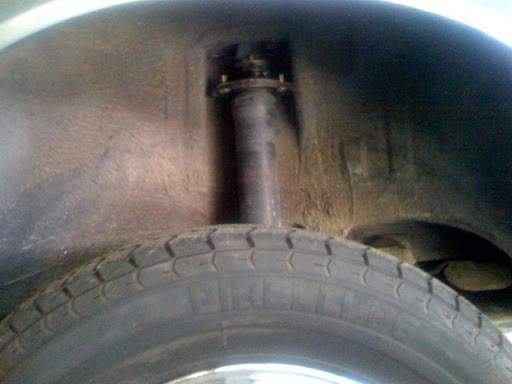

            Here is the stock look.
            Stock rear shocks with some sort of aftermarket shock mounts.

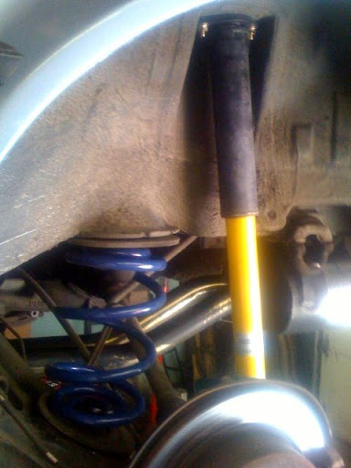

            Rear springs in
            New rear Springs, shocks and shock mounts in.

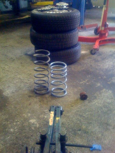

            Stock vs HR Sport
            I thought you guys would appreciate this pic. Its a factory tool. Screws on top of the front shock so when the spring is compressed it stay centered and does not move around. Makes the install easier.

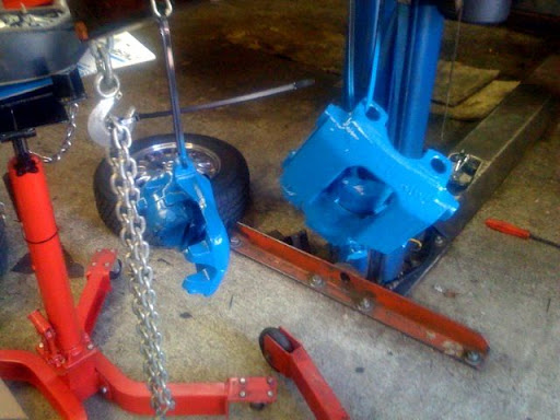

            Since we had access to them and they were in such good shape, figured it would be a good time to paint them. I cleaned them and prepped for paint. Julien knows why they are this color... Hint check my user name.

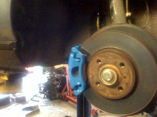

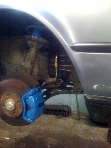

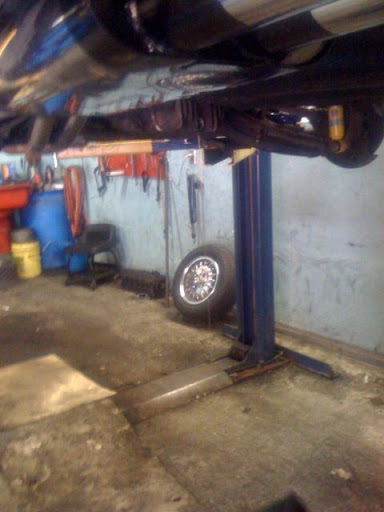

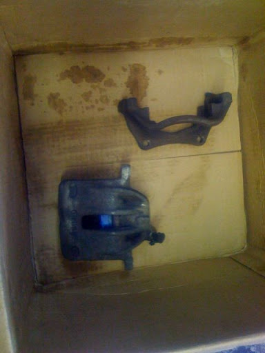

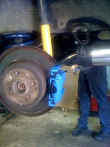

                Caliper installed along with SS line
                The underside lines were a pain to remove... But we got them out.
                On to the diff fluid change.
                Painted the rear brake clips black.
                Look down under
                So here is the end result, it will settle a bit more. Took it for a test drive. Very happy with the end result. Stock felt like I was driving a boat, during acceleration and braking it felt like it was very top heavy. Didn't feel confident in turns at all. The car now feels tight and steady. I had the HR Race on the coupe and glad I went with the sports on the vert.
