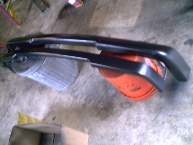

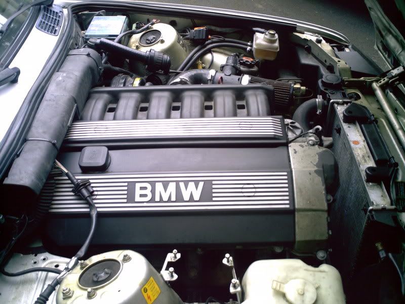

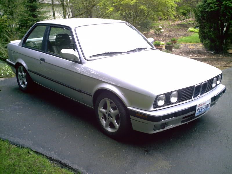

    Figured I haven't posted pictures in a year or two so I'd take a quick picture while my dad's car's out of the garage for a few minutes. Also took a pic of the latest work to the e30 and the lips I've collected for the e30. Got the Rieger fixed from when Funk and I broke it and then picked up an IS lip from JRHaile. Thanks again to both of you for the help with the m50 swap. I appreciate all of the help.
  • BBY1104
    That is a total sleeper! Loooks pretty good to1

        What did you do about the brake fluid line that goes to the clutch?
        I see two rubber hoses going to the reservoir but can't really see anything going to the clutch!
          I got the 530's clutch reservoir. Its a little one that I tucked up next to the wiring under the harness cover.
            Can't go wrong w/ the galaxie's. 60 starliners are gorgeous I must agree. This one though was bought from dealer with no options besides the am radio and the bucket seats, a 390 big block, a 4 speed and a 9 inch rear axle. Was one of around 400-500 made with the 4 speed bucket seats combo.
            Have a p/n for it :)
            I may need to use it depending on how I mount my reservoir.
              It would be P/N 21521117729 and its a e34 530i. I got the master cylinder remote reservoir from same model, but I clipped the lines and did different lines to it because the factory ones are the hardened plastic so you can't bend them out of place easily.
