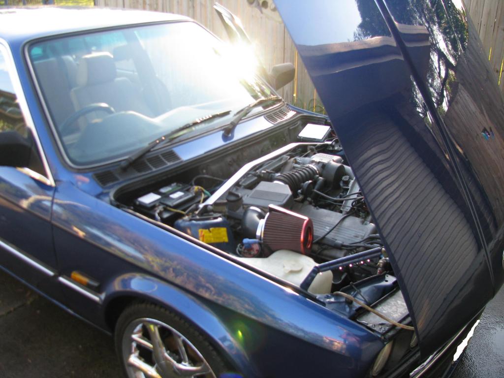

    hey guys,
    here are a few pics of my E30 that started life as a 318i.
    list of mods: fully rebuilt M30 out of a E28 motronic type
    265 getrag gearbox
    shortend tailshaft
    E36 diff centre 3.45 ratio
    disc brake rear end instead of the factory drum
    525i brake booster and 325i master cylinder
    brand new discs and pads all round
    power steer conversion with the alloy type rack
    pod filter
    2 and a half inch exhaust system with no cat convertor

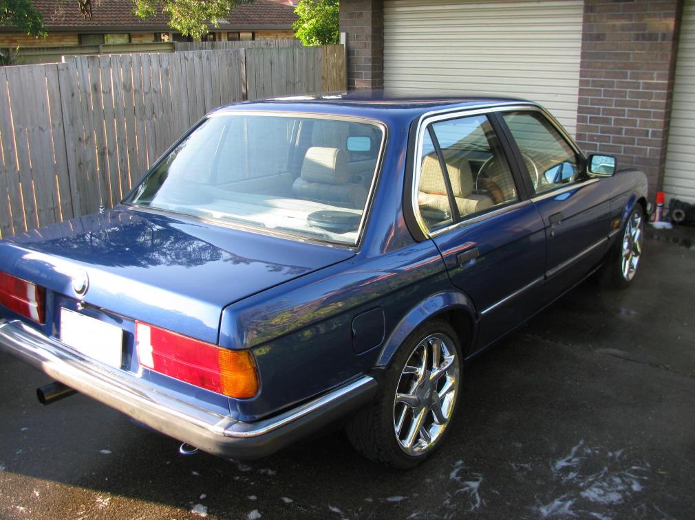

    looks good other than the rims
    • B2702
      • Jun 2008
      • 293
      The rims gotta go.
      • e30m30power
        • May 2008
        • 18
        hey, yeh trying to find some new rims at the moment but finding it hard since most of the 4 x 100 rims here are front wheel drive offset and need massive spacers

          nice car, but even bottlecaps are better than those.

            The wheels kill it, bottle caps are awesome.

              yeah man i agree with everyone else. ive seen those wheels on civics n crap, they dont belong on a e30. just get some standard 15'' meshies. fantastic everywhere else though!

                roll on the stealie wheelies. way cooler than that chrome shit right thur.

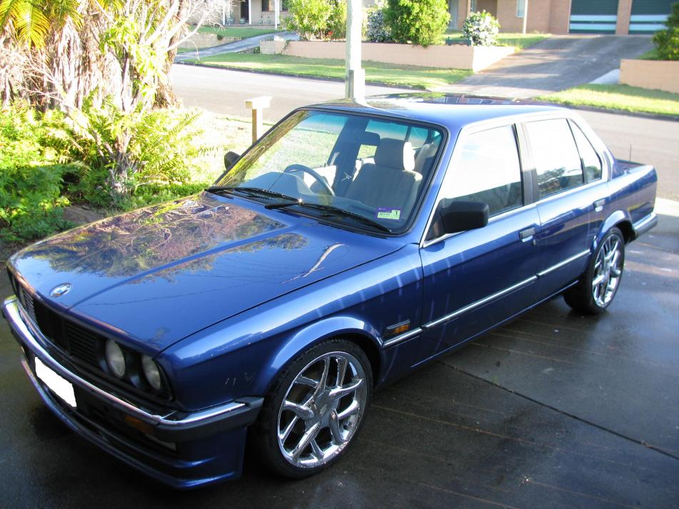

                  car looks nice. what color is that?
                  I like the wheels, are they old skool NEEPERS?

                    Car looks hot minus the wheels.

                        Wheels are terrible. Nice car otherwise. Ever thought about an mt1 kit?

                          its montego blue which is a factory colour off an E92 i think it is.
                          i just have the front spoiler at the moment that has the factory writing inside it not sure what type of front bar it is though.

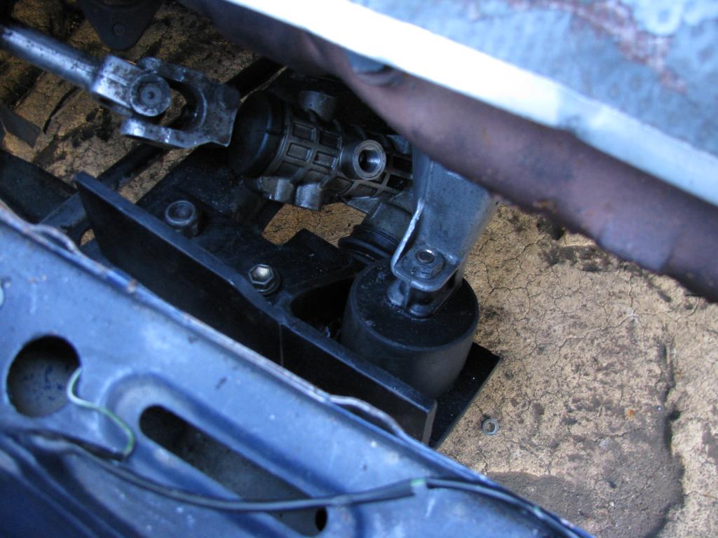

                            hey, when i did the m30 swap i looked around at all these mounting arms from all the bmw online stores and ended up making my own and never had any drama and cost alot less then the mounting arms you purchase.
                            heres a pic:

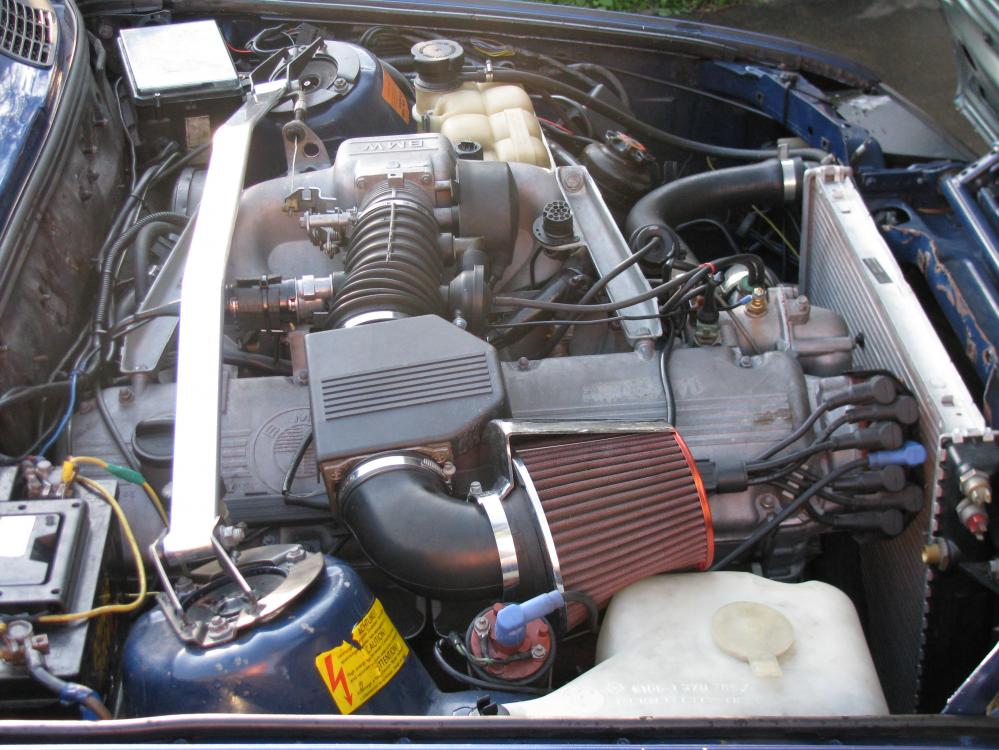

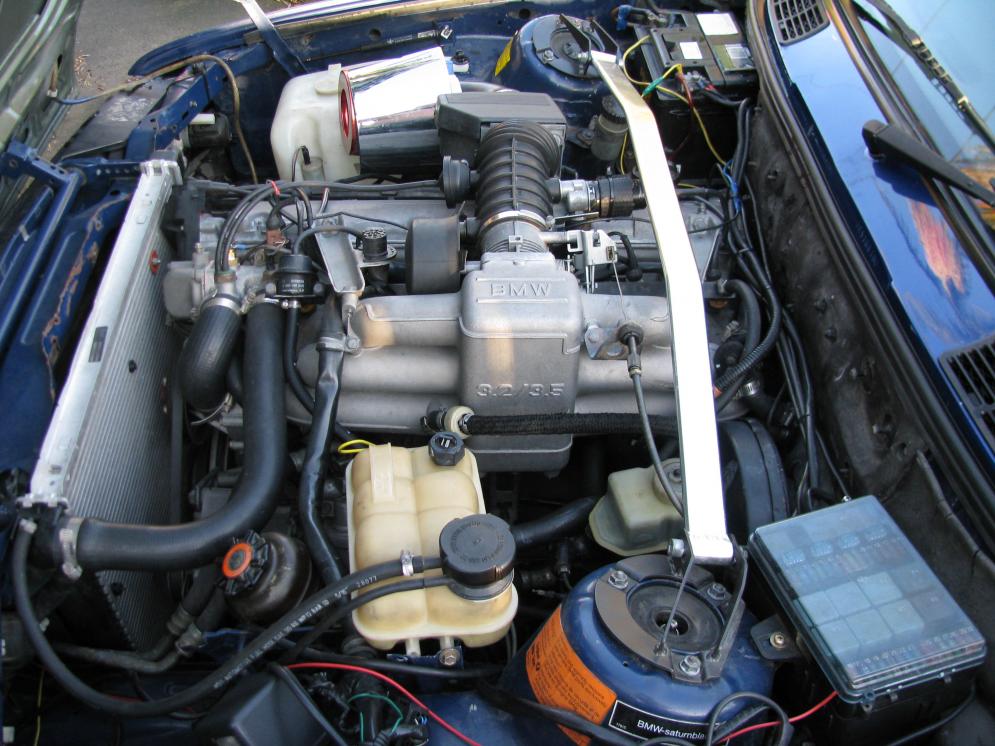

                              your CAI is just sucking in hot air. isnt the stock air box better than one of those cones?
                              i know on m20s for our cars a lot of people say that the stock airbox is designed great so theres no need (unless you want sound?) for a CAI.
