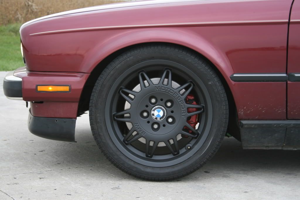

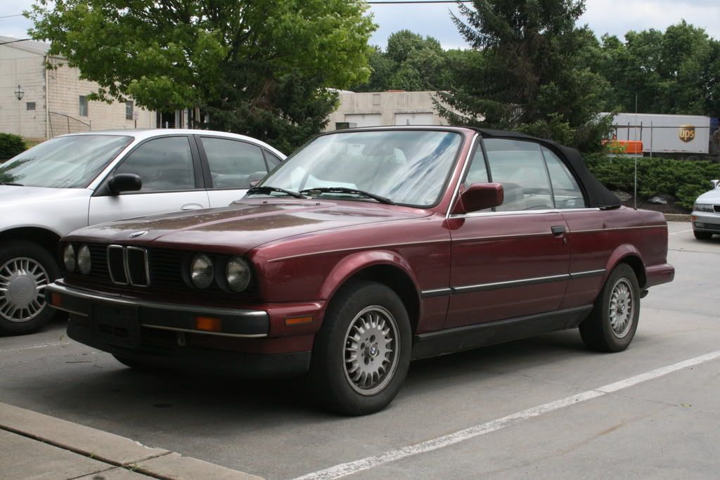

    Just wanted to share pictures of my current project. Its a 1990 cabrio. It is in pretty bad shape but she will slowly come around. It would help if I had the paper to throw at her but unfortanately I'm on a buget.

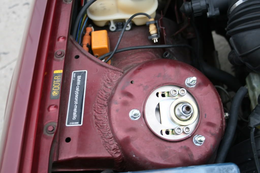

    My current mods include an OBD I s52 conversion and I just finished a 5 lug swap yesterday using e36 m3 coilovers and ti rear trailing arms.
    I am getting an alignment sometime this week. Hopefully they will fix the TOE/CASTER/CAMBER for me.
    Is it nessasary to use e36 m3 control arms???? My mech who helped me with the swaps told me there is no difference in e30 and e36 control arms.

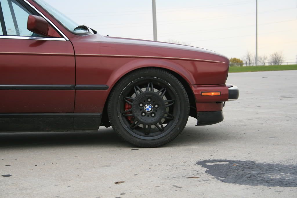

    Notice my front caster is off a bit. Will m3 CA fix this? I have no rubbing on the fenders but they rub the fender lining at full lock.

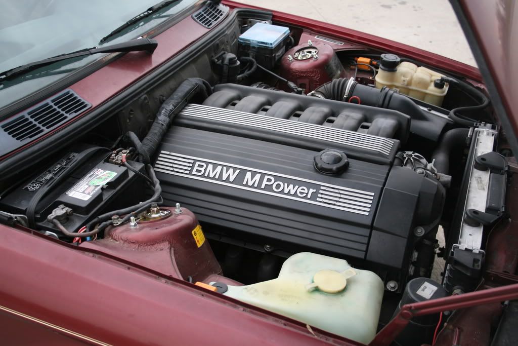

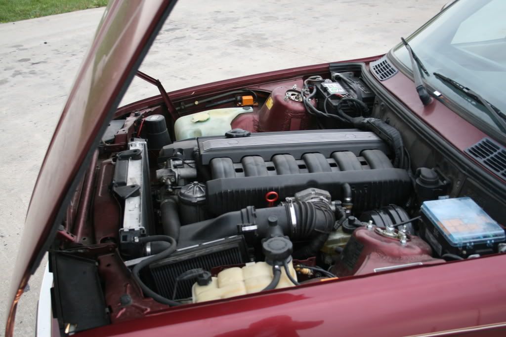

    Here are some pics. I am not done with the engine bay yet. The battery is going in the trunk and I want to get the wiring covered up. What are some options as far as intake goes?
    Stock
    Not so stock
    Some upcoming mods will be a complete interior makeover. New paint. I have a Mtech II body kit that just waiting for paint also.
    Some problems I'm having at the moment are idle jumping. Widows, air, heated seats aren't working. Any ideas on these things would be most helpful.

      96+e36 m3 CA and e30 m3 offset rubber CAB should get you in the right range for your caster problem...

              Thanks guys. I have treehouse racing offset bushings. Wil the M3 CA make the differernce?
