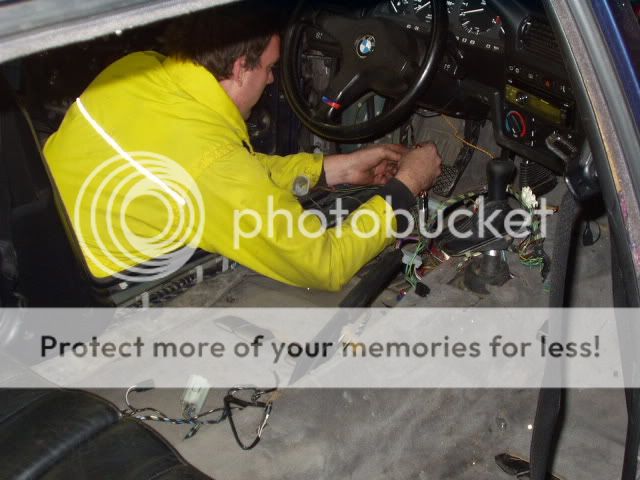

-Took some parts from my parts touring:
comfort wiring harness (for power windows, locks, mirros, etc)
->sitting on BMW tool number 543325 "harness holder"
Setting it under the carpet.... GET UNDER THERE, GRRRRRRR
surprisingly, only 4 wires had to be cut
Took me a few minutes to understand how the door open relay worked (on european cars you can open and close the windows without the keys as long as one door is open)
axel installing the rear portion of the harness (for power trunk/gasdoor lock)
This resulted in:
Operational power locks/Mirrors, and the addition of power windows (changed the door wiring harnesses too) This will later allow me to install rear power windows (a rare option in euro land) I also added the Mtech2 Wheel from my mtech2
