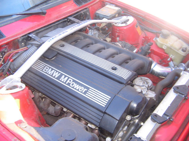

    motor M3 1995
    tranny M3 5 speed
    flywheel UUC stage2
    clucht m5
    Stainless steel clutch lines UUC
    motor mount serie 5
    strut bar racing dynamic
    short shift UUC evo3
    UUC dssr costum
    DIFF 3.73 3clutch race spec diffsonline
    CHIP custom
    tree house conversion m50
    525 oil pan
    E36 radiator
    big six fuel pump
    3 INCH exhaust pipe
    suspension bilstein hd
    coil spring apex
    rear subframe strut bar
    Big rear sway bar (Still don't know the size yet)
    All new brake lines
    New calipers oem
    performance friction pad pf180
    Brand new wheel: Keskin KT1 17x10 and 17x8.5
    35mm spacers
    Tire toyo RA1 255/40/17 and 235/45/17
    TMS solid subframe bushing (Not installed)
    solid diff bushing TMS

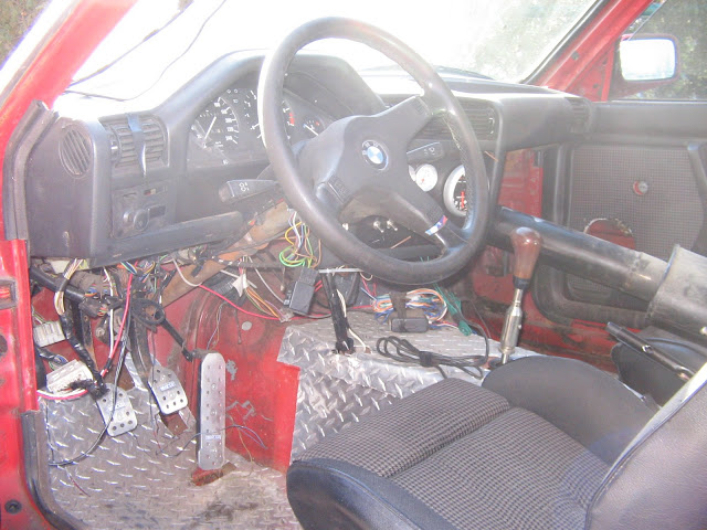

    The car has a lot of problem to fix before it will actually roll...
    Step 1: Get the car waterproof
    - fix the sunroof DONE
    - fix the power window (jammed in opened position) DONE
    - Need a new fuse box FIXED
    - Add some door seels DONE
    Step 2: Get the main electric stuff working
    - Headlight IN PROGRESS
    - trun signal IN PROGRESS
    - windshied washer DONE
    - sunroof CANCELLED
    - windows IN PROGRESS
    - Sort all the wires under the dash IN PROGRESS

    I also don't know In which step the heater and venting system will installed...

                  whats the small circle thing on the left side of the grills. never seen that before.

                            And noE30: the previous owner had fit a little pipe for the intake... Will remove this!
