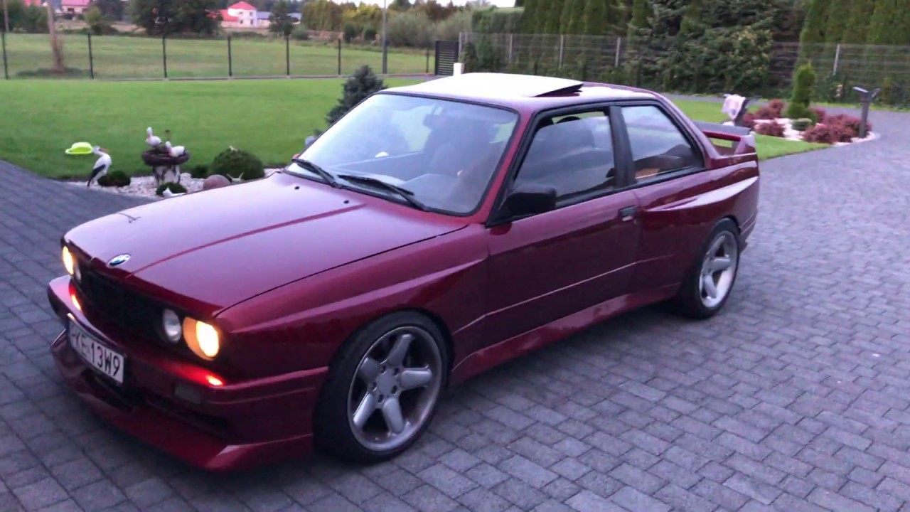

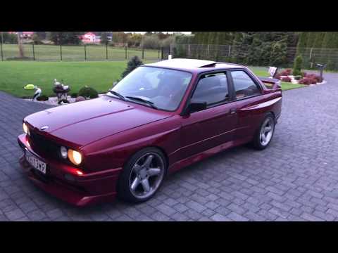

          Ok. Some pics here :)
          • Slaviola
            • Sep 2019
            • 12
            And more...
            • Slaviola
              • Sep 2019
              • 12
              ... and some when it's done :D

                        Here i have i some new pics with new wheels - Apex arc8.
