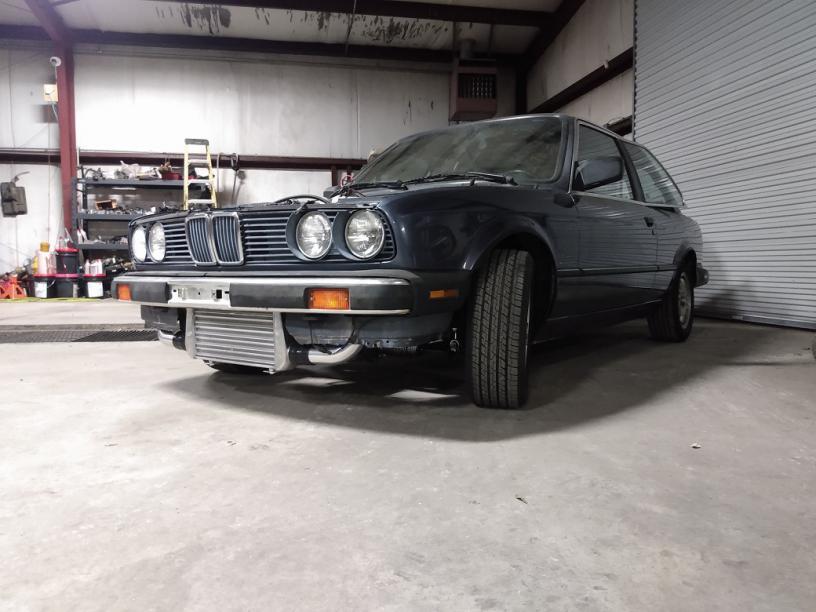

    TJ's 86' 325E Turbo
    ​Its been done before, its been done better. Here is my 1986 325E automatic (for now).
    My family has had two other BMW in the past. 1990 E30 325i Auto which was totaled in an accident and donated some parts to this project. A 1994 325i e36 which is a current yard ornament with blown engine.
    I am a full time line mechanic at an independent shop in Georgia. I have access to shop, tooling, and some experienced drag racers to my assistance.
    This has been a loose cannon project where things have taken several different turns through progress thus far. The endgame goals are just as unknown. While I daydream I see it doing Autocross, I see it launching at the strip, I see it on the skid pad drifting. I see it cruising down the highway. Will it? Should It? Can I? Will I?
    I am starting this thread because I have come to the realization that I wont even be able to keep up with the details of what has taken place along with the future things to still take place. Realizing the forums sometimes disappear I need to organize offline but selfish of me if I don't at least make an attempt to share back to one of many resources which have shared much with me. Over the coming months I will try to develop this thread. I will try to monitor and follow up with serious inquiries, I do encourage general discussion that could be advantageous to my progress.
    Click image for larger version  Name:	IMG_20201206_013301439-25Percent.jpg Views:	24 Size:	64.3 KB ID:	9969908
    EDIT 2/21/21 :
    Parts list
    OEM rod and main bearings STD size
    Beeves piston rings STD size
    ARP main bolts
    ARP rod bolts
    Block OPRV delete plug (m20*1.5 iirc?)
    Oil pump drive gear bearings (roller bearing)
    Oil pump square drive washers/shims
    Elring composite head gasket.
    ARP head studs. studs
    Victor Reinz engine gasket set.
    Elring valve stem seals.
    Unknown origin (eBay) oversized rocker eccentrics
    Bimmerheads new cast (regrind profile) 274/274 camshaft.
    Gates blue racing racing timing belt
    Stainless cylinder oring wire
    New Bosch genuine green giant 42# injectors
    Used m54 ignition coils
    Late model starter (lighter) used.
    Mishimoto all aluminum radiator
    Mishimoto slim fan
    HPS silicone coolant hose kit
    New coolant temp sensor
    Generic cone air filter
    eBay $150 China turbo TD05H-16G
    TurboSmart dual port wastegate actuator.
    ebay aluminum intercooler plumbing kit 2.5in
    ebay BOV generic
    Speeduino early ecu 0.3.7 stand-alone (Arduino)
    AEM WIDEBAND Xseries
    M50 TPS sensor modified to fit late model m20 TB
    Generic gm IAT sensor
    Clone 044 fuel pump (rail pressure)
    Airtex in-tank lift pump to surge tank
    Generic aluminum 2L surge tank
    STD fuel filter
    Garagistic engine and transmission poly mounts.
    z3 quick steering rack LKQ low miles
    Steering shaft knuckle conversion kit
    Lemforder tie rods
    Lemforder control arms
    Solid rubber (no gap) control arm bushings
    Bilstein B6 sport struts and shocks
    Eibachs pro springs front/rear 1.6/1.4 drop
    Godspeed front and rear sway bar set with weld in reinforcement. Plus custom re-re-ere-re-enforcemet
    Lemforder sway bar links front
    New front wheel bearings.
    90' 188mm diff case with e36 LSD unit. 3.15 gear
    Racediffs 3 clutch upgrade
    New trackmotive axels
    New rear wheel bearings
    all new seals and gaskets
    Expensive Castrol LSD diff dope full syn
    Garagistic rear subframe bushings
    Nolathane rear control arm bushings
    Rear weld in camber/toe guides and eccentric bolts
    New rear febi upper shock mounts FAILED - REPLACE WITH Z4 MOOG
    All the available weld in reinforcement available for both subframes and some custom.
    Custom weld swap m20 manifolds front to rear and custom double J up pipe to turbo
    Custom weld 3 in turbo down pipe
    3 in oval exhaust one piece mid section
    3in dual 2.5 out thrush heavy steel muffler
    Raspberry pi4
    HSD123IPW 12.3 in display for cluster
    ​​​​​​To be continued I'm sure I'm forgetting somethings
    Not a great acceleration time, lot of wheel spin and sloppy automatic shift. When u get it right it's 0-60 5.3sec
    I'll post back when I can, between work as a mechanic full-time and family man, this car.... I'm trying. Have fun, be safe and thanks for looking!

            Originally posted by Blake B
            Interested in hearing how that turbo does up top. Should be really responsive.
            It really is. So it starts making boost around 2200rpm. Getting full boost by 3200 all depending on load.
            At highway speeds full boost is on tap all day.
            The 3.15 gear is a bit tall, but it keeps the motor loaded for fast/instant spool for long pulls. I think the 3.46 could be better trade out for touch more acceleration.
            From a dead stop/idle there is some lag there. It's very very reasonable for a turbo car, especially one making major gains.
            Thanks for the interest
