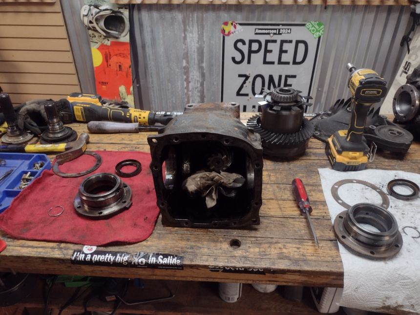

      yikes. i can't imagine what a pain it must be to hunt down another one of those front diffs.
        It's easy when you have a couple on the shelf already in the shop...
          sorry- enthusiast mindset- way to be forward thinking, buddy :)

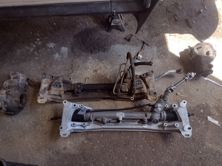

                    Keeping with the theme of "iX OEM parts are really expensive sometimes", the steering rack had been on it's last legs for far too long and is another bespoke iX part and unrealistically expensive to replace. Also it's the worst ratio of any e30 rack, which is really saying something. Since the iX subframe and rack arrangement is completely different than standard rwd e30s, none of the typical rack upgrades are an option. Luckily an outfit called Bavarian Allrad is sort of local to me and basically the only option for a short ratio iX steering rack. He modifies the subframe to accept an e83 (?) X3 rack and the rack itself to clear the oil pan and uses a combination of x3 and e36 tie rods for a bolt in remedy for the terrible stock ratio. It went in without drama, other than necessitating adding an 1/8" spacer to my motor mounts to create a little clearance between the rack and oilpan.
                    Here you can see the fancy steering link included that does away with the crummy rag joint and oem u joint arrangement, sorry for the terrible photo:
                    Click image for larger version  Name:	IMG_20230518_122931_01.jpg Views:	0 Size:	170.2 KB ID:	10107213
                    And old crusty rack and subframe compared to fresh new parts. If you look closely you can see a fist size chunk missing out of the front of the old subframe....been like that for years, still not sure exactly how that happened...

                      I also have this rack fitted; I did the modification of the subframe and rack myself.
                      I was wondering if you could take a picture of the front left CV axle, how much room do you have between the CV and the steering rack?
                      Thanks!
