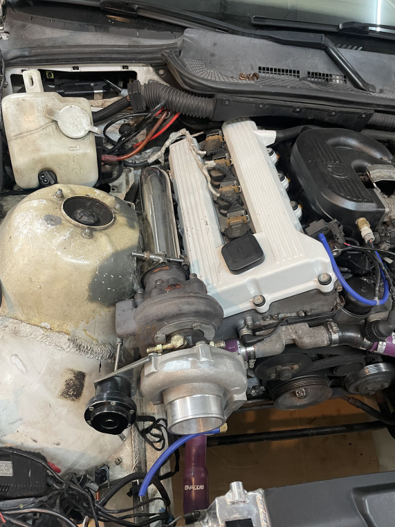

    I've been going back and forth last 4 years trying to boost my daily driver. On long weekends is when most of the fab work happened.
    It all started in 2020 when I was stuck home because of covid and decided to slowly buy my turbo ingredients. So here's what I got:
    • Megasquirt 2 v3.0, assembled by myself. ECU harness adapter made from an 88-pin connector from a junkyard e36 ecu
    • Ebay special gt2871r
    • Ebay special 27 x 7 intercooler with 2.5 inch piping
    • Homemade schedule 10 stainless manifold
    • Homemade 2.5 inch downpipe and exhaust
    Here are some photos that I took:
