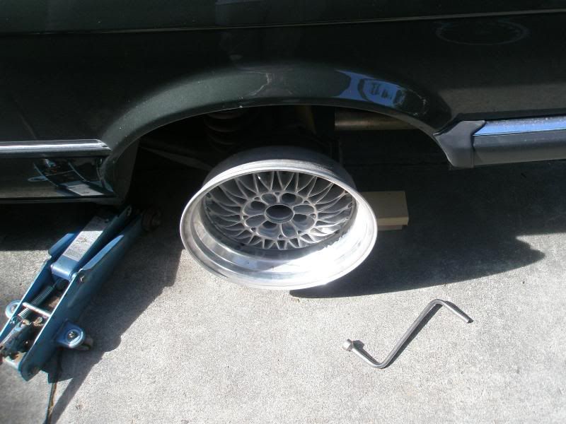

    And HERE are some pics of them mocked up!!
    15x7f
    15x8r
    UPDATE 10:
    06-12-2009
    Just a little update, Threw some bolts in the wheels and mounted them on the car. I currently have almost no money, and I'm looking for a new job, so progress will be slow :(
    I know, I know, it needs a drop. It's coming I swear!! Just need time to install the new springs.
    So Here it is in 4x4 mode, mainly just checking clearances.
    Heaps of clearance for a BBK in the future: :D
    Front strut is a little close, but some 205's should clear with out any problems:
    Compared to the 14x6 Bottle caps:

    Picked them up today and wow! It's nice to see them all bolted together!
    I was also planning on buying new center caps as well, but the ones they had were the wrong size. So I ordered some that should be here in a week or two.
    Lowered the car FINALLY!
    Still needs to settle a little:
