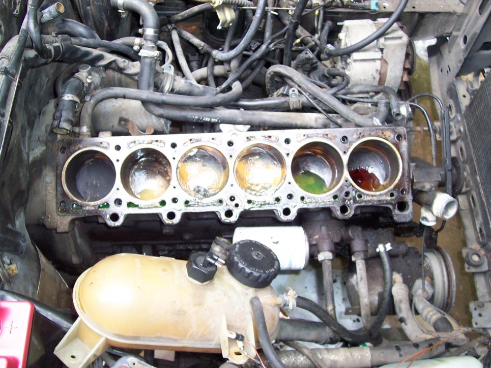

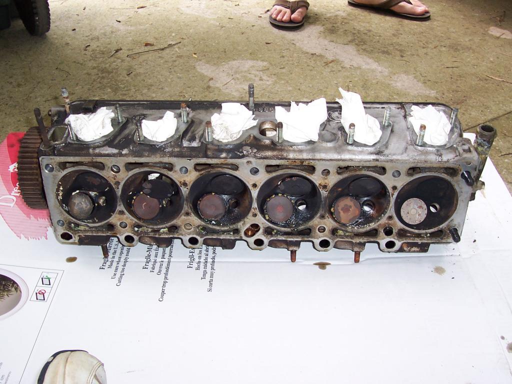

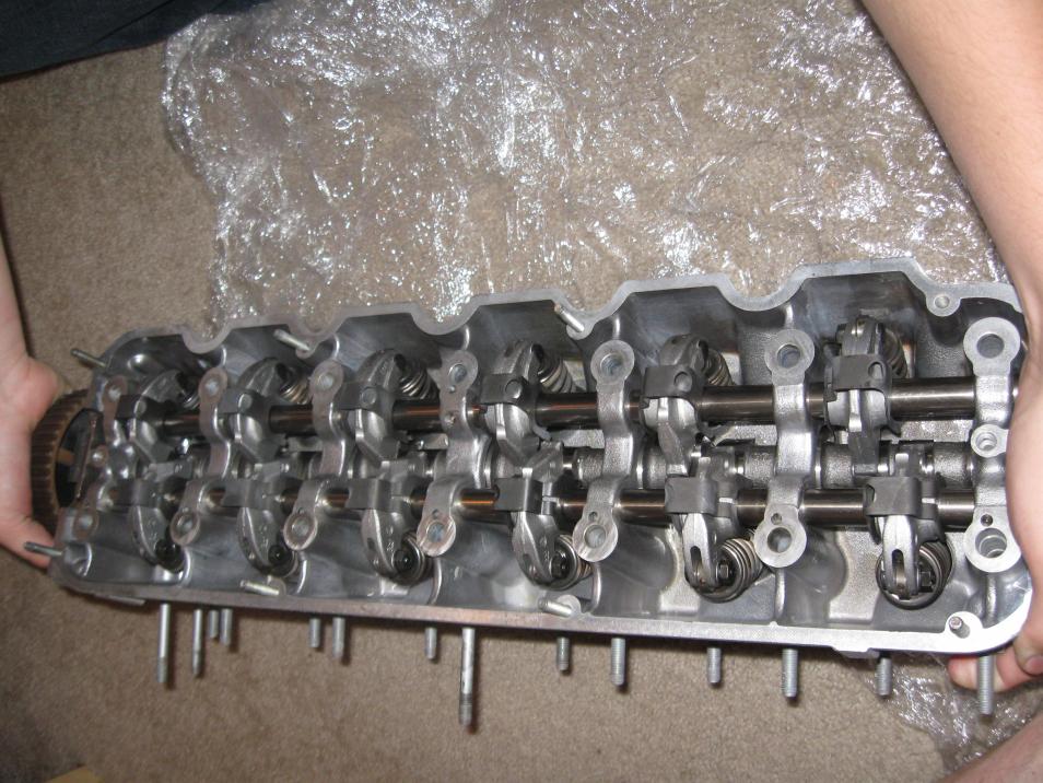

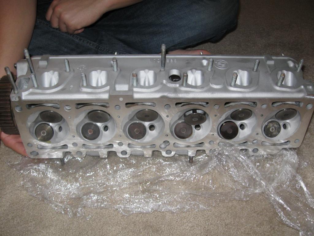

    The head was a complete mess when I took it out but I just got it back today, take a look at the before and after pics.

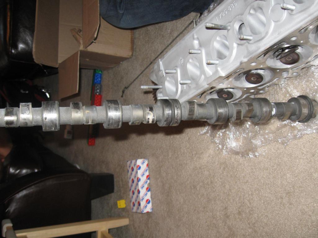

    Some before and after photos along with the old cam. I'm thinking I will turn it into a lamp or something.
      And another one of something else that came in this week...
        Ok, that last one was me on my bro's name. Forgot to logout his screen name, ha ha.
          Like night and day with that head! Looks great!

              Thanks for the info! Yeah the head turned out great, I am very happy with the results. I got it done at Battery and Ignition in Charlotte. It was only about 8 thou warped which was less than I thought it was going to be. My car actually came with a relatively new throttle body, not sure the story on the previous one. The PO was a little vague about what had actually been done to the car but when I mentioned it sounded like the rear end or CV was whining he got real defensive and telling me I didn't know anything about cars etc etc. That kinda worried me a little bit and as it turns out I was right to worry cause the engine had some serious problems that showed up about 600 miles later. Either way, I figured it would need some redoing when I purchased it, I just didn't think it was going to be so soon. I will definitely be in for a new cap and rotor, water pump, timing belt, plugs and some random bits like coolant hoses etc. I will post a detailed breakdown when I get it running again.

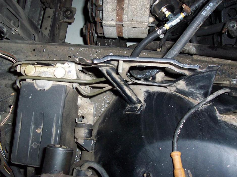

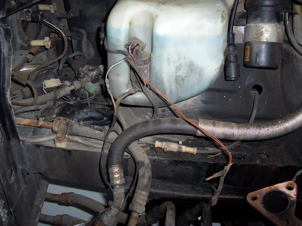

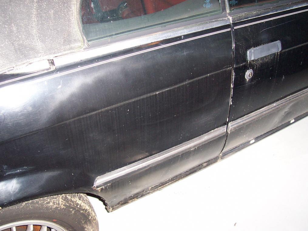

                  Project photos

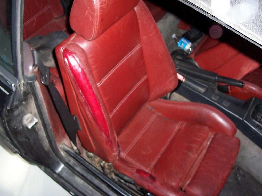

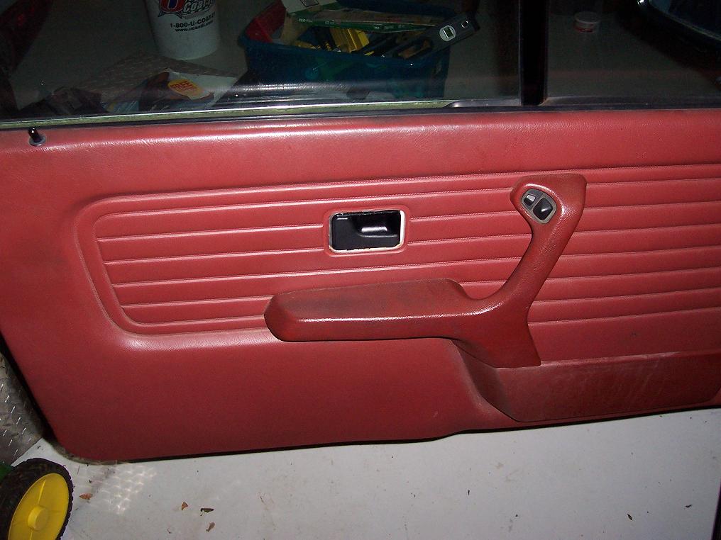

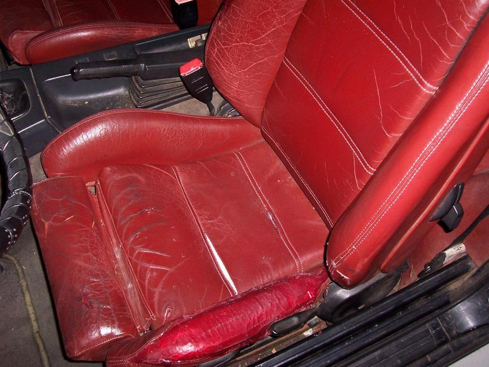

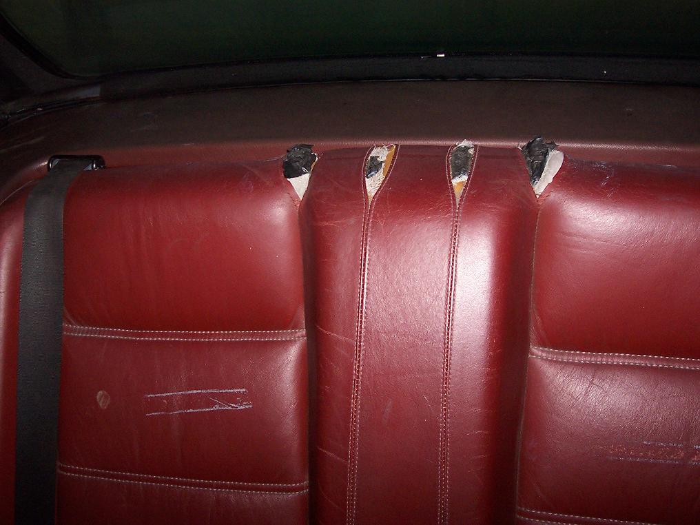

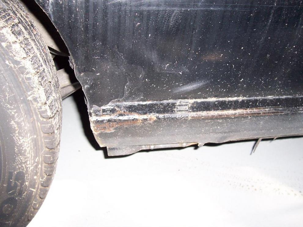

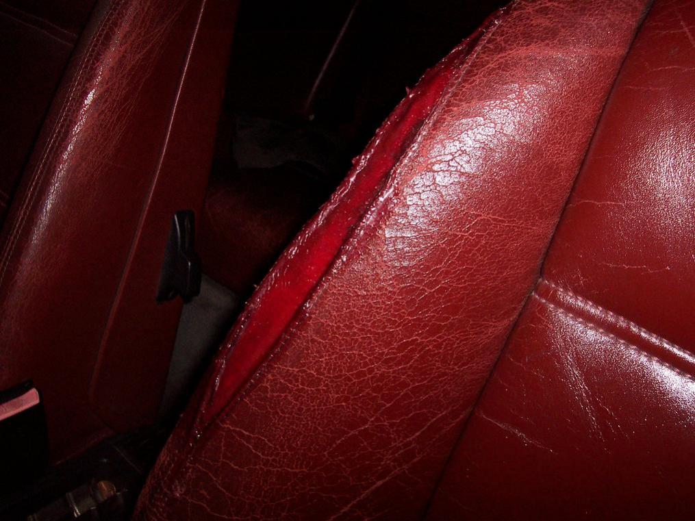

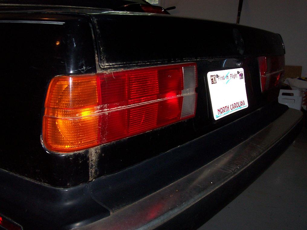

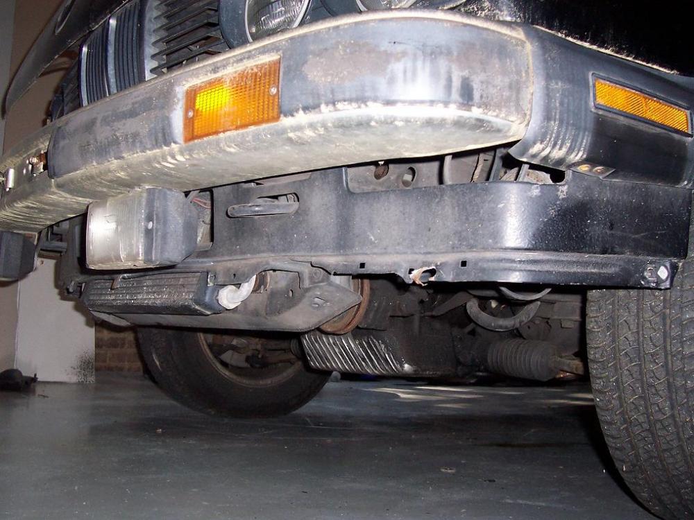

                  Here are a few photos so that you all can see the scope of the project ahead of me.
                    And a few more...

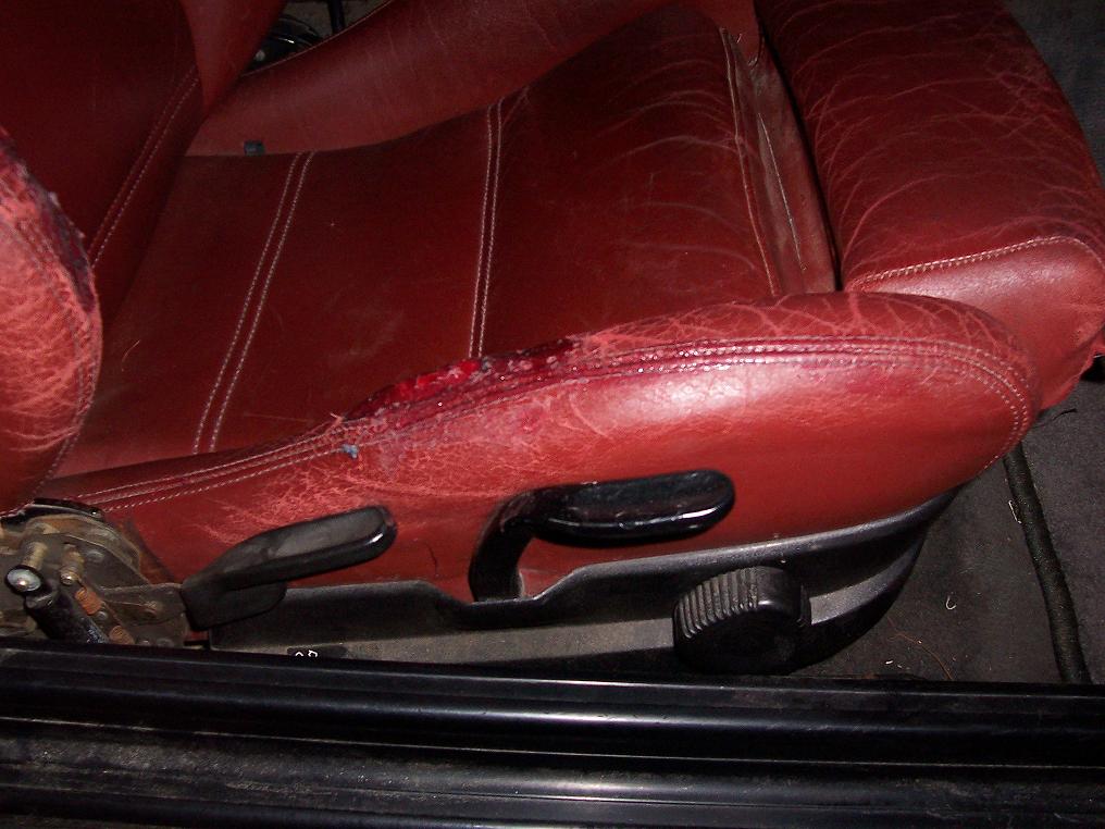

                    The doors are in pretty good shape but the seats are crappy as hell.
                      Last batch...
                      yup
                        Ewwww, your car is dirty. LOL! Pics of the whole car? While I had the head out of mine I went ahead and took a few minutes and cleaned up the engine bay. It doesnt look 'great' but it looks much better than it did when it was towed in my yard.

                              that is one rough vert. Even mine wasnt that bad. You got a hell alot of work cut out for you. I rip the carpet up first pronto and check the floors. Its a vert afterall.
