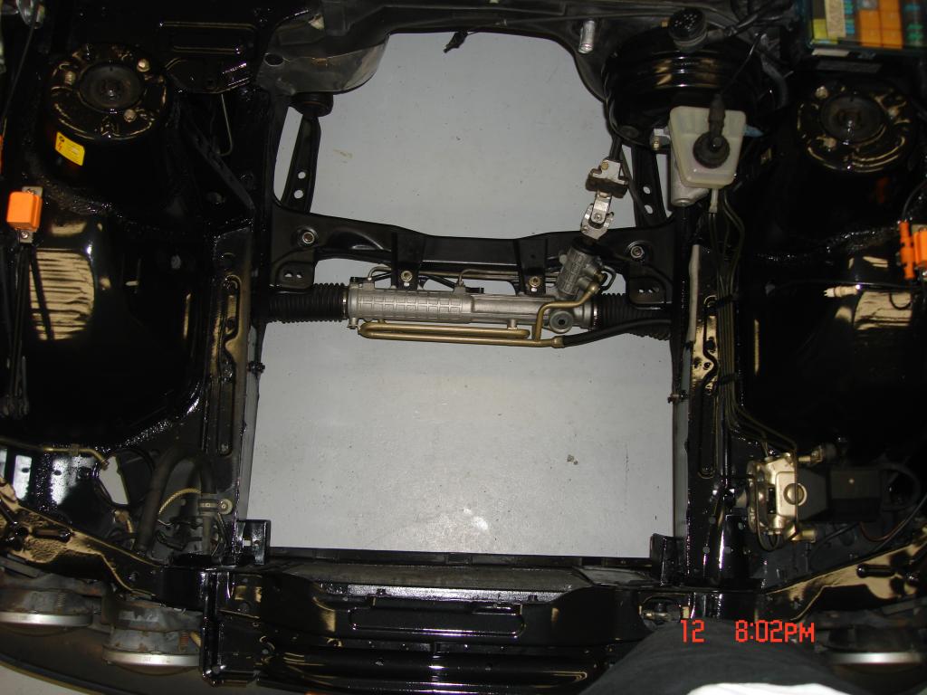

                              since we are both working on the same model and color,here is a shot of my engine bay after painted
