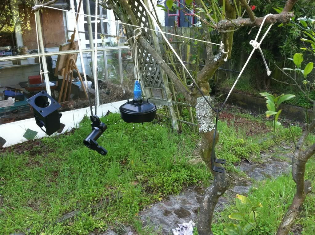

              Ahh the parts tree! With dedication, time and the right aerosol cans, you too can grow your own minty fresh parts!

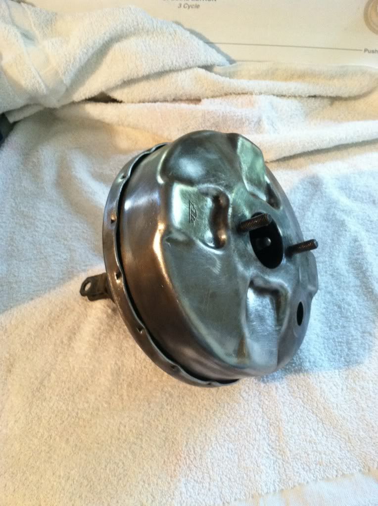

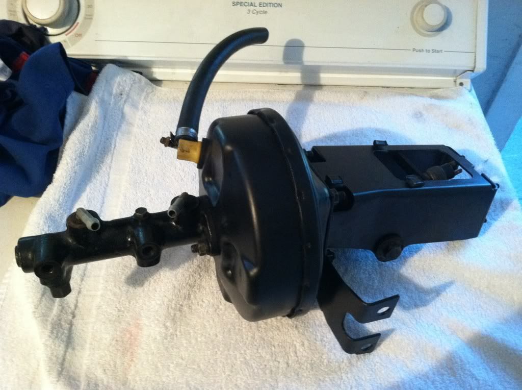

                  Yep. We got the trunk and engine bay painted today. We also got the brake booster bolted back up along with the pedal box, I welded my self some pedals, I cut the stock seat rails out, I cut part of the metal dash under section out to make room for the e30 steering column, I BROKE THE FRONT WINDOW :down: (it was already cracked...), we got the heater box delete in, and we got the the front sub frame back in.
