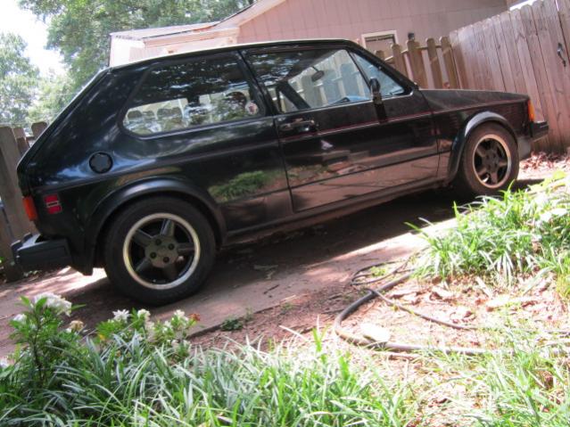

          Holy cow, I never updated this! So it's almost 2 years later and the car is almost done. I have to tidy up a slight oil leak, and buy some tires, and we are pretty much there.
          Lots of pics to follow, so I may break them up.
          So when we got the car it had tons of problems.
          1. The bottom end was shot, the PO had run it with no oil and screwed the crank, bearings, and block.
          2.The interior was a mess, it had a cabrio dash and cluster, and the seats were shot. The back parcel cover had four 6x9 speakers cut into it as well.
          3. the suspension and rubber was all gone. It needed a total overhaul.
          At this point it seemed like a pretty daunting task, but I was up for it. So I started searching for parts and here is what happened.

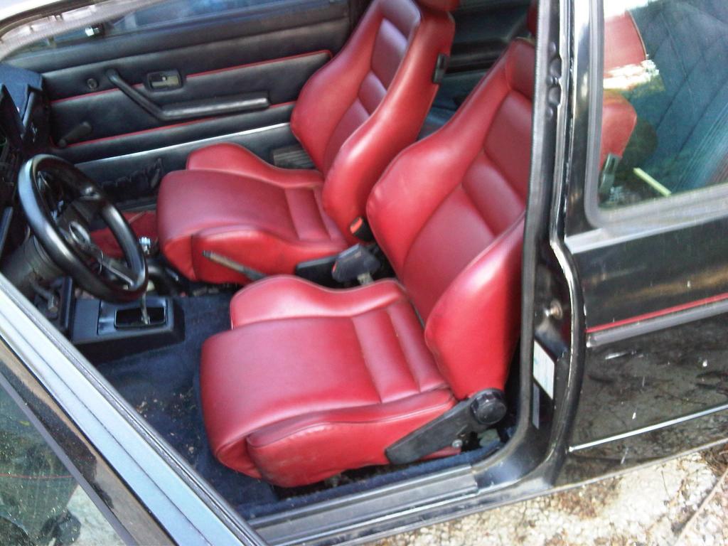

                  I just need seats. I have swapped my black vinyl perf sport seats in for the time being. Not sure what I am going to do with the seats in the future.
                  Re-wiring the car back to the GTI cluster was a total PITA, but it's done now and everything works. I am planning on doing an IPOD only sound system designed by Specdock. That is coming soon. And of course I am looking for the original blue accordian boot for the shifter. GL, I know.

                    Everything was shot. So I sourced all new rubber, and a GC suspension with Billy sports.
                    Car before
                    Car after
                    As far as wheels and tires go, I want a set of widened snowflakes for the back and the OG ones on the front. Those are pretty hard to come by as well.

                          Little bump.
                          Two new things.
                          1. Rims.
                          2. screwed wiring harness :( Oh well. Time for a re-wire....

                            Oh, and for those who are keeping score... I installed a set of seats. At least I can sit in style while I re-wire it.
