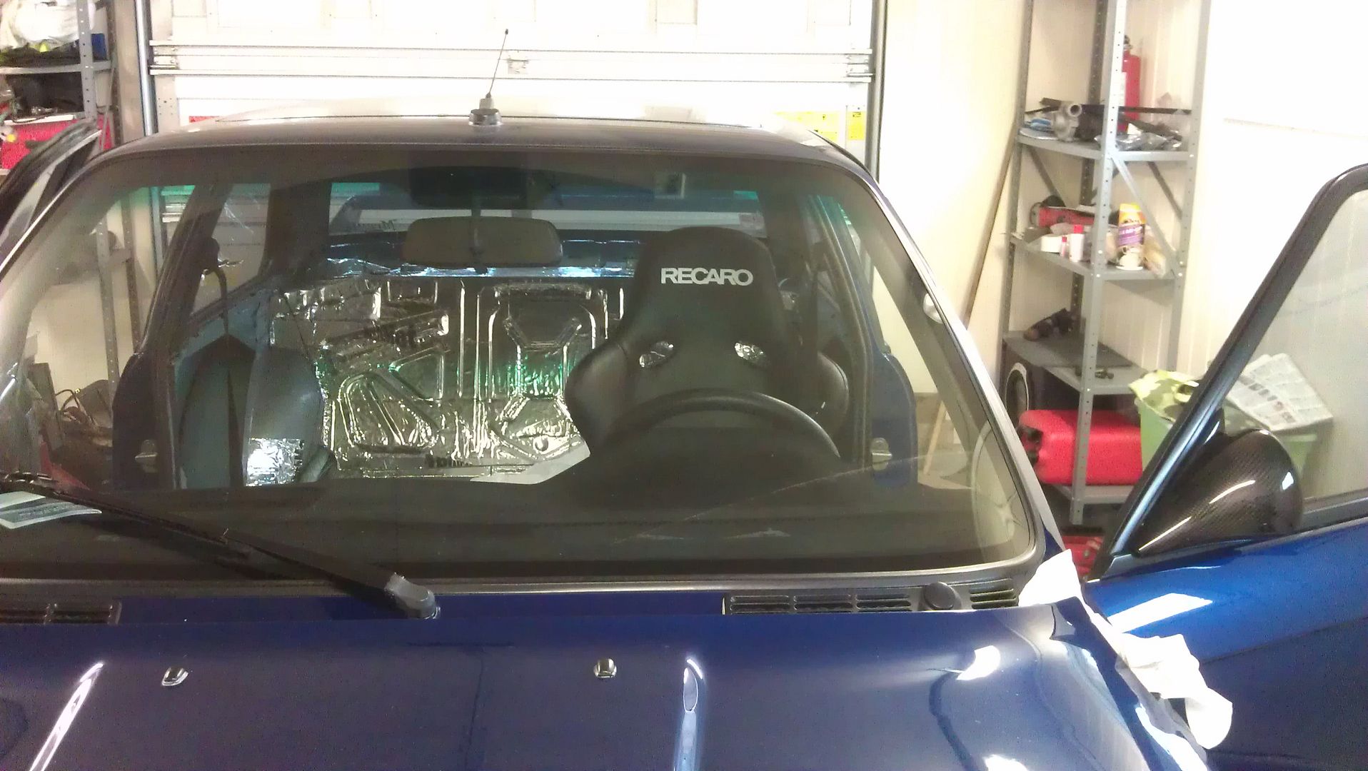

      New seats arrived today FINALLY!! .........in wrong colour. I ordered black black, but this is what showed up. I got some more off the price, so I decided to keep them.
      Because I noticed that the silver (bright gray) is not the type of alcantara I'm after. So if they HAD been in black I would have been dissapointed I think.
      The cushions are fitted with vecrod, and are simple for a upholstry shop to make new.

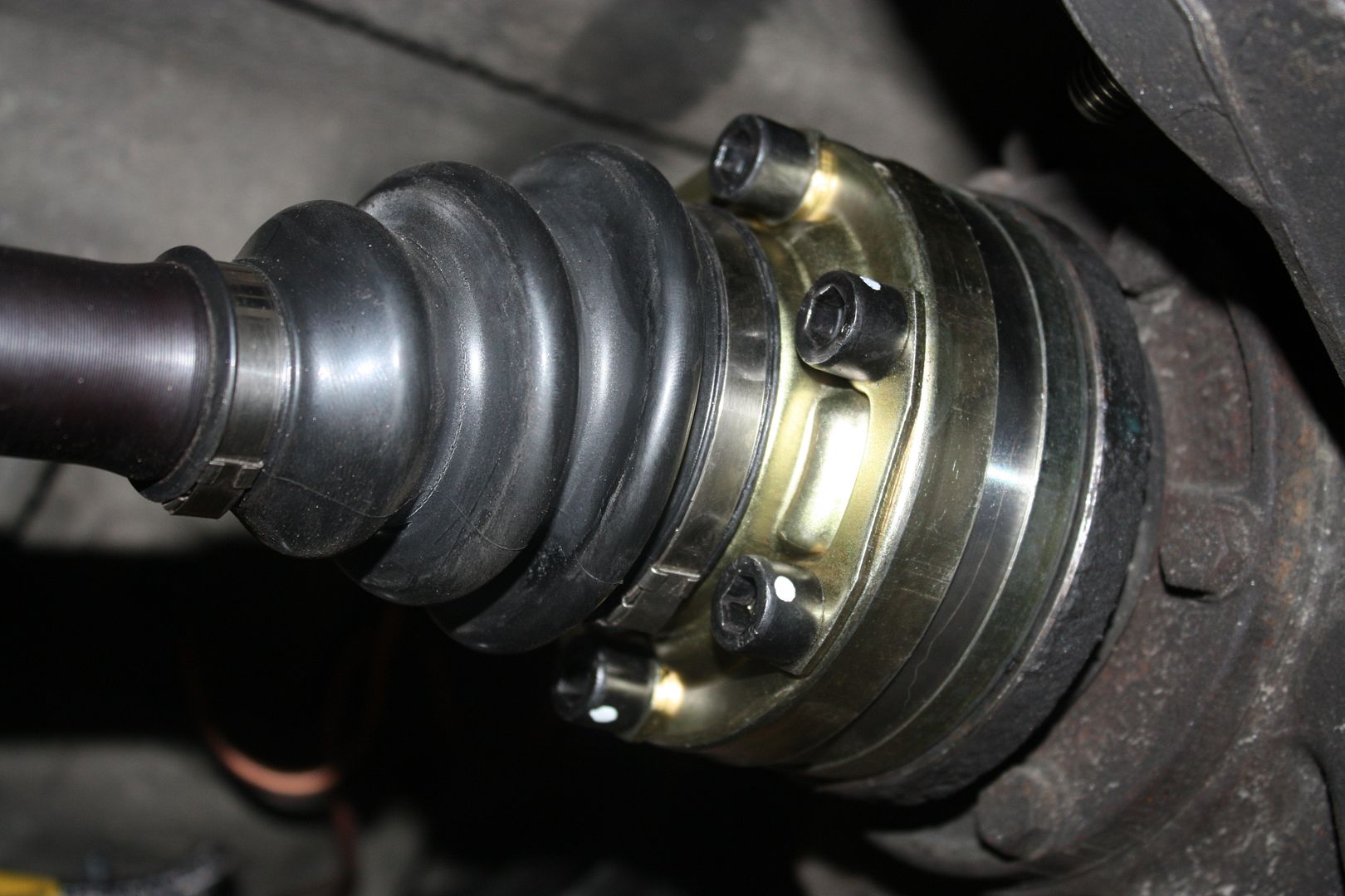

        Overhauled an assambled the E36M3 rear calipers
        Painted the rear hubs to prevent rust
        VANOS was not shiny enough, so it had to be polished
        The rims had lost some shine during the two seasons so they had to be re polished. So I pulled out the bolts and polished the lip and the gold head of the bolts.
        Welded the camber and toe rear kit onto the subframe and primed it
        Fitted the new aluminum radiator
        And fitted the rest of the Hushmat and the hydraulic e-brake setup

                Low interest in my project?
                While I'm waiting on the carbon fiber that is supposed to be inside the car, I have made some quick solutions to make it look more ok while I wait.
                The stock damping mat that is behind the rear seat I glued on some alcantara.
                Since the carbon fiber plates are flat, and some of the steel will be viewable I painted some blue inside the car.
                The stock c-pillar trim was not nice any more, so these got some alcantara as well
                Made some door cards of sound deadening mats, these are also now in alcantara fabric.
                The car is complete for now, just waiting on the carbon fiber for the inside.
