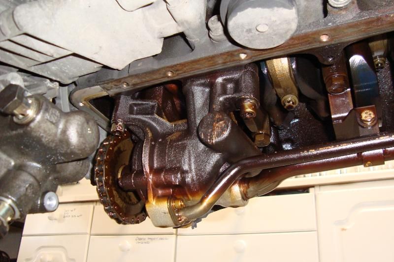

    Now its for me to get the oil pan off and send it to welding. While I wait for that the engine will get a real makeover with a wash and some paint for the valve cover.

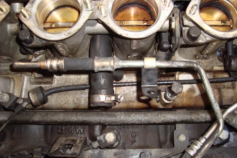

          Well, there is progress in the shop. Oilpan has now been washed in a industrial washing machine and is clean and ready for welding.
          I have spendt some time to clean dirt from the engine, witch is a lot! I have ordered a lot of parts. M20 motor mounts, e34 m5 3.6l tranny mounts, gaskets, o-rings and some gear shift parts.
          The throttle bodies had to come off and have now been a trip into a media blast chamber.

            What are you doing to the oil pan that needs welding? Just use an E34 M50 pan and dipstick, it must be cheaper to go that route.

                        Welding the oil pan?

                          Lookin good. Also interested in what your doing to the oilpan. For keeping the semi-dry sump i assume. Its going to be a tight fit.

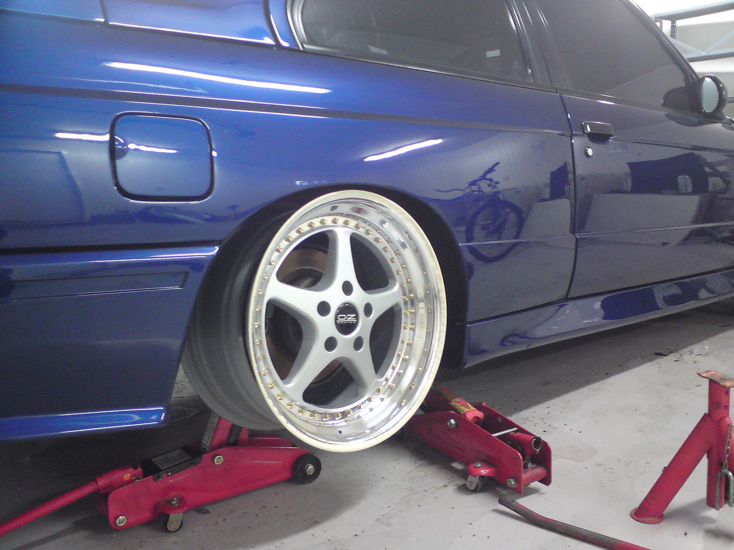

                              Oh yes, there are som OZ's that have gotten the nose on the pictures. I have now gotten some tires on them and her you have some shots of the wheels and engine.

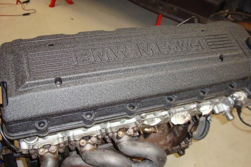

                              Cleaned and polished the VANOS for 5 hours
                              A/C block off. TIG welded and helium leak tested.
                              Media blasted
                              Valve cover got painted with wrinkle paint, other black parts with BBQ and stove spray and the other "silver" with clear coat for bare metal parts.
